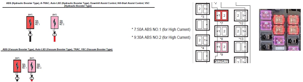

    Where is the abs fuse located?
    I had a small accident that bent my steering knuckle, since then I haven’t been able to get my stability control light off. The abs light came on after I replaced the part and got a alignment. I replaced the sensor and the harness and still the light hasn’t gone away. I have unplugged the battery and tried to reset it too. Toyota dealer was the one that did the alignment and they couldn’t get the lights off. They recommended replacing the sensor. I did that. Now what? I figured I should check the fuse then go from there. Please help! Stability control has helped me retain traction in certain wet conditions. 2017 sr5.

    Pinched wire, maybe

    Hood Struts, My version Fogs always ON, Map & Overhead Light Mod,

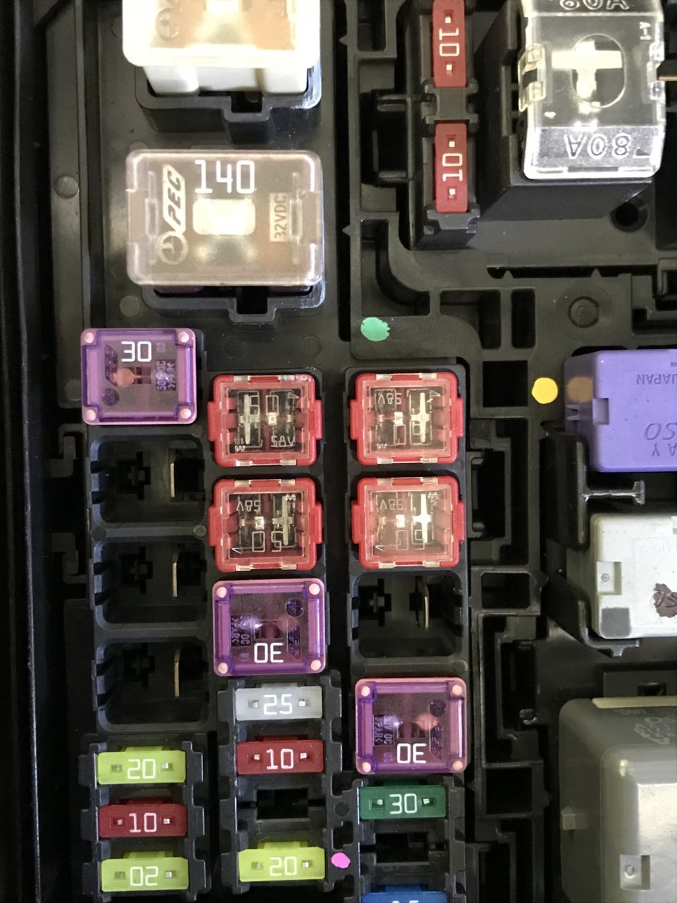

    Fuse looks intact.. now what? I don’t know what to do from here. I have changed the harness and the sensor already.
