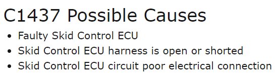

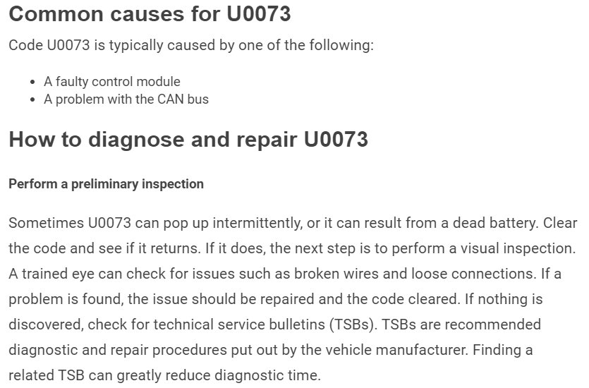

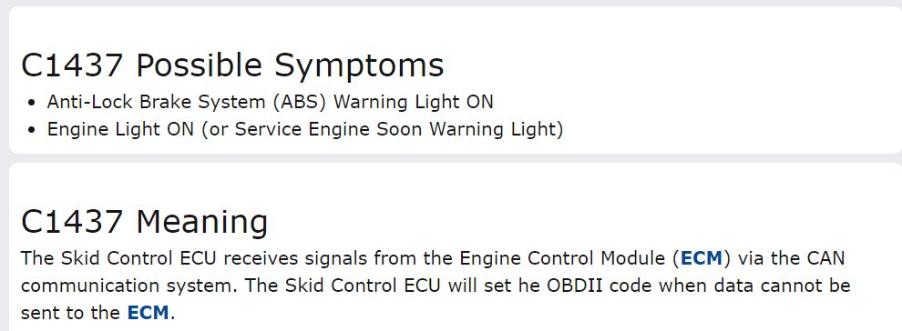

    Was able to have a mechanic friend of mine scan.....
    Trouble codes:
    U0073
    C1437
    All wheel speed sensors looked in perfect working order during the live scan during the test drive. Plus I have repeatedly visually inspected the wheel speed sensor harnesses and none of them are even close to being under tension.
    I am wondering if the U0073 code popped up when I recently had a new battery installed.
