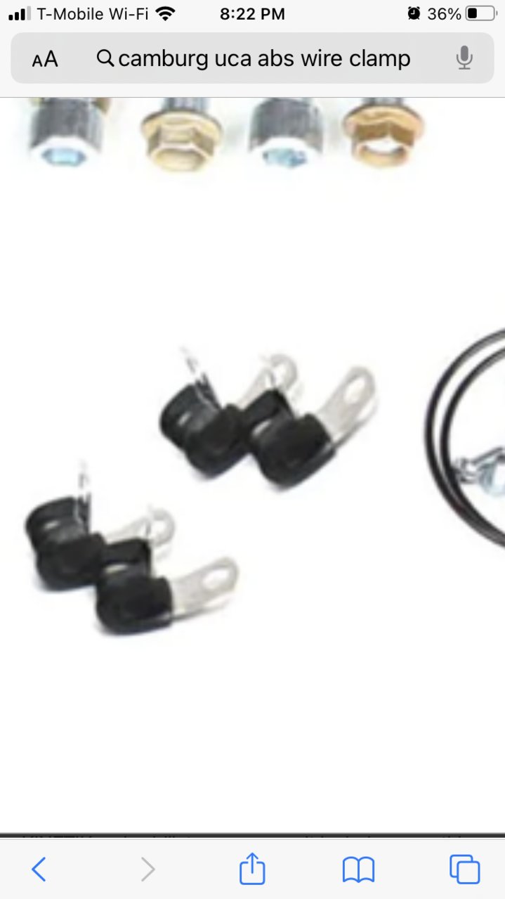

    I have Camburg UCAs and they come with these little clamps. They work perfect.

    For the OP, here is an Amazon link to those hose clamps. You can get them in various sizes to match the UCA arm diameter.
    Solarson 52pcs Cable Clamps Assortment Kit, 304 Stainless Steel Rubber Cushion P clamps,Pipe Adel Clamps in 6 Sizes 1/4" 5/16" 3/8" 1/2" 5/8" 3/4" https://www.amazon.com/dp/B089M25CDP

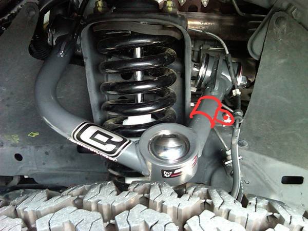

    Thanks. I have ysed those before for wiring. Don't they need to attach to a stud though? A lot of the tubular arms do not have the stud

    I think you have the idea backwards. The hose clamp goes around the UCA tube. The ABS bracket, then bolts to the hose clamp tabs. Or remove the ABS bracket, and then use 2 different size hose clamps.
