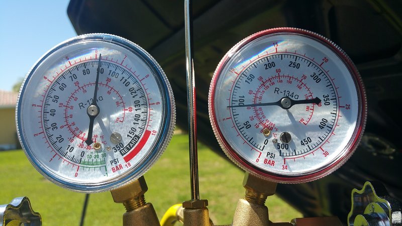

    Problem with AC. The clutch fell apart. Just want to make sure this is correct pressures for the AC when not running. Has not worked in a few years and have moved to Florida, so I am hoping to get it working again.
    Bought a clutch but getting the piece opposite the magnet, the thin disk, onto the shaft is proving difficult.

    All you can really tell when the AC is off is that there is refrigerant in the system. Can't tell if it's full unless it's running. Also, what is the ambient temp?

    Notice how the low side gauge needle crosses over the red temp mark, right at 80F? That means you have enough refrigerant to have at least some saturated refrigerant. It doesn't mean that the system is full. It does tell that you don't have a big leak, otherwise there would be no pressure. Get your clutch together and see what the gauges say, after running for a few minutes with the fan on hi and recirc. And note the ambient temp at that time.
