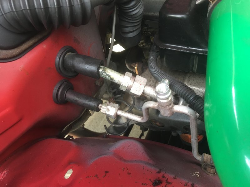

    hey everyone. I've almost got my 750 buck Tacoma road ready. Only thing I need now is a new compressor..... I think. I can turn the switch for ac on and I don't hear it clicking over. Wiring looks good. Are there any other models that will cross over the compressor. I found a 97 4Runner 6cyl compressor for sale on the craigslist for 50 bucks. Would it work on my 97 2.7 Tacoma

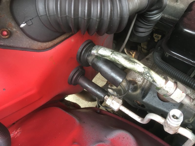

    Yup. I found the problem, it's not the compressor. I jumped the compressor and it turned on. I figured since they rebuilt it they may not have charged it. I went to the charging port, and heard it sucking. Pulled on the hose/tube and it came out. Wtf. Freon was being sent directly into the cab of the truck. My question is, where does this hose go and what needs replacing? Heater core? The heat works. Also What color is freon? Green slimy oily

    Okay never mind, I re read what I wrote, I know it's not heater core, but where do those lines go into firewall so I know what to replace

    Yeah, those lines should attach to the evaporator. Never worked on one of those.
    I'm thinking that line you pulled out had been cut by the previous owner inside the cab.
    Don't know that color freon (R134) is. I do know that the system contains a lubricant for the compressor, but not certain if it is in the 'freon' or in the compressor itself, or both.

    the green you are seeing is a "dye" that is put in with the oil and Freon to check for leaks with a uv light after charging with Freon or for future testing, that is your evaporator core that is broke. time to pull it.

    It's gonna be that there is no core, or there is a core and the lines were cut. I assume since I'm going that far into it I might as well replace it even if it is just lines

    You're going to need an evap (my bet), expansion valve and accumulator at the least.
    The system should be flushed, as you have no clue how long it's been open or what may have contaminated it.
    Once the flush is done, the proper oil amount needs to be added.
    Then button it up and put a vaccum on it. It should come down to about -29" pretty quick. Leave it connected over night. Same reading in the AM shows you have no leaks, and it's ready to charge.
