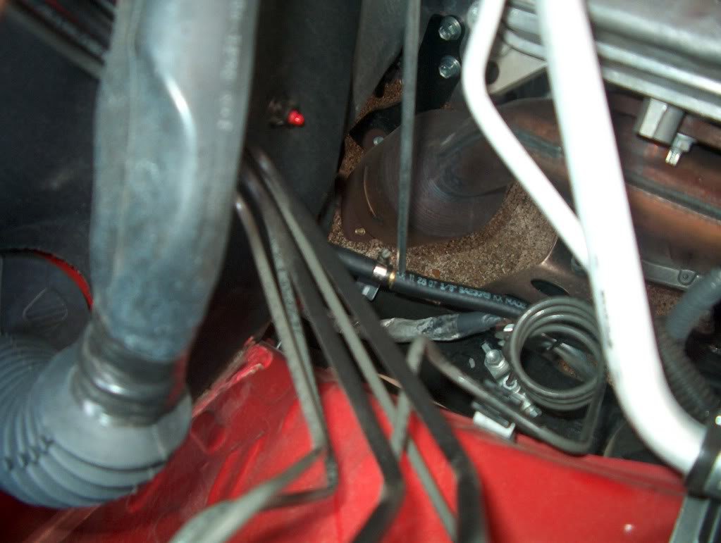

    This was one of my first mods.
    Screwdriver is on the drain extension.
    This pic shows where it goes.
