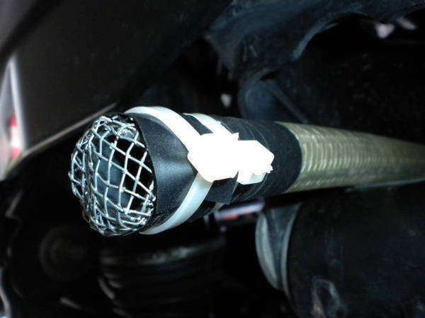

    I found a section of garden hose that was a perfect fit and used a hose clamp to secure...
    where it drains out under the truck i used wire mesh to keep critters out...

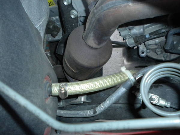

    The hose from the truck is 5/8. I did not have any luck connecting to it since it is so thin and soft. You cant clamp on it. I used a 3/4 heater hose and tied it to the frame holes, then put the 5/8 inside it. Did this last year and it still works perfect.

    The method I used was a 3 foot length of 3/8 fuel line. Almost the same inner diameter as the hose coming from the truck, I used a 2 inch length of copper wrapped in stainless pipe so that I could clamp down on the hoses, then used some normal sized zip ties to secure it to the frame holes in the fender well , then used a massive zip tie around the frame to lightly secure the hose to the side of the frame to keep it away from the exhaust, then used another hose clamp and zip tie to secure it to the metal portion of the passenger size Y pipe exhaust hanger, so far its workin good *knock on wood* lol :)

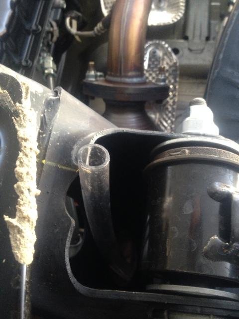

    I hate this friggin' web site ... I see things and think "I can/gonna/wanna do that." Sooooo ... having said that I did this today ... 5/8" id tubing ... tie wrapped to cable directly below it ... ran it to the cross member ... in through a top hole ... feed it to I believe the middle lower hole on the aforementioned cross member ... left approximately 1.27" sticking out ... no, I do not have photos and/or a writeup ... just skinned knuckles and scraped wrists and forearms.

    Here's what I did. I just inserted some tubing into the drain hose, securing it with a hose clamp, and ran it down to the side of the frame rail. It no longer drips on anything.

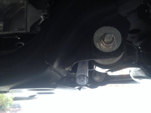

    I found some plastic tubing used for drip irrigation in the yard, and the ID is 5/8", which was perfect for slipping over the tubing coming out of the firewall, pretty snugly. I ran that down through the cross member and out next to where the lower control arm frame mount is. I then used zip ties to secure the tubing, one around and through the cross member, and one on the bracket where the wiring is attached just below where the tubing exits the firewall. It seems very secure.

    I ran mine through the existing holes on the pass-side, lCA mount. There is zero heat exposure from a hot exhaust or anything for it to get cought on either. I also didn't use any kind of zip tie or tie down, it just hangs there and works perfectly.

    That's the exact place I ran mine out, also, it just seemed obvious to use that. I simply used zip ties to secure the tubing in case a bump or something might jar it loose.
