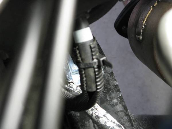

    Not much room on my 2015 TRD Sport - 4.0L, to reach the AC drain hose. Since there was no way for me to put two hands on the drain hose, the drain extension needed to be installed "one handed". I used a piece of split vinyl tubing. It was easy to slip on the short drain tube and zip tie to secure. (remember to orient the split in the tubing "up") It works just fine and was a relatively EZ mod.[​IMG]

    The OEM drain hose.
    Thanks. Will try that. My baby is currently getting new brakes and u-joints. Surprise Monday morning car repairs, always entertaining.
