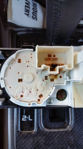

    Here is the problem. The wires running into the back of the controls are so hot it's actually melting the plastic under my dash. I thought the controls were bad so I replaced them with another set out of an 09. The AC works but you have to put it on hot to get cold, cold does hot. Not a big deal but the wires after 2 minutes of running were so hot you could barley touch them. The back of the control panel is also extremely hot. There is actually parts of my dash behind the controls that are melted from the wires touching it.

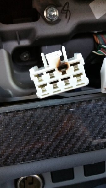

    There is burn damage to the plug and the two wires that get hot are the white ones only. White/black strip and white/blue strip. The pic is bad but you can see how discolored the wires are from it getting hot.

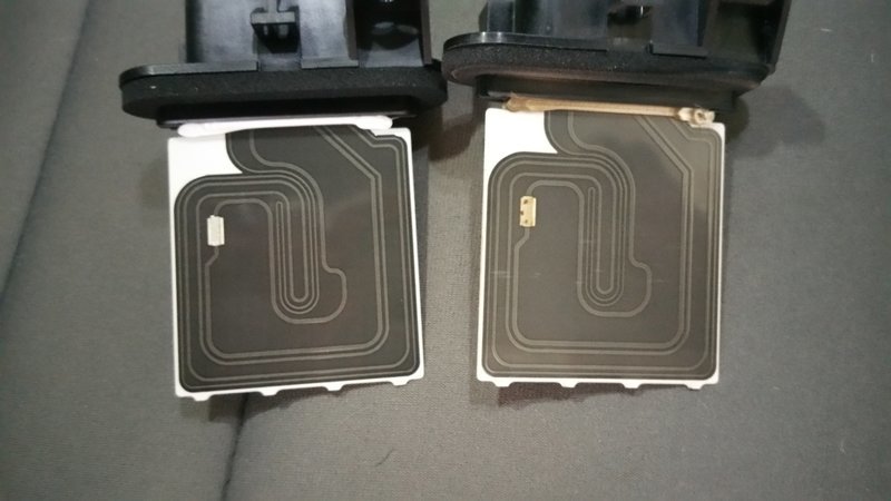

    First thought is the Blower Motor itself. On other vehicles, the resistor going out is usually caused by the blower motor going out.
    Aw9d[OP] likes this.

    See the second picture above. The burned area at the terminal clip inside of the connector. It is loose fitting onto the terminal in the AC Controller. This looseness is acting like a heater. All a heater element is wire with resistance. So when the clip is loose onto the terminal it adds resistance to current flow and heating.
    What you need is a new connector that has tight fitting terminal clips. If you don't it will continue to burn. Note: I am an electronics tech and work with these automotive connectors every day.

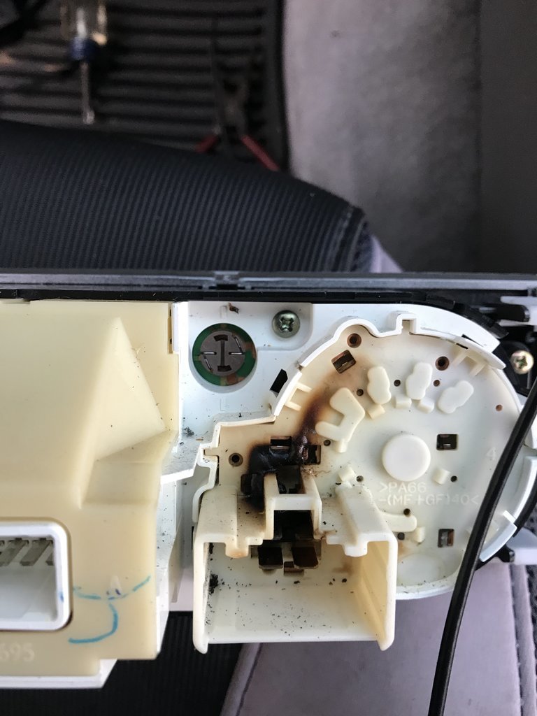

    my ac connector on my 2013 is burnt too. and now the ac doesnt work on the high setting. this is something i should prob take care of

    What is the part number for the electrical connector that snaps into the back of the heater control? Mine is melted as well as my heater control. Heater control is on order but cant find the plug in the Toyota parts diagrams. Thanks

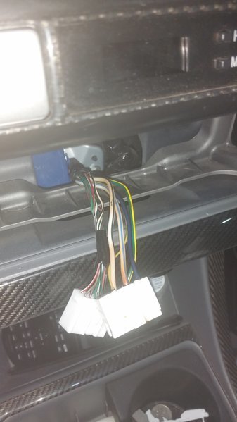

    There is no part number unfortunately. You'll have to buy a new climate control and then cut the parts of the wires that are toast and make your own harness. I got lucky and found someone with a totaled tacoma and I ended up cutting their harness off and used that one. When I contacted Toyota about it they said I have to buy the entire wiring harness to replace that one clip.
    What I've done to fix a few other people's that melted was use connectors and just slide the cables on one by one to the new climate control. Make sure they are tight or you can go as far as solder them to the climate control directly. I'll use quick disconnect butt connectors for each wire in case they need to remove the climate control later.
