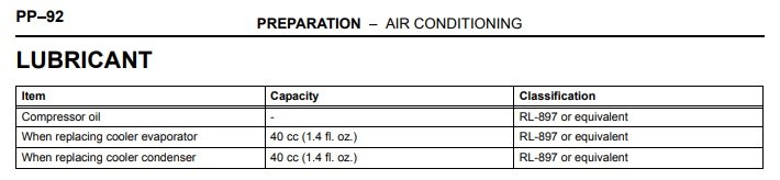

    Service info says add 1.4oz of oil to the system when replacing evaporator, there's no need to put a full system charge of oil in unless replacing/flushing all components.
    Yes the refrigerant should be recovered before opening the system, there is no proper way to do it without an A/C machine. You will also need to pull a vacuum on the system before recharging it when you are done.

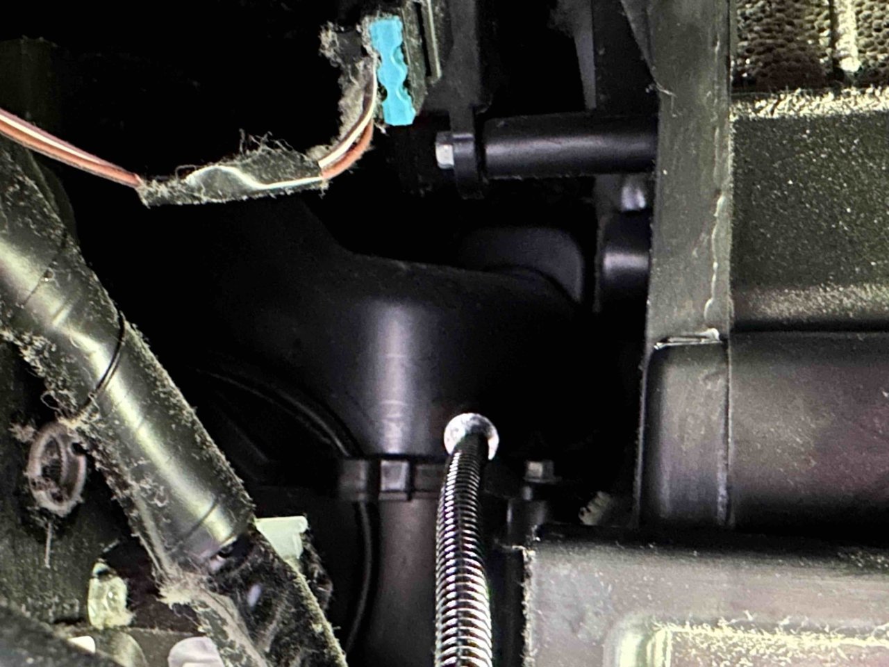

    I just ran the detector through the glove box. Goes crazy right behind the air filter box as you can see from the picture. So expansion valve or evaporator?
