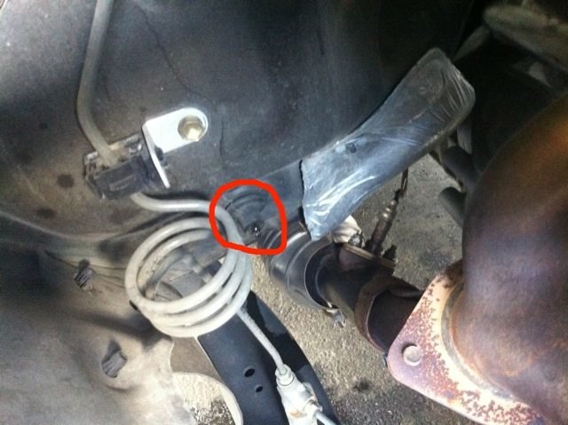

    The water is probably due to a plugged up drain tube for the condensation from the AC.

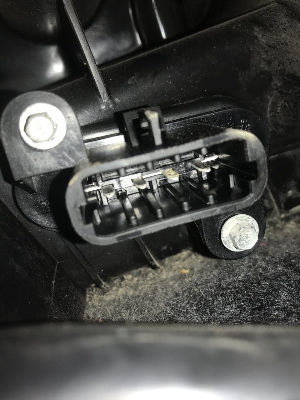

    The fan not blowing is probably due to the blower resistor and connector overheating issue.

    You may also have a burned resistor connector and may need these:
    Plug Number 82141-04M40
    Resistor Number 87138-04052

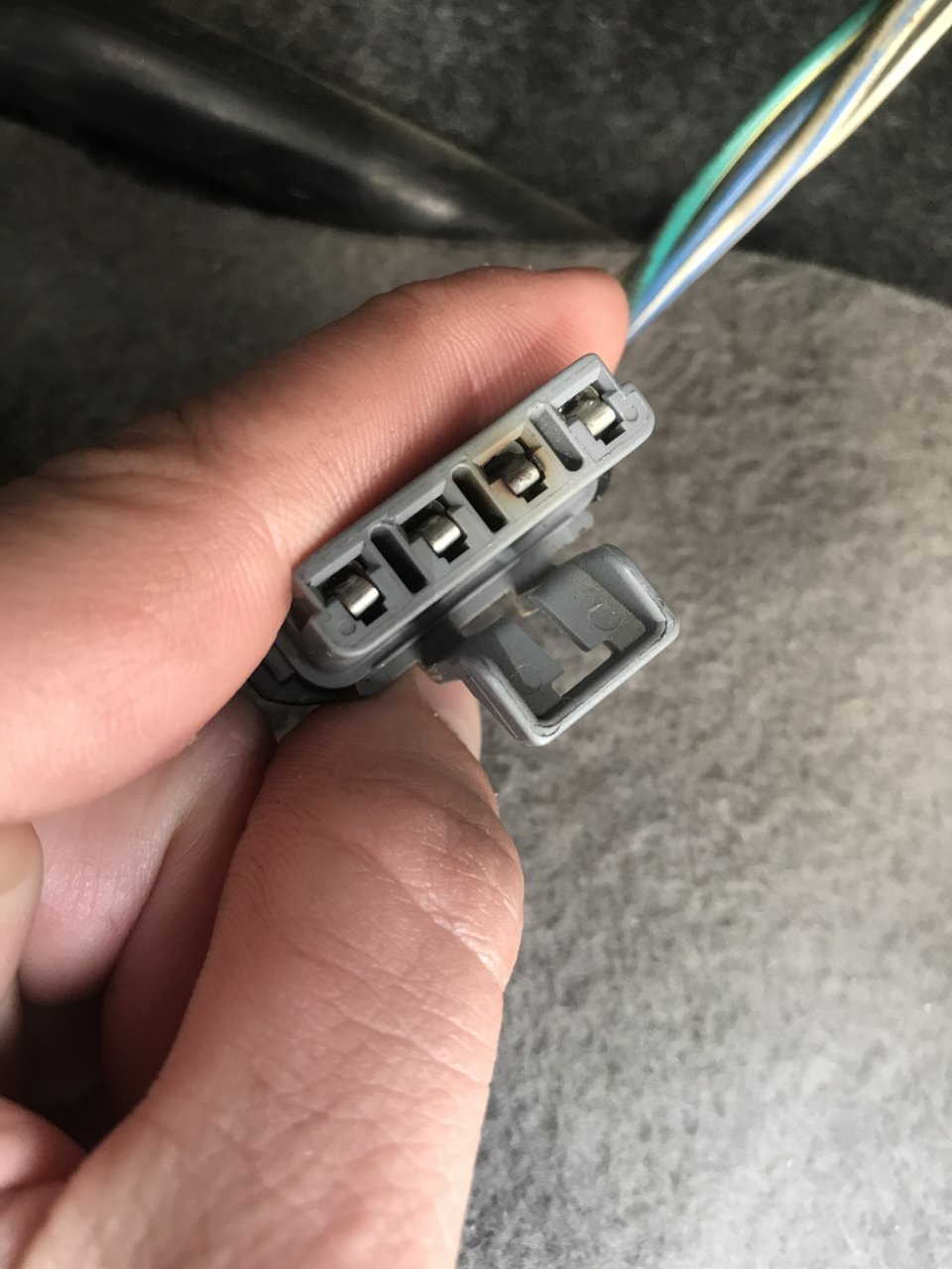

    Undo the plugs to both the blower motor and blower motor resistor, check for any melted parts or burnt contact points. This just happened to a buddy of mine. First it was his resistor about a year ago, now the plug to the blower motor melted. Had to the replace the plug and two wires, just cut and spliced them.

    How interesting is this? Unplugged the resistor plug, and the 3rd slot is brown of course. This let the fan blow on max only, which was expected. When I plugged it back in, it could blow on all speeds. I'll keep an eye on it.
    Thank you @Jimmyh for the pictures and part numbers! I located the AC box drain hose. I didn't tug on it too hard, I have bad luck ripping old rubber bits like this. I'm going to research the best way to clean this.
    The passenger carpet dried out pretty well today. Removing the floor mat and keeping the windows cracked on this hot day helped a lot.
    Going to clean out the drain hose and keep an eye on these issues. Thanks everyone.

    Get a can of compressed air and blow up into the drain hose.

    And if you can, try and clean the terminal that’s brownish with sand paper or something. And keep a close on that blower motor plug as well...my buddies melted and smoked up real bad.
