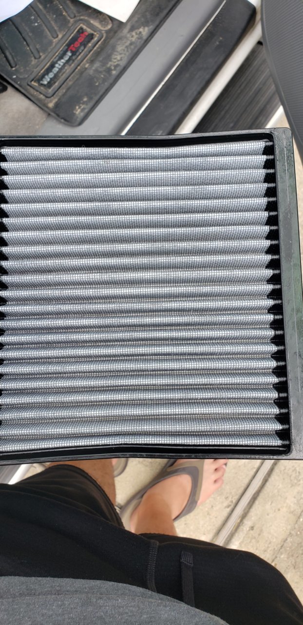

    I ordered the resistor just to replace it anyways. 10 year old truck won't hurt as I have had THAT issue as well. Did change out my cabin filter as it was pretty dirty. Got a fancy washable K&N. There were a few leaves stuck in the motor fan thingy. I didn't see any other harness that looked burnt out in there. I need to go back in this weekend and thoroughly take each harness/connector out and recheck again.
