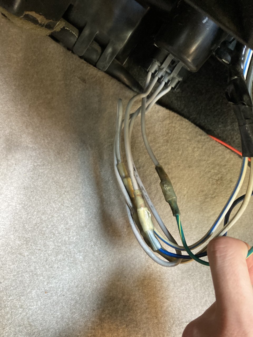

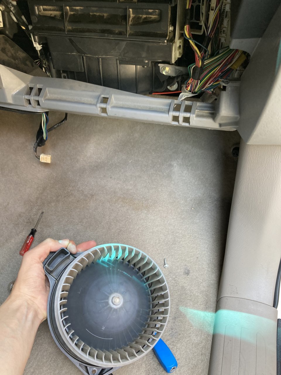

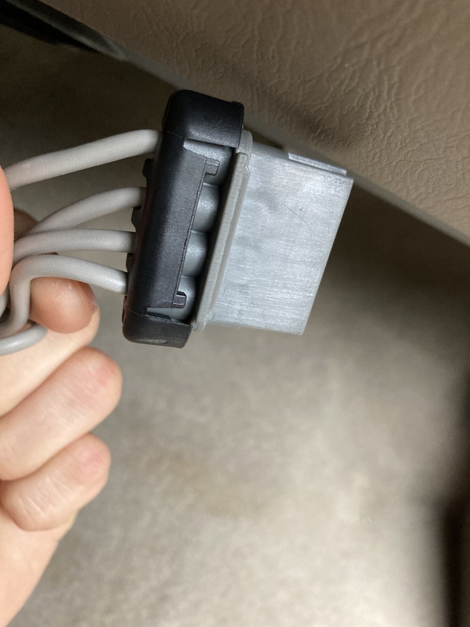

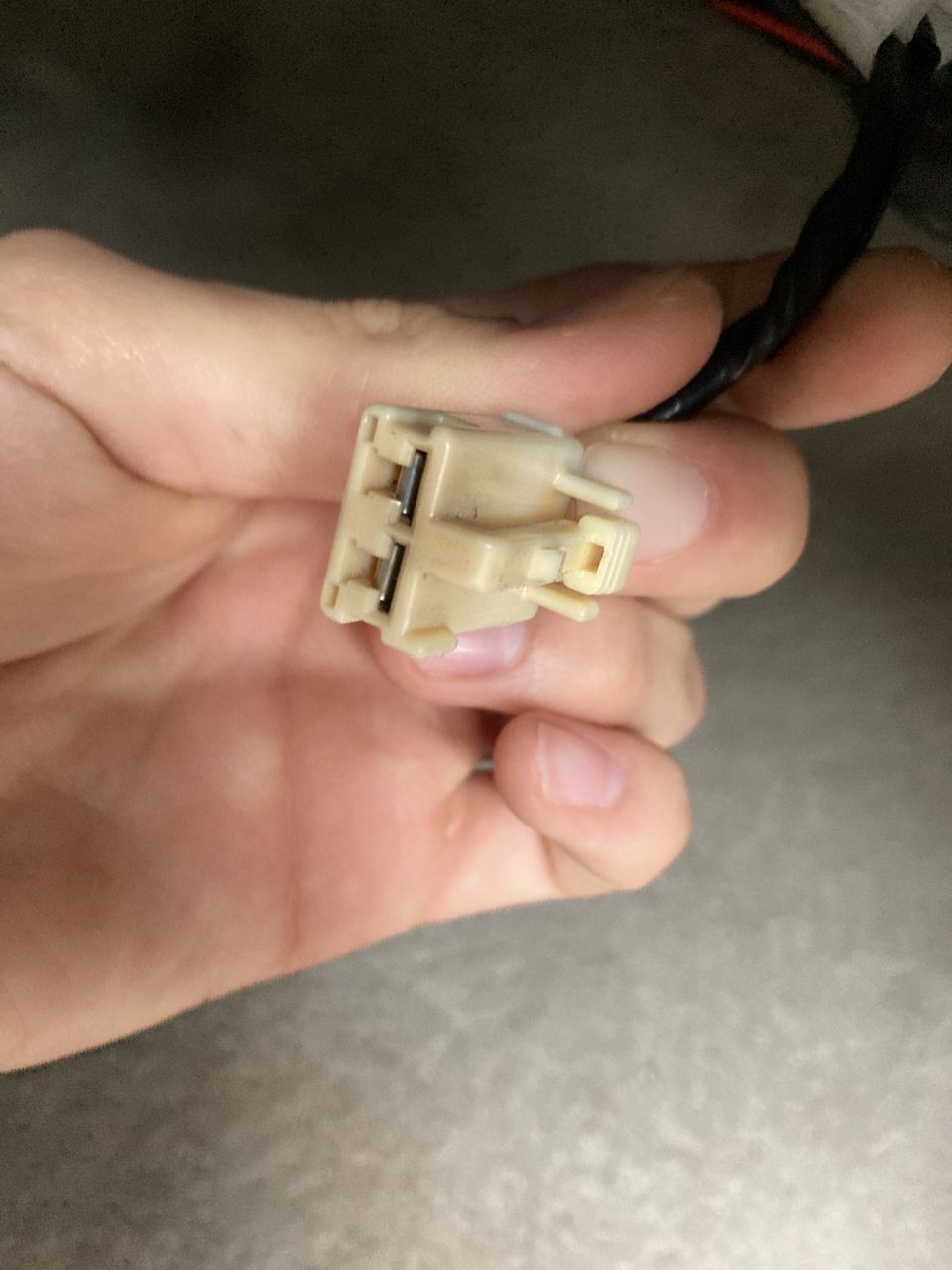

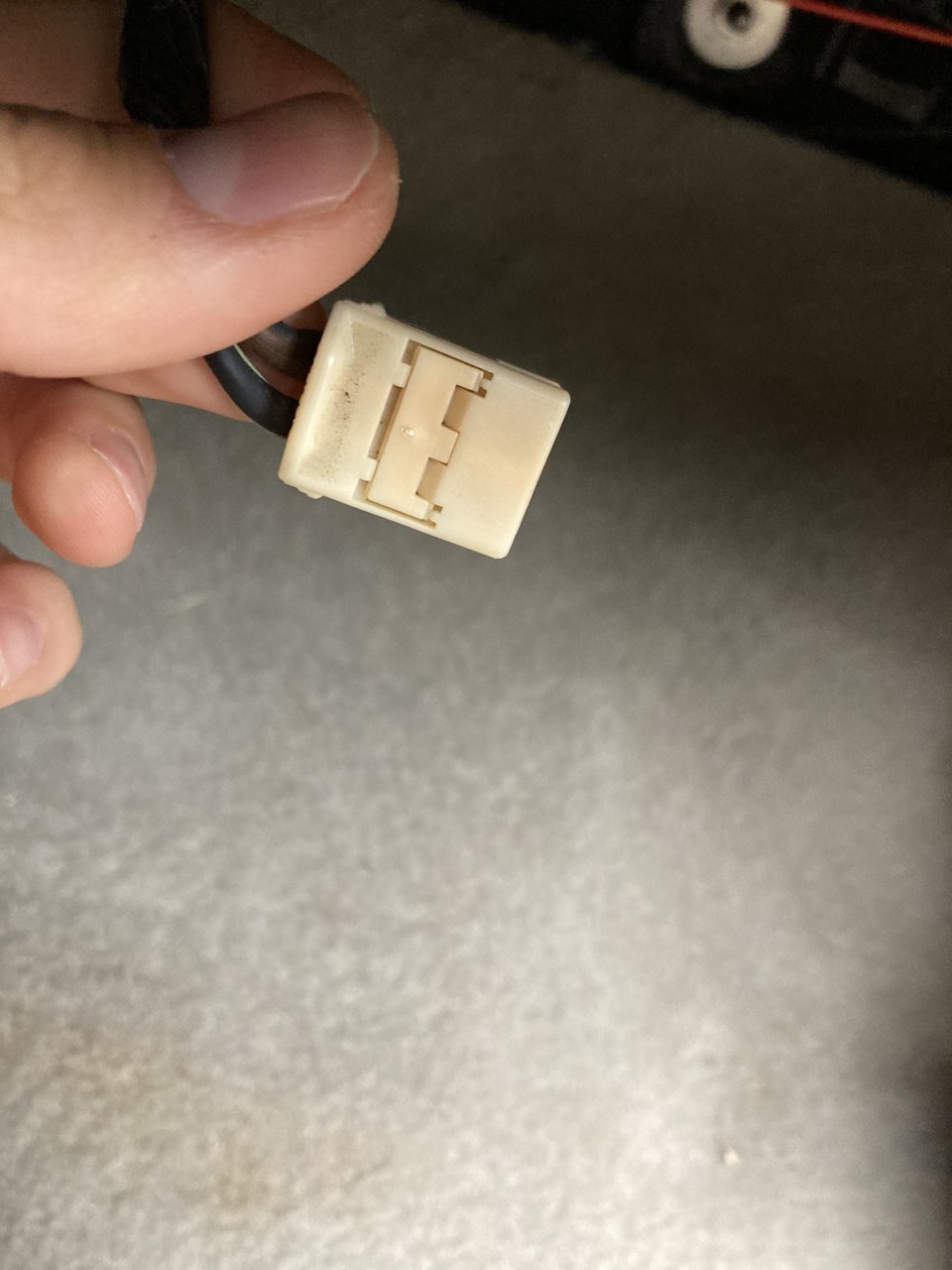

  10. Apr 28, 2023 at 1:43 PM
    #50
    GoldTaco07
    GoldTaco07 Member
    Feb 5, 2023
    #417198
    19
    I checked all connections and nothing looks burnt and it looks like the past owner replaced the original connection that clips into the resistor. I didn’t check the resistor because even at high it wouldn’t blow any air, so it shouldn’t be the resistor. I also checked the blower motor and it looks good as well didn’t even had any leaves. AC Cabin filter looks clean as well. But after disconnecting and reconnecting the connections the AC been working good. So maybe there was a loose connection. But so far it’s blowing cold air after disconnecting and reconnecting connections.:thumbsup:

  11. Apr 28, 2023 at 1:47 PM
    #51
    GoldTaco07
    GoldTaco07 Member
    Feb 5, 2023
    #417198
    19
    Images
    Jimmyh likes this.
  12. Apr 29, 2023 at 11:34 AM
    #52
    Jimmyh
    Jimmyh Well-Known Member
    May 16, 2012
    #78991
    14,316
    SC
    2012 Prerunner SR5
    They look good. They could still be loose.
