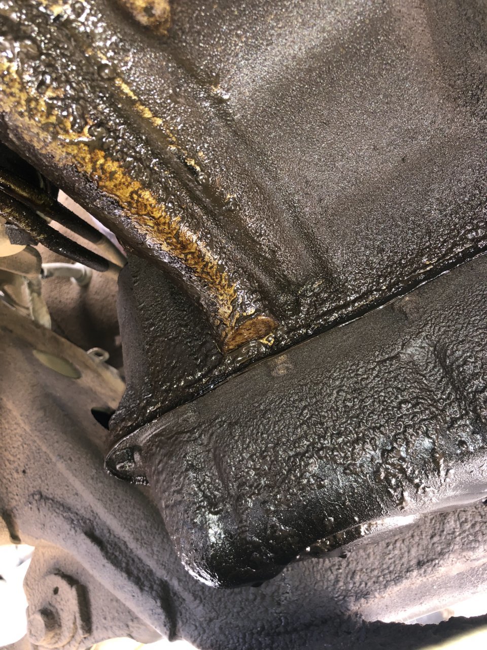

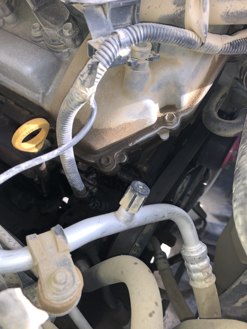

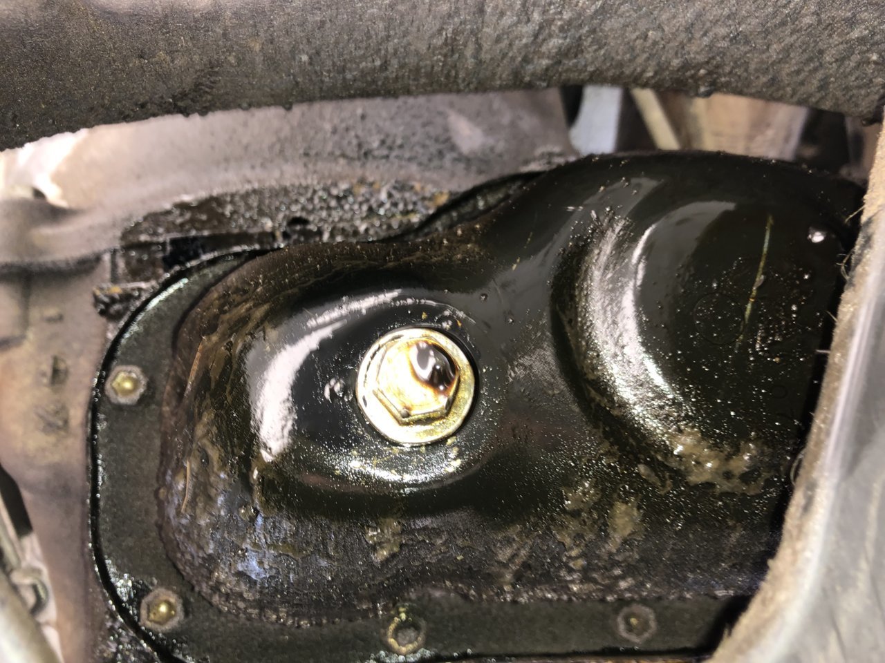

    I have the exact same problem, took some pictures of the oil, I’m thinking it’s the valve cover but would like the opinions of people with more experience98A85487-02B9-4139-9BE6-3E0D89B9DDAB.jpg 2E1BE34E-46C2-47B4-923C-9970C47F6259.jpg 379804B5-E458-4742-8E4B-5005DC239C1E.jpg

    I would use some full strength Simple Green to clean that. Then tighten down the accessible valve cover bolts. I used a small ignition wrench. Don’t over torque the bolts.

    I have the same problem. My valve cover gaskets are leaking. Going to take the project this winter when i'm bored. Same cabin smell, its most likely oil hitting the manifold and the smell making its way into the cabin from being stopped.

    Yeah looks much like mine when I started to look. I only smell it at stop lights at time so I guess it's a hit or miss on when it accumulates/leaks. I'm taking my taco in to a local mom/pop auto place to look at. They said labor was about $310 for gasket replacement. If I had the skill and spare vehicle I'd do it myself but alas I got to have it done somehow!
