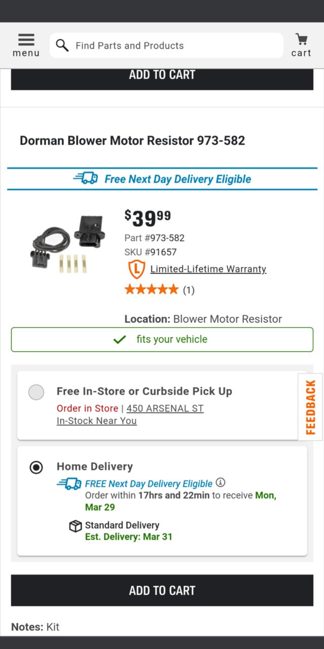

    OP, auto parts stores sell a kit with a new resistor, plug, and crimps to cut and splice the new connector on. Cut and splice one wire at a time. Staggering the cuts so you don't have all the splices in one spot.
    30 minute job with good wire strippers and a sta-kon tool.

    This, just do the resistor tsb with the new plug. Took me 30min and its been good for 3 or 4 years now

  10. Mar 26, 2021 at 3:24 PM
    point45
    point45 Well-Known Member
    Dec 26, 2019
    #314279
    730
    SoCal, OC
    05 DCSB TRD offroad
    NC2001Tacoma[OP] likes this.
  11. Mar 26, 2021 at 4:48 PM
    NC2001Tacoma
    NC2001Tacoma [OP] Well-Known Member
    May 10, 2014
    #129552
    54
    Alright,I'm going to replace both since I will be under there anyways.

    Auto zone...

    The kit includes a new plug but i dont know if its an updated plug or if they just assume if the resistor goes out it damages the old plug with it.
