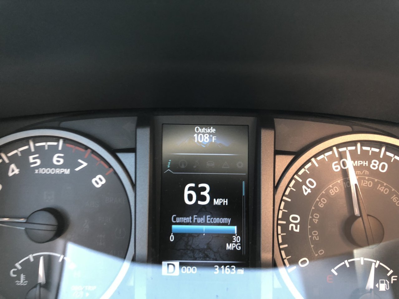

    **Update**
    So after obsessing over how the temperature of the air coming out of my vents “felt”, I began using my digital thermometer to measure the temperature at my vents. Today was a good test. The outside temp, according the the readout on the dash, was 108°. After driving for about 15 minutes and letting the interior cool down, I measured the temp at my center vent and it read 34° and felt ice cold. I was presently surprised that it was so cold. After coming to a stop for a few moments, the temp read 48°. Which is actually still quite cold but I realized that because the temp changed by 14 degrees, I was thinking the system was performing sub-par because it went from ice cold to just cold (if that makes sense) But considering that it was still blowing 70° colder then the outside temp, I’m less concerned. As soon as I started moving, the temp coming from the vent went back down into the 30’s. I also realized that it was so cold that it hurt to hold my hand in front of the vent for longer then 20 to 30 seconds.
    While driving, I continued to measure the temp and found that it fluctuated from low 40’s to low 30’s. I suspect the change is from the compressor going through a cycle so it doesn’t freeze the system.
    After seeing the numbers, I believe the Tacoma is working as designed. I’ve only had her for two month and I’m still learning how she feels. :)
