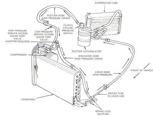

    Most likely you are low on R134-A. You should have your system serviced by a qualified technician. There are many things that could cause your problem besides a low charge, from a bad fan clutch to a sticking expansion valve. Proper diagnosis is the key to fixing a problem with your A/C system.
    The evaporator is in the cab behind the dash. I think you are referring to the reciever dryer which is next to the condensor which is in front of the radiator, that has the sight glass on it. Coolant should be in the radiator and R134-A refrigerant is the A/C system. A properly operating A/C system should blow between 42F and 54F at normal driving speeds (even if it's 100F outside). And humidity actually helps A/C systems operate better. And the OP should understand this, humidity makes swamp coolers operate poorly that's why some people's houses have both A/C and swamp so that during monsoon season you can turn on the A/C since the swamp cooler won't do crap. Not trying to be a pain, but just don't want the OP to get confused with incorrect information. Here's a basic diagram of an A/C system. The accumulator is the same thing as a reciever/dryer and the orifice tube is simalr to an expansion valve.
