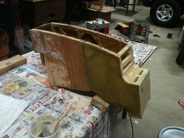

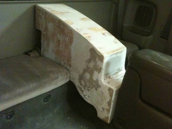

    My first attempt at a box that sacrifices nothing from the factory and sounds decent is what im shooting for. Also I just had to build a structural skeleton and fiberglass it because Ive always wanted to :D
    Here it is as of now:

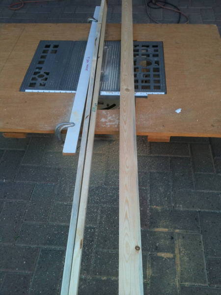

    I had some 3/4'' x 3'' laying around so I ripped it twice to get three 3/4'' x 3/4'' square.

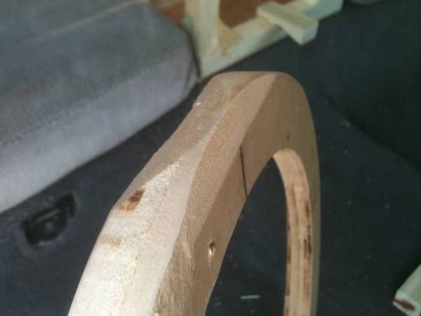

    I cut out an mdf ring for the woofer, countersunk like 1/4''

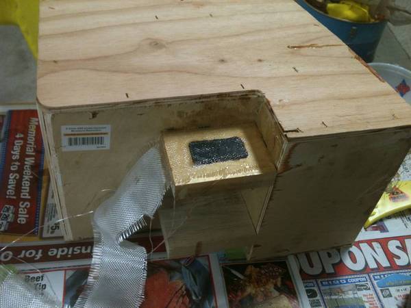

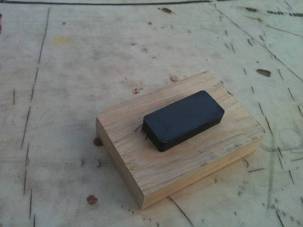

    Then I routered out some rectangles so that I can drop a magnet in there. Its for my seatbelts, you'll see later...

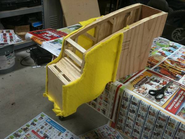

    Here's The Wooden Frame,

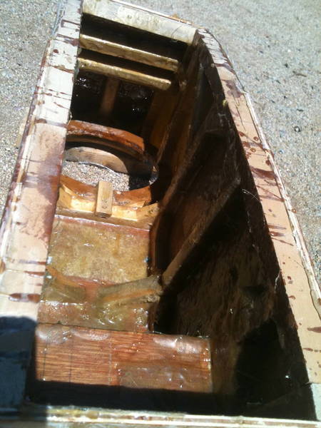

    Glassed up the whole inside and resined a bunch of corners, etc.
    And the magnets you saw earlier in place, Im going to put steel strips on the seatbelt so they clunk right in there like magic

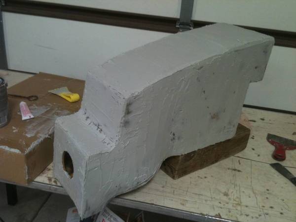

    Bondo! I love bondo
    :mudding:BRAAAP
    So thats all she wrote for now, I had it in my truck playing for two days and I yanked it and im sanding a little more, finishing bondo, etc. Ill keep y'all updated :cool:

    I made it like this to maximize internal volume.. and I wanted to build a box a different way, i have built dozens the normal mdf/carped way.

    I'm surprised you didn't make the side pieces solid. Would have saved you about an hour just on the cutting alone. Have you ever tried kerfing?

    Thats a good point, but like i said i wanted to maximize internal volume, and I wanted to just mess around with the 3/4'' x 3/4'' to get used to working with it so i could make the front solid, which was much trickier than the back.

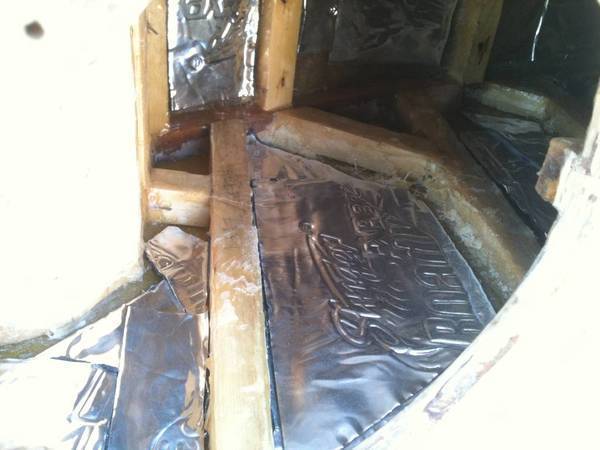

    Today I put like 2 layers of deadener on the inside to kill any boomy overtones, and primed it to get a better feel for the shape of the box before more bondo
