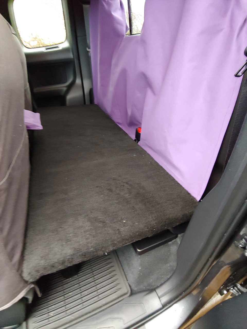

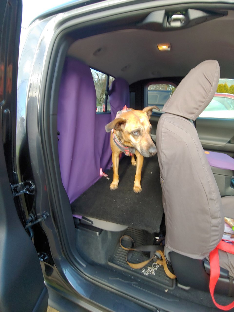

    Thank you for the ideas. This is how I ended up doing mine. I made the seat cover out of a heavy canvas.0112201408a.jpg 0114201155_HDR.jpg

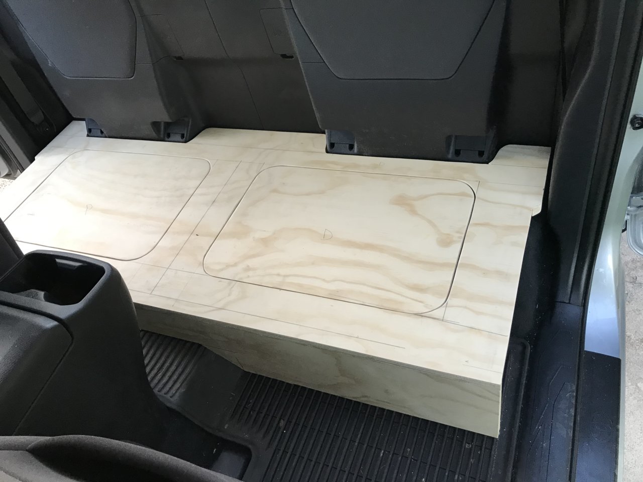

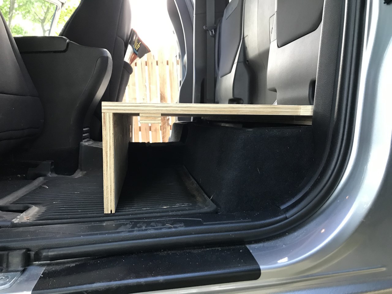

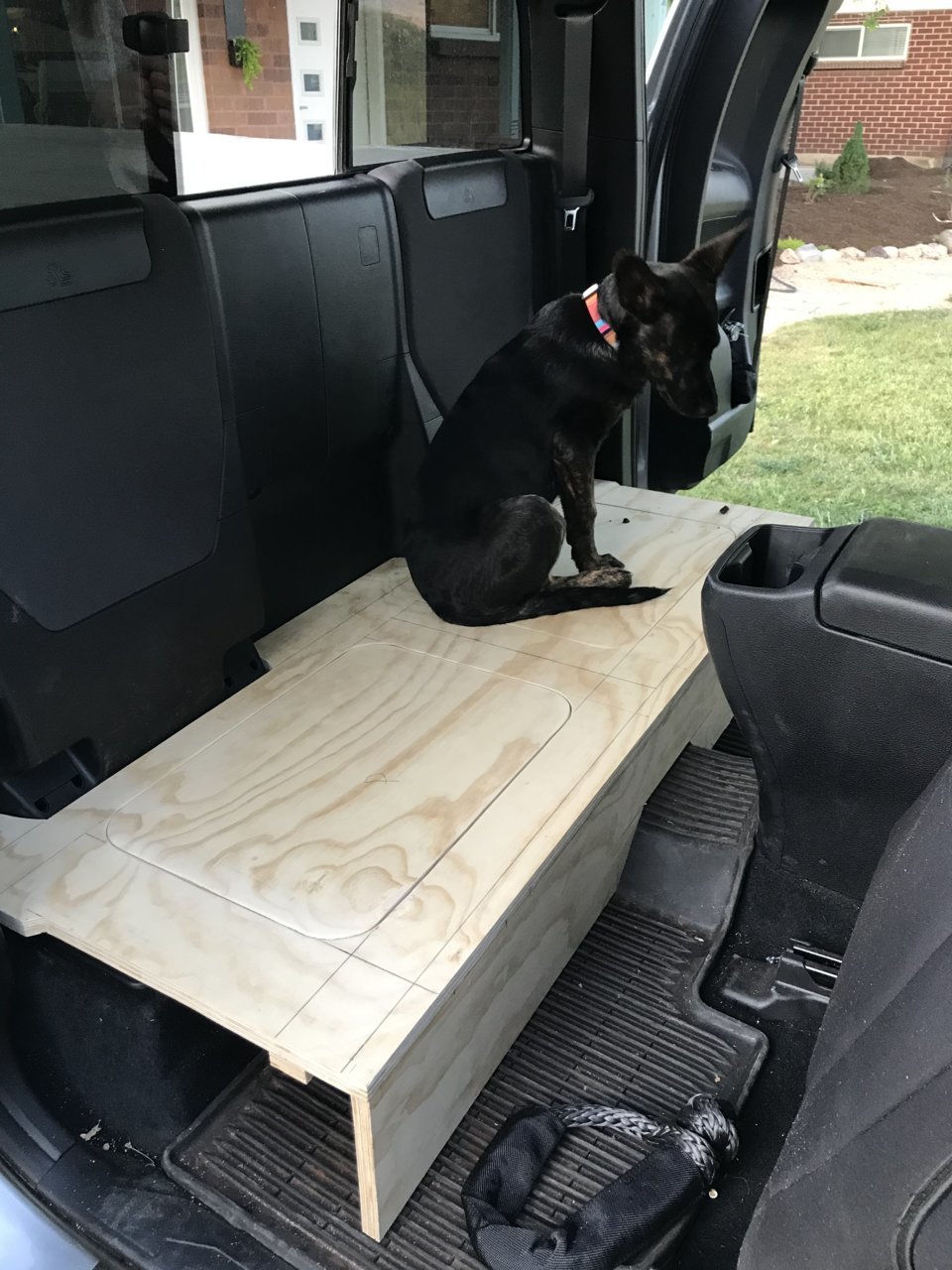

    Stole some inspiration from this thread and decided to take out the jump seats and make the pup a comfortable platformF45018F4-02DD-4EF4-9C8F-437C381A21A1.jpg D879211D-4D78-46D2-8738-E3489C540BD2.jpg E93876FE-48F3-498B-A736-2AFD32D4A51C.jpg 4F03548D-A87F-4B05-A12F-E47BD51B9957.jpg D3318972-984D-4098-BA1A-168AD7FA3AA6.jpg Doggo approves !! Now I just need to throw some carpet on her and some hinges and it’ll be ready to roll.
    thanks for the inspo tacomaworld.

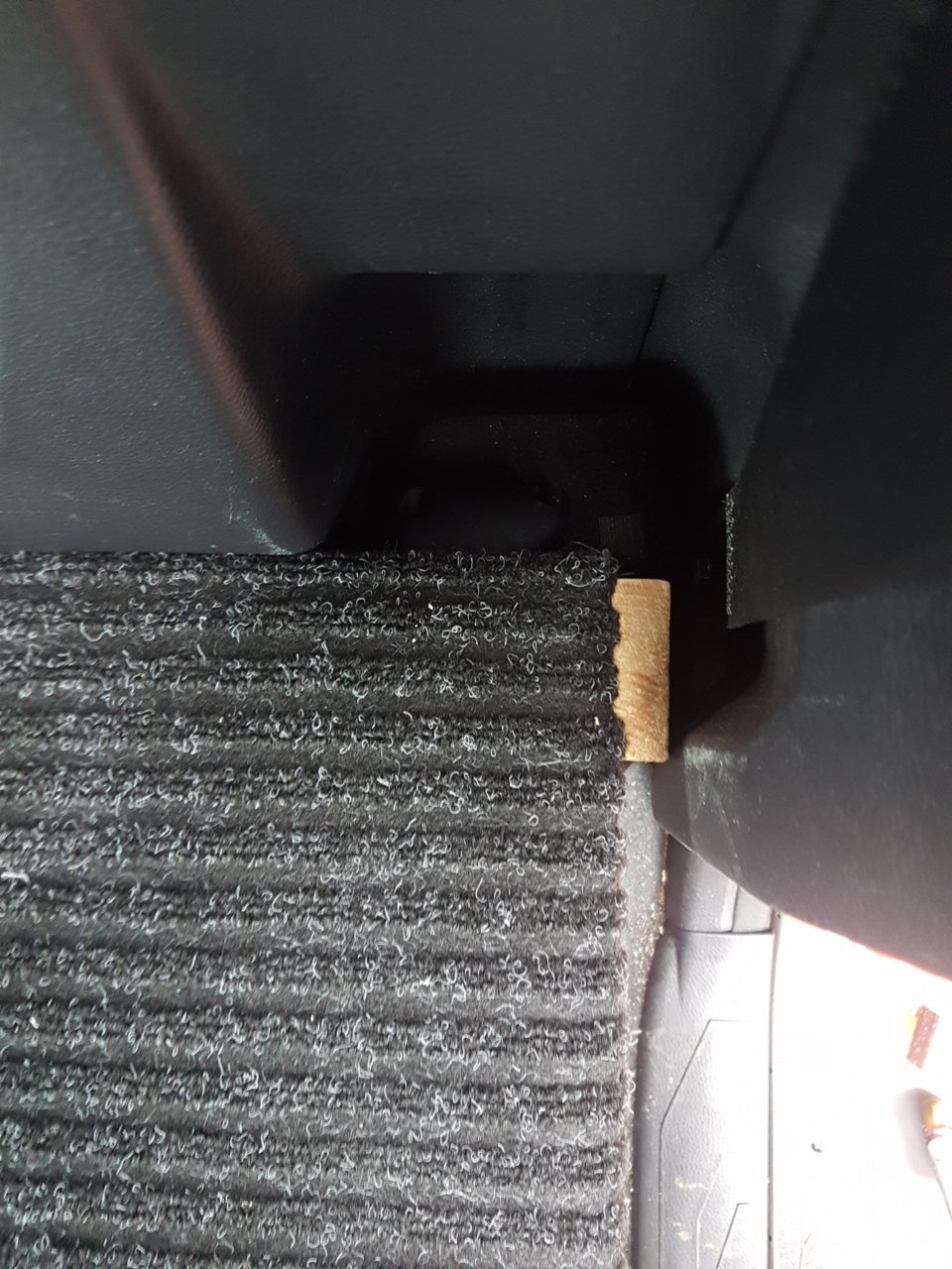

    What are the dimensions of the platform there?
    I'm trying to build one myself but my access to tools/shop space is nil. Was hoping to do something more like a modified table style like FLJB does here:
    https://www.tacomaworld.com/threads/access-cab-dog-platform-udpate-pics.72761/page-3

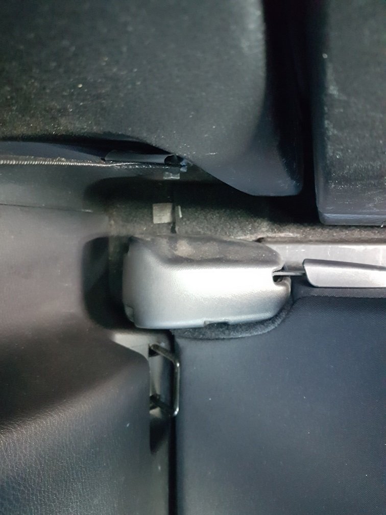

    But the 2nd gen interior must have narrower AC doors when closed, cause based on my measurements on the 3rd Gen access cab it's at MOST 51.5" with no wiggle room. See pic for extra door space jutting in past the back part.2021-02-25 16.51.22.jpg
    Point is, I can get the hardware store to cut a slab to size, and its legs to my desired heights, but I wouldn't be able to cut out slots or round corners like some of y'all are doing for the seat backs/belt areas. A drill would be easy enough to borrow and use without needing table space.

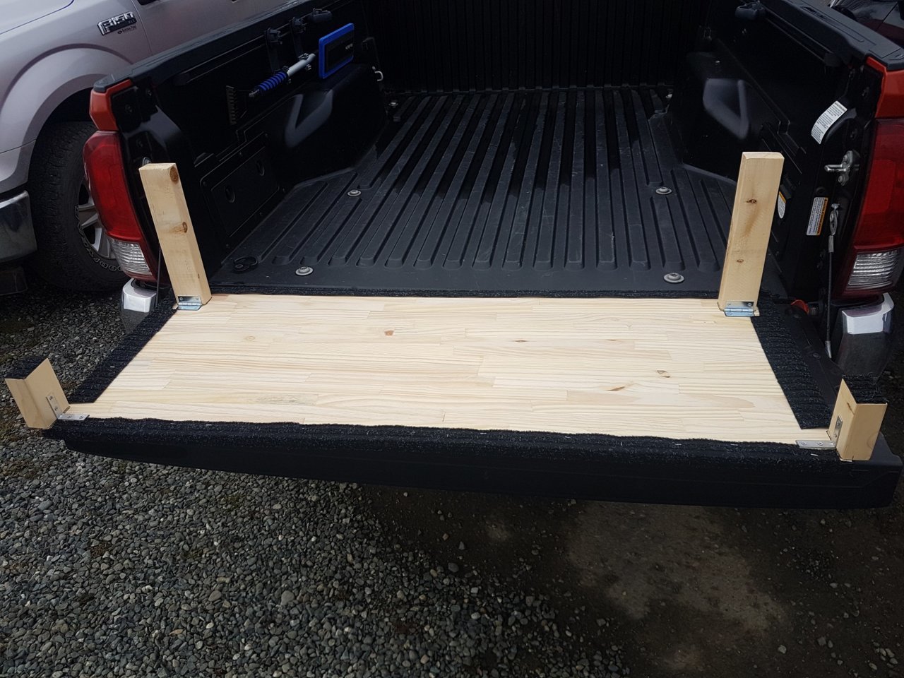

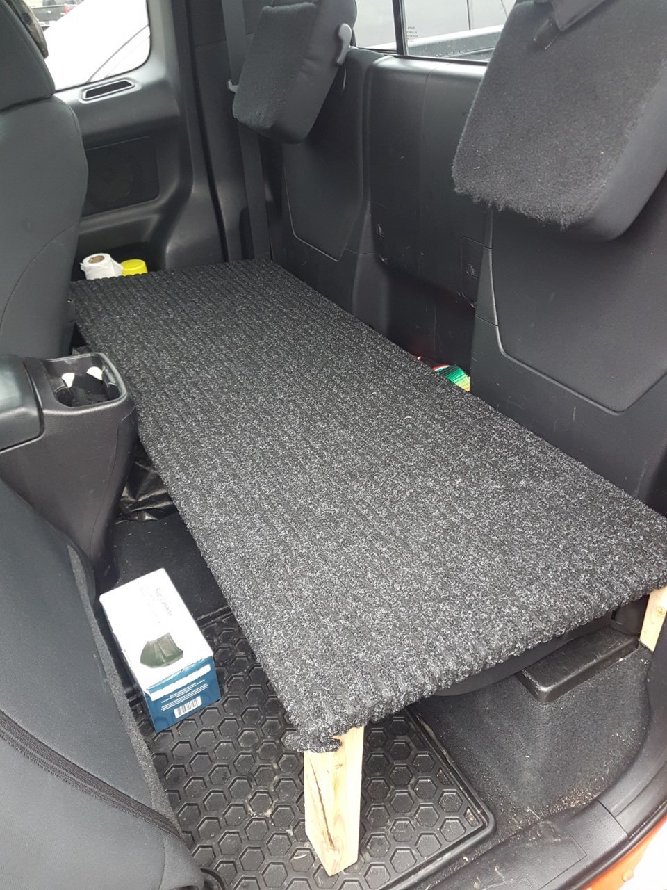

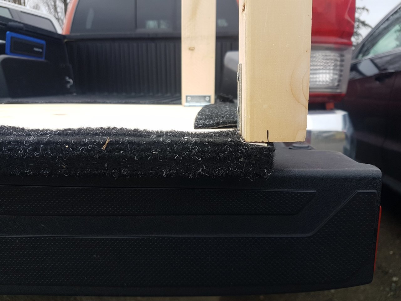

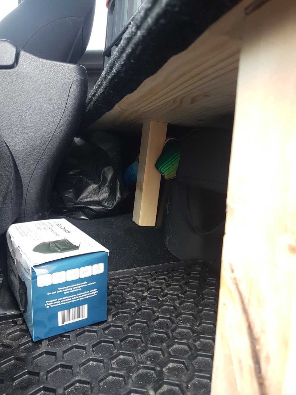

    ended up just risking it and turned out great! Note that I had to glue the carpeting coming off in the bottom left of the pic there, it now sits flush.
    Added hinges to the front legs for ease of stowing away.

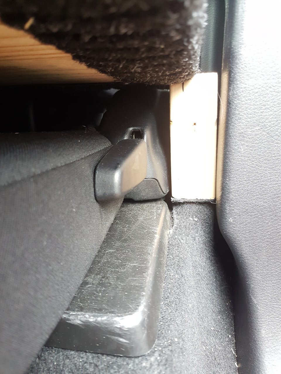

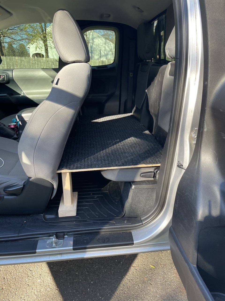

    2021-03-02 10.36.44.jpg 2021-03-02 10.36.48.jpg 2021-03-02 10.44.16.jpg 2021-03-02 10.44.26.jpg 2021-03-02 10.45.26.jpg
    Build specs:
    Platform: 3/4" thick 51"by 20"
    Front legs: 12"
    Back legs: 4"
    Middle leg: 9"
    Cost (with tax):
    Pine plywood (3/4" 2x8 cut to size): 37.70
    2x3*8' leg (cut to size): 5.10
    Carpet runner: 20.14
    Hinges and corner brackets: 8.94
    Staple Gun: already owned
    1/4" staples: already owned
    Contact cement and epoxy: already owned (used to carpet the feet and that bottom left corner as seen in the first pic) Also found in dollarama for 2-4 bucks.
    Drill with 3/64 bit: borrowed
    Total: 71.88CAD
    Although total build COULD have been 56.22CAD in hindsight as they sell a 2'x5' runner at the dollar store for 4 bucks, was too late to return the carpet since I already cut and glued it.
    Had to add the corner brackets to the back legs since the rear of the AC is wider than the front with the doors closed. Each leg overlaps 2cm (yes mixing my units lol). Recommend using longer staples for this carpet if you have them.
    I don't have a dog, built this to stow my things in the back easier.

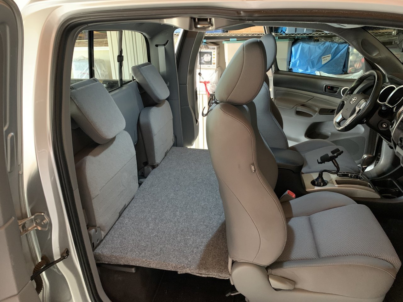

    #373130
    23
    Dz
    CA
    2012 Silver TRD Off-Road Access Cab
    Bilstein 6112’s (4th snap location) HeadStrong OffRoad 1/4” taco lean spacer Icon Sway Bar Relocation Kit SPC LR UCA’s Bilstein 5160’s w/ reservoirs Icon 1.5” AAL 17x8.5 Method MR305 NV’s in matte black LT285/70/17 Falken Wildpeak At3w - C load GoRhino Dominator nerf bars Fox Overland Tailgate Bike Pad All Pro Off-Road Low Profile Front Bumper w/ hoop Cab Mount Chopped + Fender Liner trimmed TechDeck RAM Mount
    Platform: 3/4" thick, 48" length, 20" width
    Wrapped in gray indoor/outdoor area carpet from Home Depot
    Front legs (2): 7"

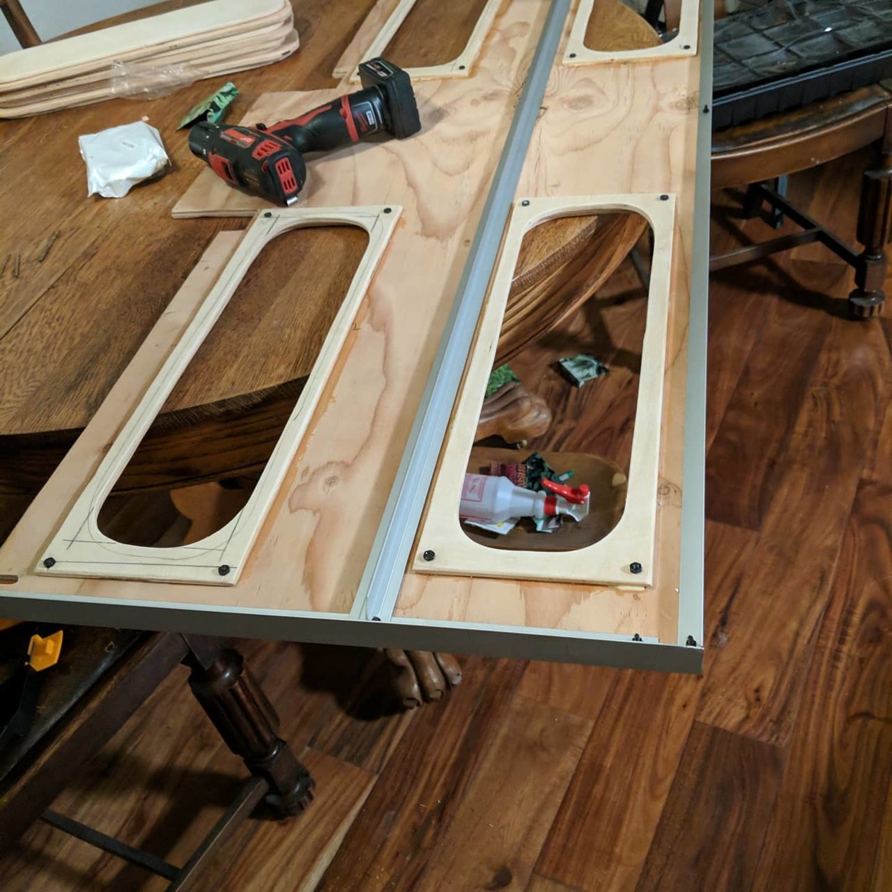

    specTACOluar
    specTACOluar Well-Known Member
    Dec 30, 2020
    #351136
    57
    Eastern Oregon

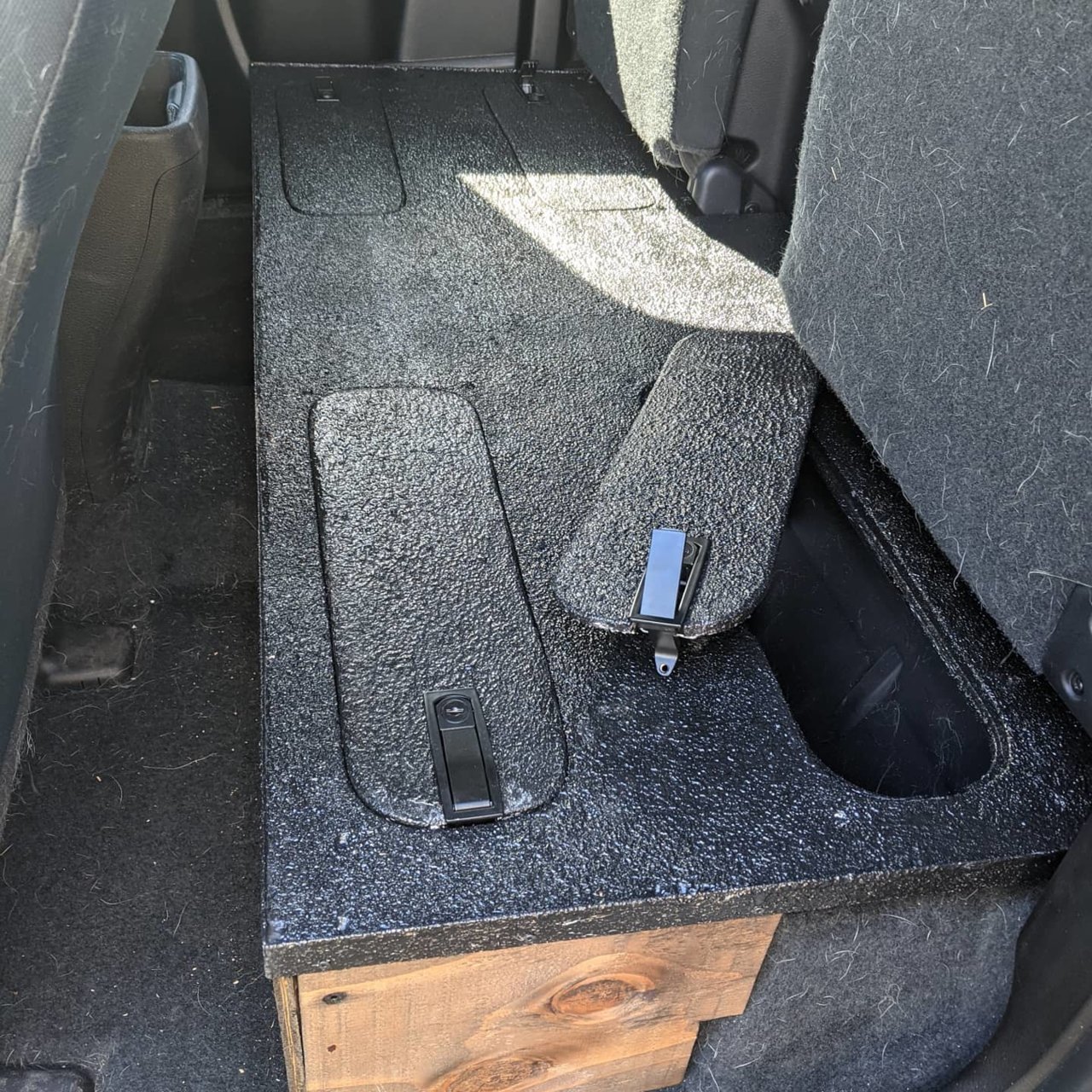

    I used light plywood, reinforced it with aluminum, and raptor lined it.
    drperez, mrbetelman, BigEasy and 7 others like this.
  15. Aug 16, 2021 at 11:02 PM
    #75
    dzking
    dzking Member
    Aug 3, 2021
    #373130
    23
    Dz
    CA
    That is sick! How much did it cost to build this?
    AxisCab likes this.
  16. Aug 16, 2021 at 11:07 PM
    #76
    specTACOluar
    Dec 30, 2020
    #351136
    57
    Eastern Oregon
    Plywood: ~$50 (covid wood costs)
    Raptor liner: ~$70
    Aluminum: ~$20
    Flush handles: ~$20
    Total: ~$160
  17. Aug 16, 2021 at 11:35 PM
    #77
    Toycoma2021
    Toycoma2021 Well-Known Member
    Jan 3, 2021
    #351607
    1,899
    Northern California, Temporarily
    2021 Access Cab, LB, AT, V6, Off Road

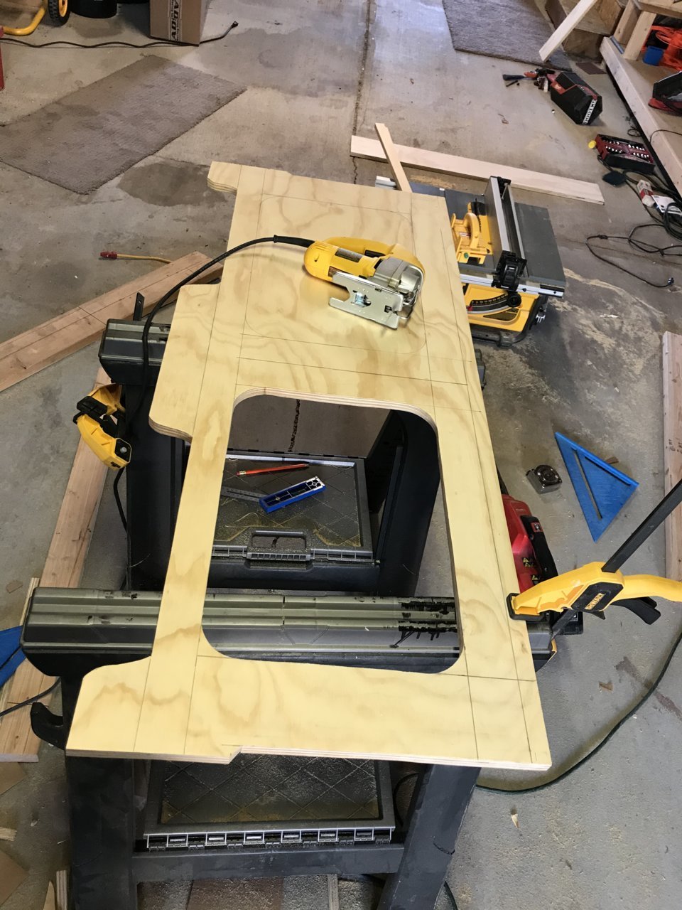

    Just a wood working question: How did you cut out the openings so neatly? I don't see a starting entrance for your jig saw.
  18. Aug 16, 2021 at 11:59 PM
    #78
    Phil61s
    Phil61s Well-Known Member
    Apr 5, 2021
    #361770
    74
    N PHX
    2021 Tacoma SR 4x4
    Set up start/stop blocks on table saw fence. (or pencil marks if you trust yourself, but be carefull!)( I was a cabinet maker in a former life, so pretty good with wood) Start with the side cuts first on the table saw, finish the corners with jig saw. I bought the plywood last week, just no time to work on it right now, maybe in a few weeks:rolleyes:

    Fohu
    Fohu Well-Known Member
    May 9, 2019
    #292811
    632
    Glade park Colorado
    2019 trd or access cab
    I just drilled a couple of holes big enough to bit the jigsaw blade in there.
