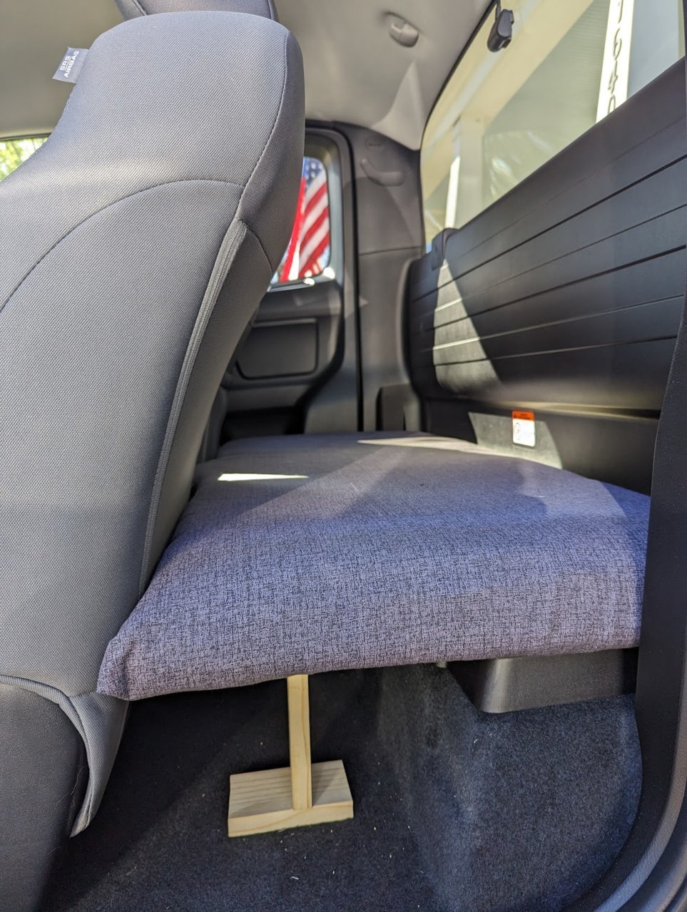

    Bed mat

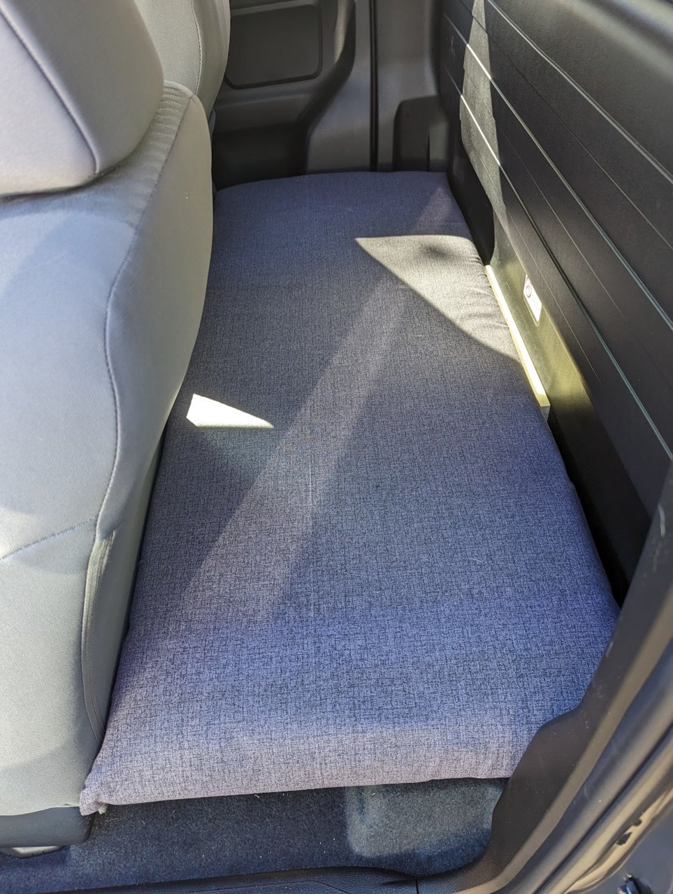

    I went for the soft platform approach and sewed up this seat cover. Works great with the kid seat while keeping Gus from falling down to the footwell89DF42E7-AB04-4456-83F0-135D658F226A.jpg

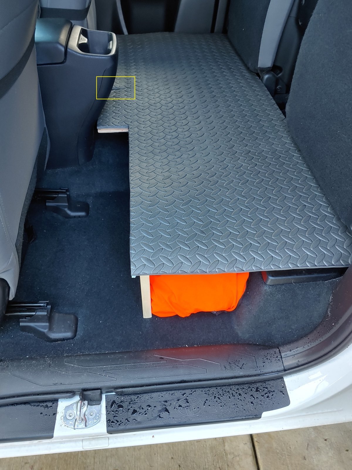

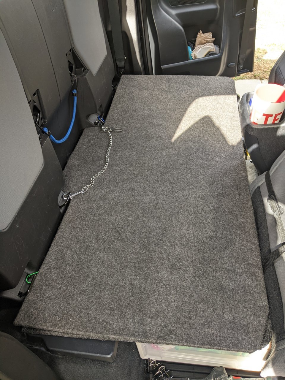

    Here's my humble contribution:
    1/4" sheet of plywood wrapped in automotive carpet that's sitting on top of a 1/2" thick foam mat that's sitting on a DeWalt Toolbox on one side and a slide-out drawer on the other. In the center, I used another piece of thick foam in found from a box that a computer was shipped in.
    On top of this, i add a dog hammock to contain the hair and messes.

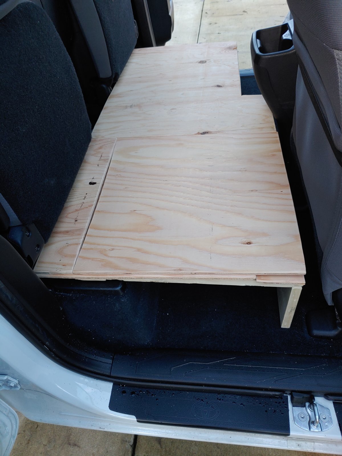

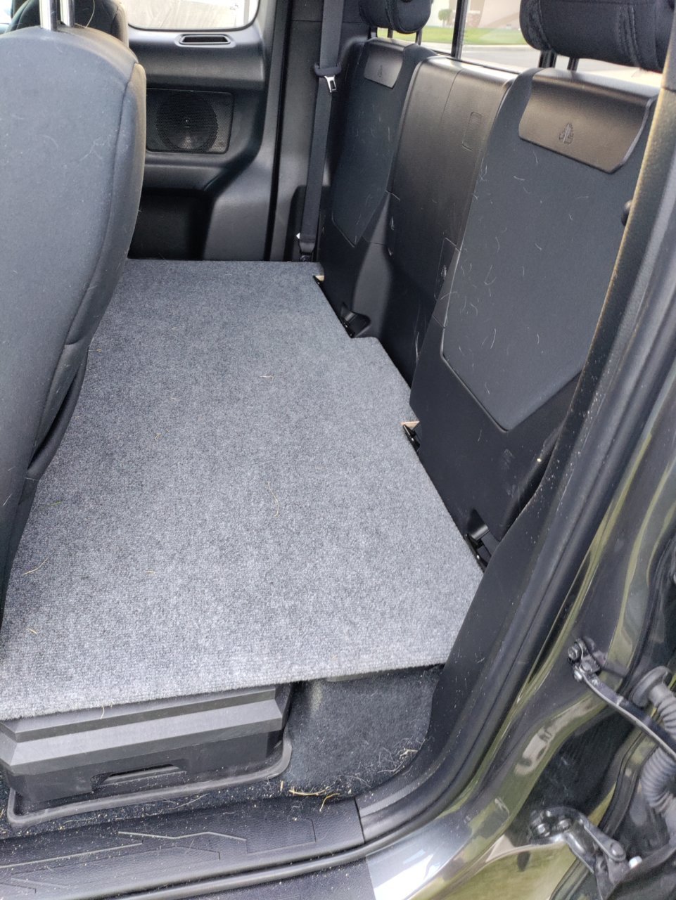

    Finally got around to it this weekend. Kept it simple, but works perfect for what I need!

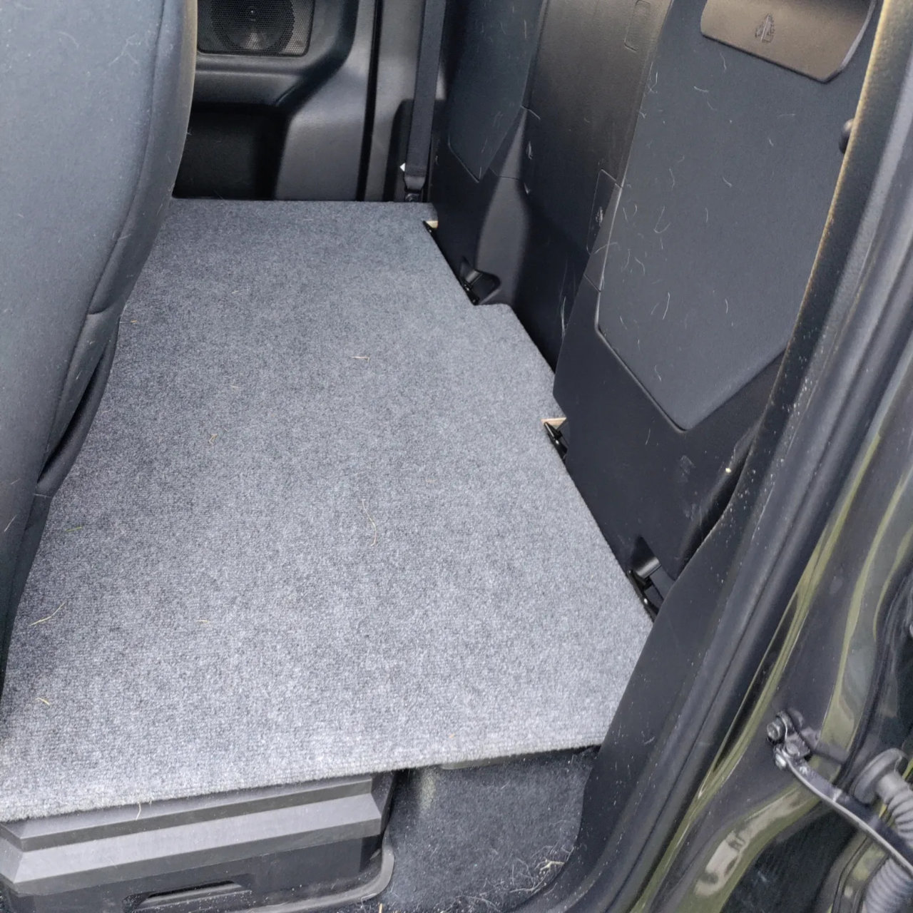

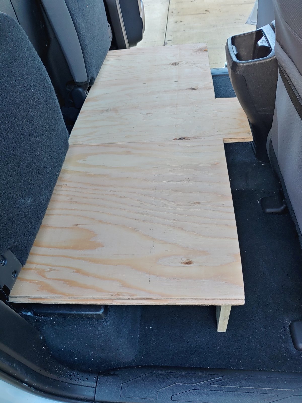

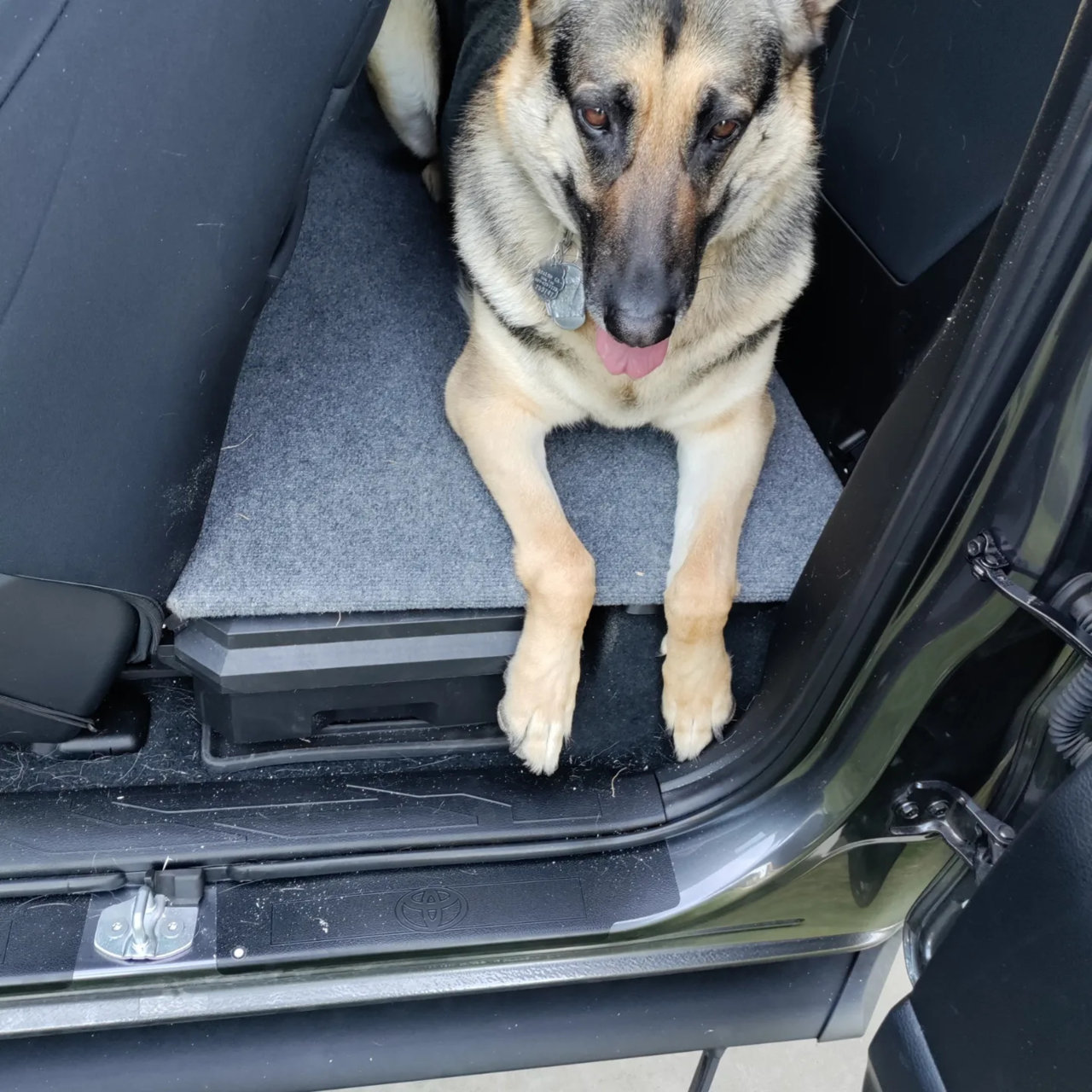

    Got mine done tonight. The 2022 access cab has two small wells and two even smaller tool storage areas. I found that Craftsman stackable tool boxes fit perfectly in the wells. Cutting the half inch plywood was the hard part.IMG_20230411_182324.jpg IMG_20230411_182336.jpg

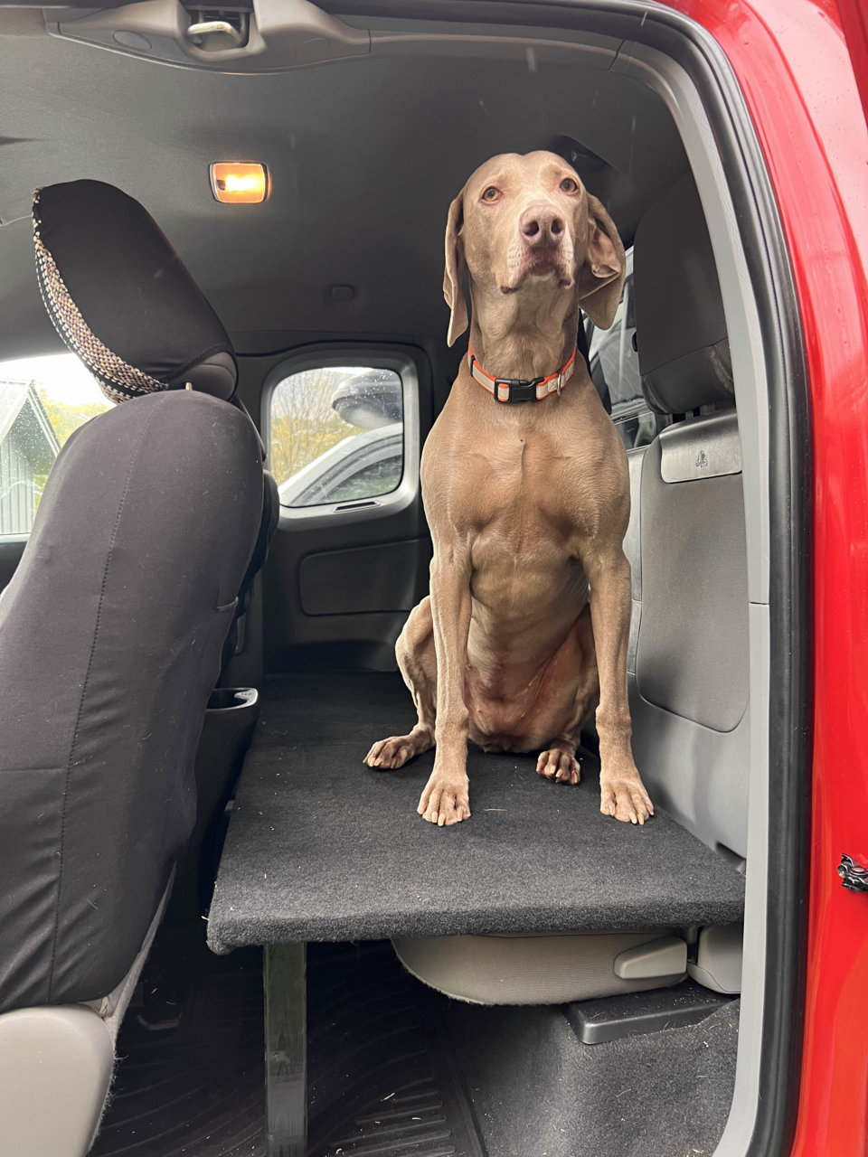

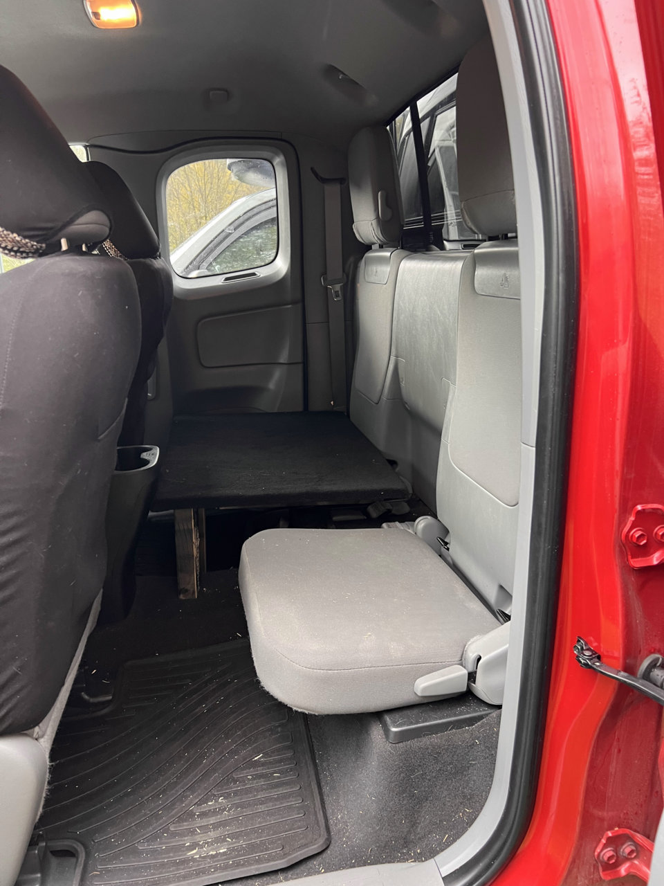

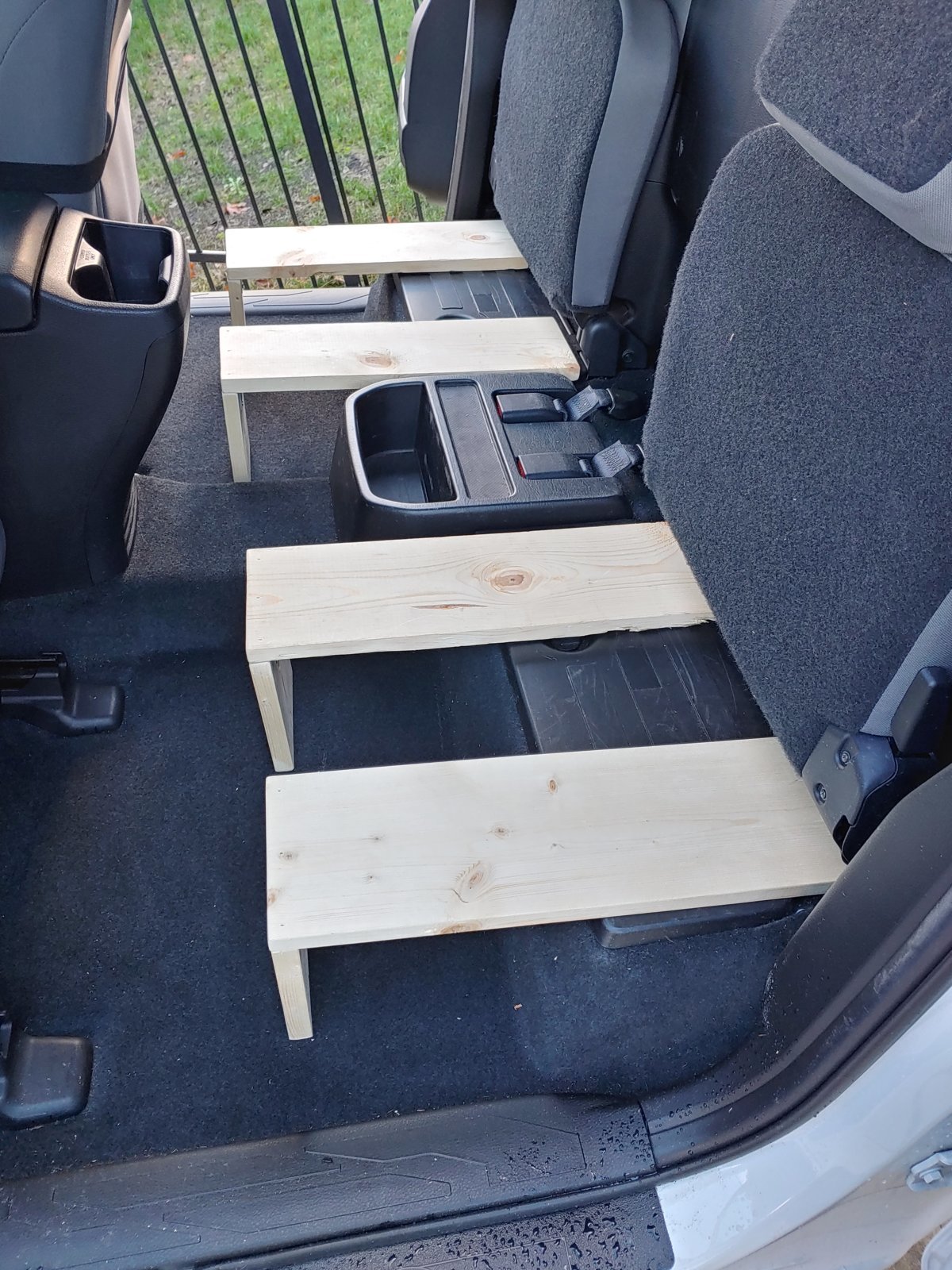

    Just got around to finishing this project for my 2015 AC.
    I decided to do a 60/40 split so I can set myself and 2 others with the dog still having enough space to be comfortable. Added extra supports in the middle so each platform is stable.
    Will probably sew a custom pad down the line out of a baja or saddle blanket to match my front seat covers.
