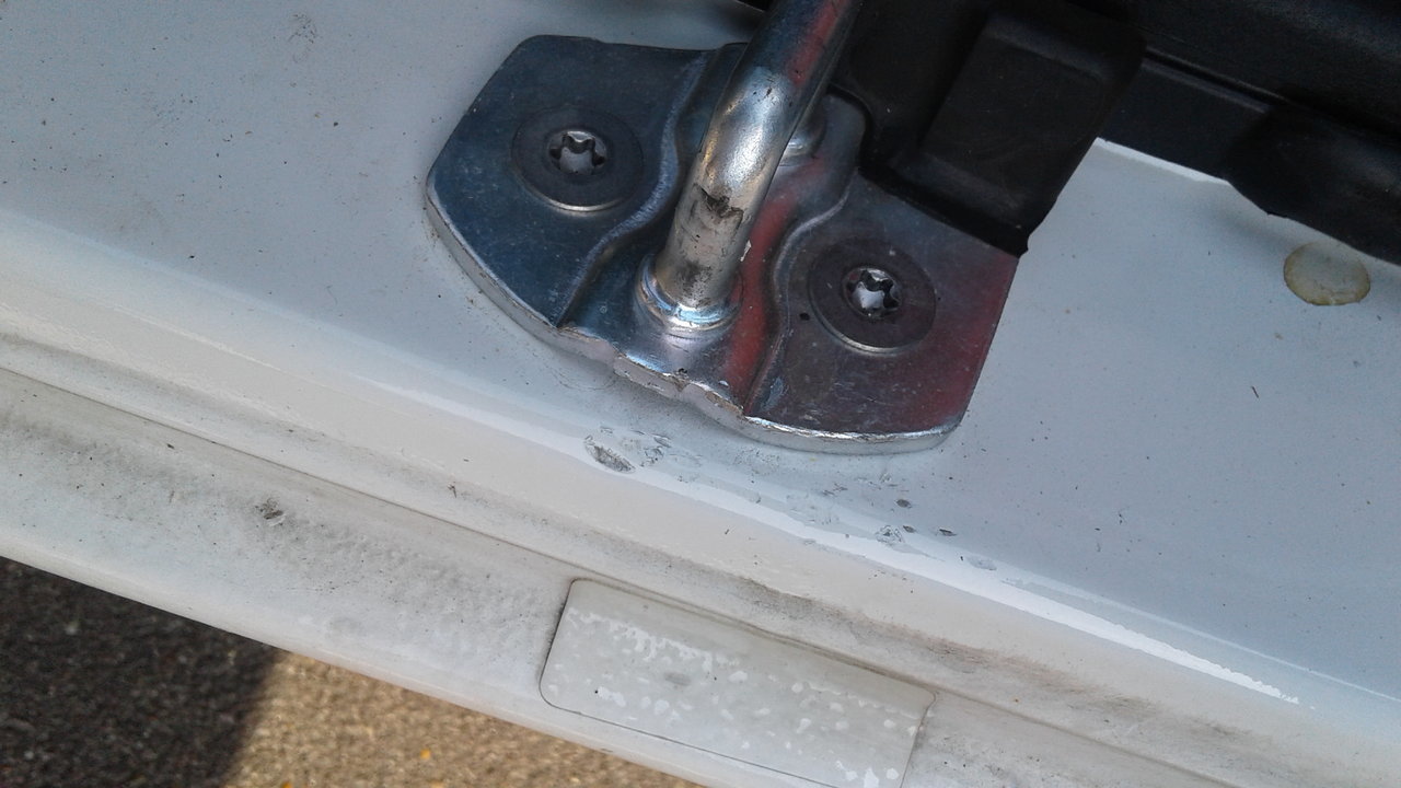

    I thought I was the only one having this issue. I have a rattle/tick right in my left ear coming from where both doors meet. It's done it since it was brand new and I can't enjoy my truck for listening to it. If it's the same noise, it's seems like its coming from the weatherstriping. Took to the Dealer and they "adjusted" the door striker(see below picture Ha). Tightened up the door but didn't help. The only thing I've found that gives me temporarily relief is applying Sil Glyde from NAPA to the weatherstriping. Lasts only a few months but makes the rattle/tick go away. Hope this helps.

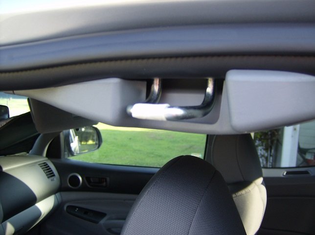

    I had this exact problem on my 2015, they had to order some different strikers that had more adjustment which took a long time, I ended up wrapping some masking tape on the upper and lower strikers themselves where the door latch made contact and that silenced it for the most part.

    Just as info the striker latches, top pick in the thread, are NOT adjustable. Pull one off, you'll see, I have. Re tape on the striker latches, I tried that and it worked. As a perm solution I took light thin gauge steel and rapped it around the latch (off the truck, in my garage). Took a lot of time but it's permanent. I did't have a rattle but I did have excessive wind noise from the door seals. This helped quite a bit, a tighter door that it.
