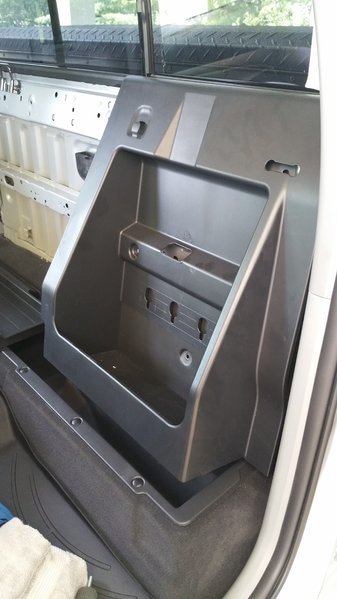

    Well well well,
    Yes there is a LOT of road noise coming through just the back wall, I figured it would be but wow.
    I went by the dealer today to look through some used DCs. I was scoping out the black behind rear seat organizers,
    I found out that some of the smaller bolt holes do line up with what I have in the back of my truck. Not sure about the plastic white clips that just push in and kind of snap in place.
    I did make a little progress before the rain and darkness set in and through a process of using bolt heads and grease, mark where I needed to drill a half inch hole and get the bolt through to what are 4 spaced welded in nuts. I am not sure what they are used for ion the AC with rear seats. But they are solid. I only got one done so far...
    I took a pic of the bolt I used to see the length. I am not sure what I am looking for but I plan on maybe a 3/4 or 1" rubber grommet and then a nice round head coming out so I have a way to secure something to it. I am not looking to secure heavy items but I imagine a nice elastic type net from the two center most would be an awesome place to throw a rain coat or extra layer, Think Land Cruiser or 4runner "Attic" but mounted to the back wall.
    George1441 likes this.
  8. Jun 27, 2016 at 6:35 PM
    #48
    Greenbean
    Greenbean B.S. Goodwrench
    Aug 8, 2012
    #84332
    3,253
    Zack
    Western NC
    2015 AC 2.7L 5-spd 4x4 Utility Package
    I dove even further in after the rain let up and the sun tried to come back out.
    This is a pic of all 10 bolts removed from the cross section back there. Turns out the two largest center silver ones must be the seat belt buckle bolts as they have light coming through the holes hence they are nuts on the frame or something. I reinstalled them, and the two lower outer bolts as well. I have a meeting in the morning so I'll see if any others leak air and put the nuts back in. I'll hopefully use some nice counter sunk flanged bolts of sorts where those two seat belt buckle bolts are...
    This is the item I wanted to remove. It does have the back part of the clip holes for the actual plastic tray in it but when I'm finished it won't matter. I could also just put it back in. I'm going to get my measurements and try it installed as well. I mean if anything it may help support the outer edges of the platform.
    Now we are talking, the highest point is that back center section which will probably be where I secure the center back part of my shelf or platform. This is going to look sweet, I want it to just sit level or slightly canted rear just a touch and run from both sides to the back of the seats. I'm still working on how that will be devised as I may try and run the center of it a little closer to the console back and keep it behind the seats themselves. I in no way want to limit how far back the seats recline. AC seats recline further than DC seats do.
    I want to keep the factory plastic tray segment. Which is fine by me. I'll just have to make a simple yet strong door option into each one. No big deal.
    Just grabbed a small piece of cardboard to get an idea of the size of a nice platform back there, I also see I may try and cut some nice curved sides into the unit to align good with the sides of the AC doors.
    When I have more time this week I'll make a full size template and see what size this thing is going to be. What kind of wood would you guys recommend. I was thinking MDF but I may be way off. Also what thickness?
    I plan on just using legs to keep the outer portions in place but will tie the lower portions of the legs into the front seat rear mount bolts I think. I want to be sure it's never going to move after I install it. Also it may allow me a type of container slide in and out with my existing little Hefty tubs.
    Then I found this link and was like, Dear Lord Yes! I need some of those on this platform to secure two pieces of luggage and our cooler on trips....

    I was in the position today to have both a DCSB and my AC under my carport, decided to pop my back panel off of my utility cab truck and see if the storage compartments that are in the back of the double cab switch in, it's a no-go ladies and gentlemen, not even close. Even after I tried removing the storage box lid it doesn't sit down far enough to engage the brace rib that has the welded nuts in it.
    Just FYI...
