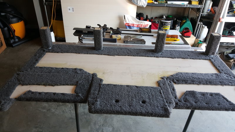

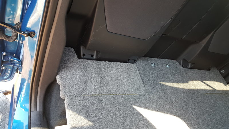

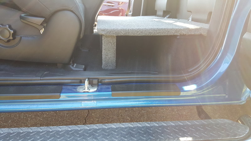

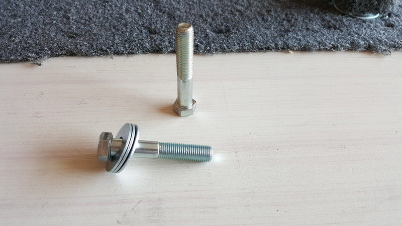

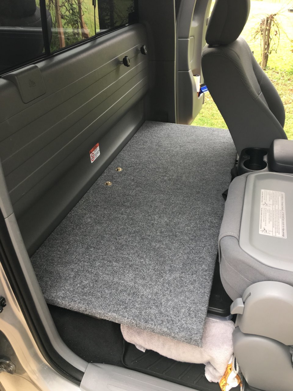

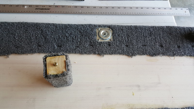

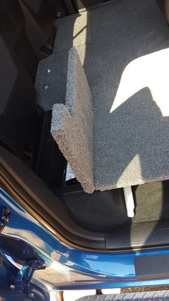

    MetrickMetal & Zerors - You asked for it, here they are! 20160922_113848[1].jpg 20160922_113909[2].jpg 20160922_114100[1].jpg 20160922_120556[1].jpg 20160922_120646[1].jpg 20160922_120731[1].jpg I used a piece of 5/8" luan plywood 25" wide and 53 inches
    long. Note that you have to trim down the width about an inch and a half on each side so the rear
    doors will close. Construction does not require any bracing because I put the 12 inch piano hinges
    over the forward edge of the existing storage boxes. The carpet is a Marine carpet with rubber
    coated jute backing. I was lucky enough to get a 48" x 60" remnant for $20.00 OTD at a local
    carpet shop. I will also use it to cover my subwoofer enclosure when it gets here.
    * The first picture is of the finished product (upside down) with all the tools and materials used in
    construction in the background.
    * The second pic ids of a parsons table leg wrapped in carpet (source: Lowes) It is an 8 inch leg
    shortened to about 5 1/2 inches (the platform is level).
    * Pic three is of a Grade 5, 7/16-20 bolt 2 1/2 inches long (source: Ace Hardware - Hillman
    product). I elected to use the 2 1/2" bolts because they will also anchor my subwoofer
    enclosure when Mr. Marv gets it finished.
    * The fourth pic is of the installed platform, from the rider's side.
    * The fifth pic is from the driver's side showing the level platform with additional storage underneath.
    * The final pic is of the open lid to the OEM storage bin on the riders side.
    All cuts were made freehand with a Porter Cable 20V Jig saw except for two cuts made by Lowes
    on the 4' X 8" plywood sheet. I used most of a quart of Weldwood GEL Contact cement (about
    $27.00 at Lowes). As you can see I have a preference for Lowes because Lowes gives veterans
    an across the board discount, while the other DIY chain picks and chooses what and when they
    discount - and IMO Lowes is better stocked.
    I hope this answers a lot of your questions and provides the incentive for you to build your platform.
    And remember, I am at the other end of your keyboard if you should have any unanswered questions.
    Now you know why I'm called "wudbuchr"!

    So to remove the cover panels to access the head rest bolts do you just pull on the panels at the top until the anchors start to pop out, and are the anchors integral to the panels, or are the replaceable if you break them

    No, you have to pop out the three little rectangle panels from the bottom edge and remove the three bolts first. I used a cell phone tool. Then you can pop out the panels but pull from the outer edges not where the fabric is. I only pulled out the top two rows and that was enough to get at head rest bolts.
