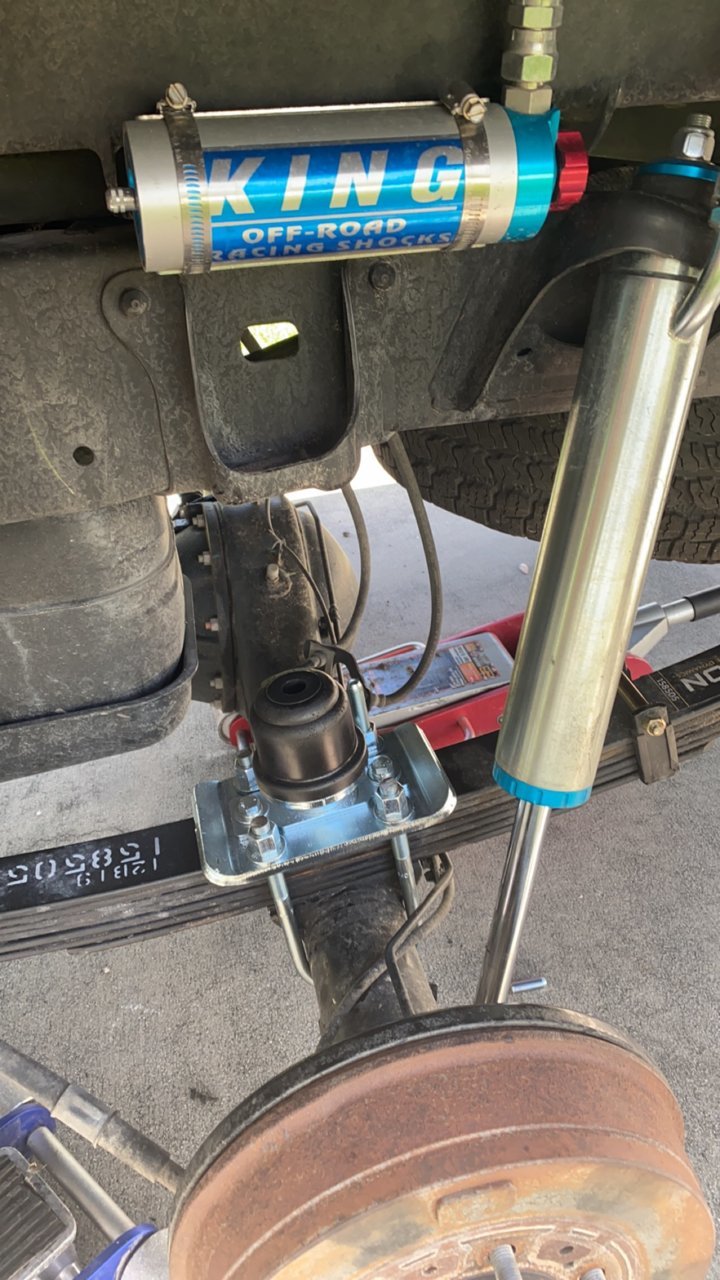

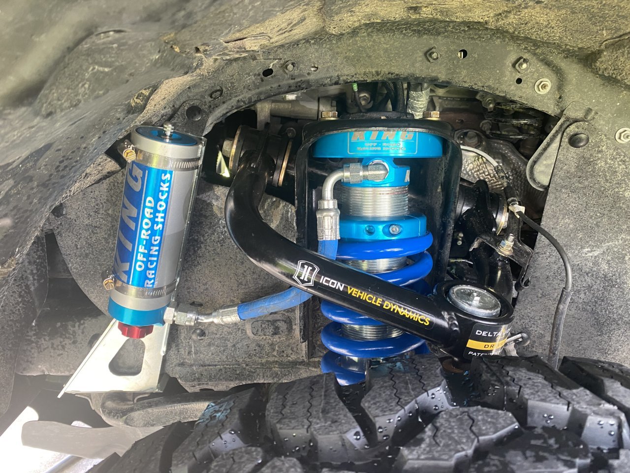

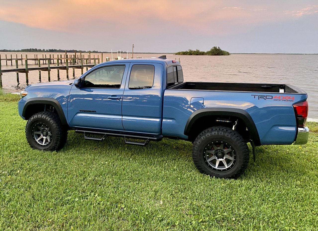

    So, after owning driving the truck for a year and putting 50k on it, I decided to start the build. Any questions about any part of the install, feedback on the suspension, any questions about the u -bolt flip kit etc, ask away.
    So far it consists of
    King 2.5 with RR,
    icon RtX leaf option 2,
    icon delta joint Uca,
    CMC with bay fab cmc plates,
    meso custom smoked blinky things for the mirrors,
    wheelers u-bolt flip kit with super bumps,
    Goodyear duratrac 285/70,
    icon rebound 17x8.5 offset 0
    -rock sliders being fabbed
    -did morel door speakers front rear with Subaru tweeters in dash along 2 12”skar audio evls with a 2400watt amp
    -RRW stealth bumper with hoop on the way
    - haven’t decided a winch yet

    How many turns on the front coilovers did you do? How does it ride with option 2? I am planing to go with option 1.

    Honestly with option 2 some weight helps in the bed to smoothen things out, it’s not harsh but more so then stock. Stiffening the dampening up on the suspension helped tremendously with on road comfort/longer drives. 5 turns is 1 inch(ish) of lift after the settle. I have 12/13 threads showing now. When I had a little rake and less preload, the truck rode better for sure!

    Sorry man I’m late with a reply, king gives you specs for the different spring rates, I recently switched to 700lb springs and have 3/4 of an inch of preload in the front, about half of what I was running for a similar lift with the 600s which were over preloaded to compensate for the sag of the extra weight I added. Truck rides great!

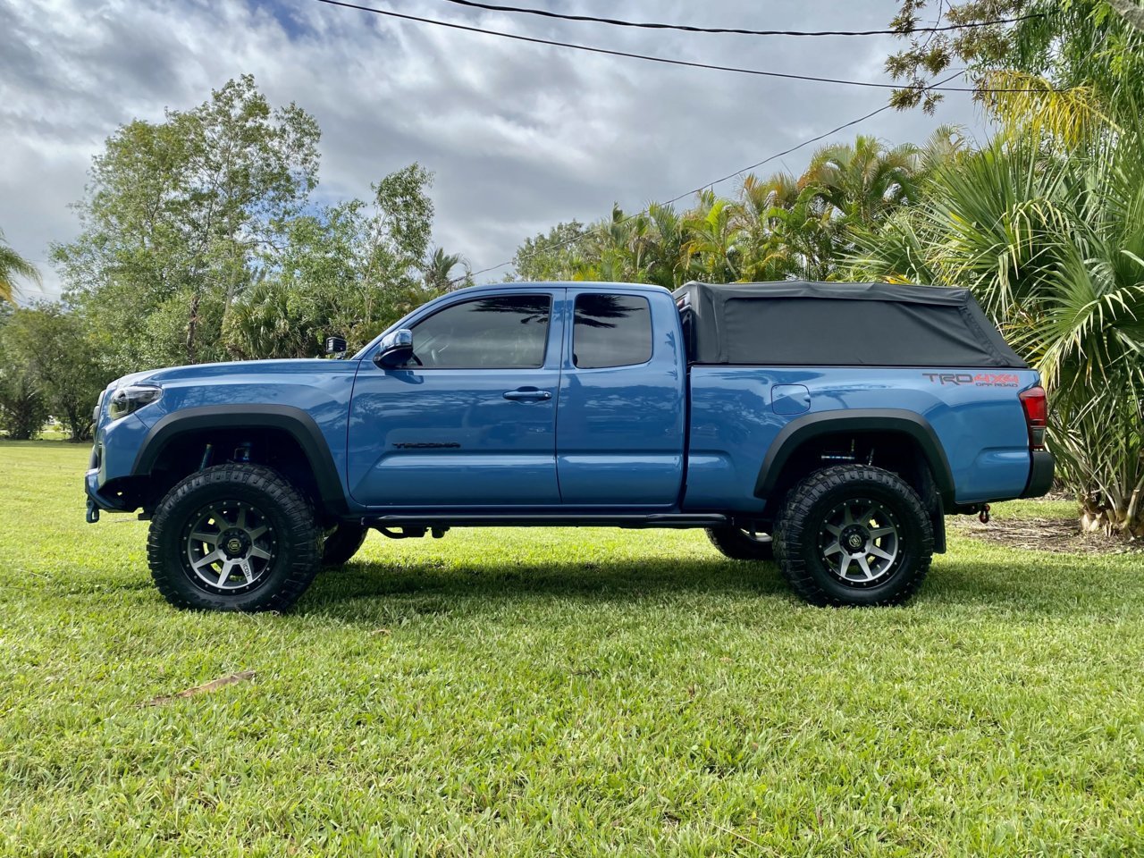

    Truck currently. Added sliders from @Timbo's Customs, 700lb springs, ecgs bushing, the bestop super top, added the bumper and smittybuilt xrc3 9,500. Thanks Tim for the quality work and dealing with me. :D Will also be doing hangers and shock relocation. Tim will also be doing the work! Sorry about the sag in the pic, I have a bunch of weight in the bed.

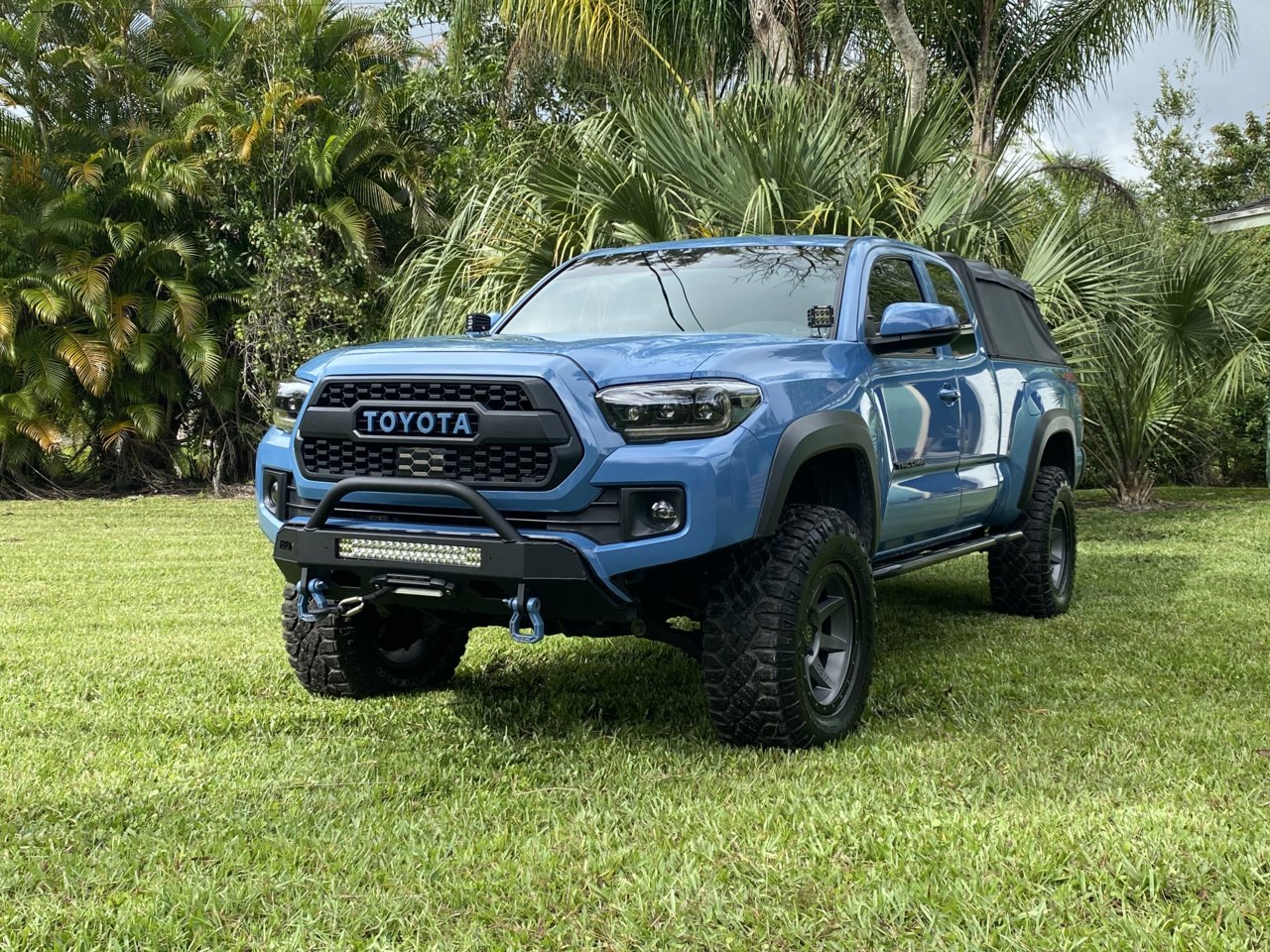

    Front view with the RRW stealth bumper and the high clearance cut, plus everything else mentioned.

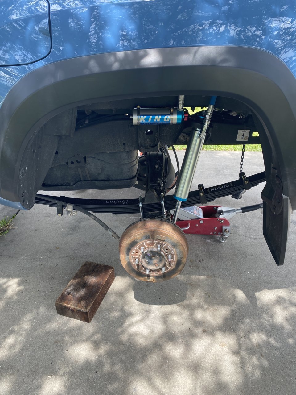

    It’s not built yet... it’s getting there tho. I’m terrible with build threads and posting every modification individually, there’s a few minor things I forgot in the description. I’ll be doing rear hangers and a shock relocation on it, 35s and gears in the future. But, in the meantime, I have a few other goodies on the way. I hope my truck encourages you to start building! It’s definitely fun and a huge waste of money.
