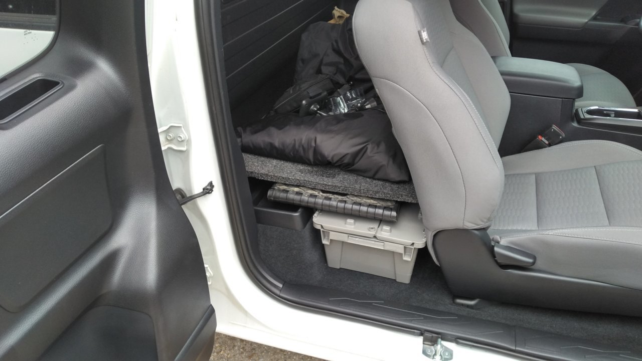

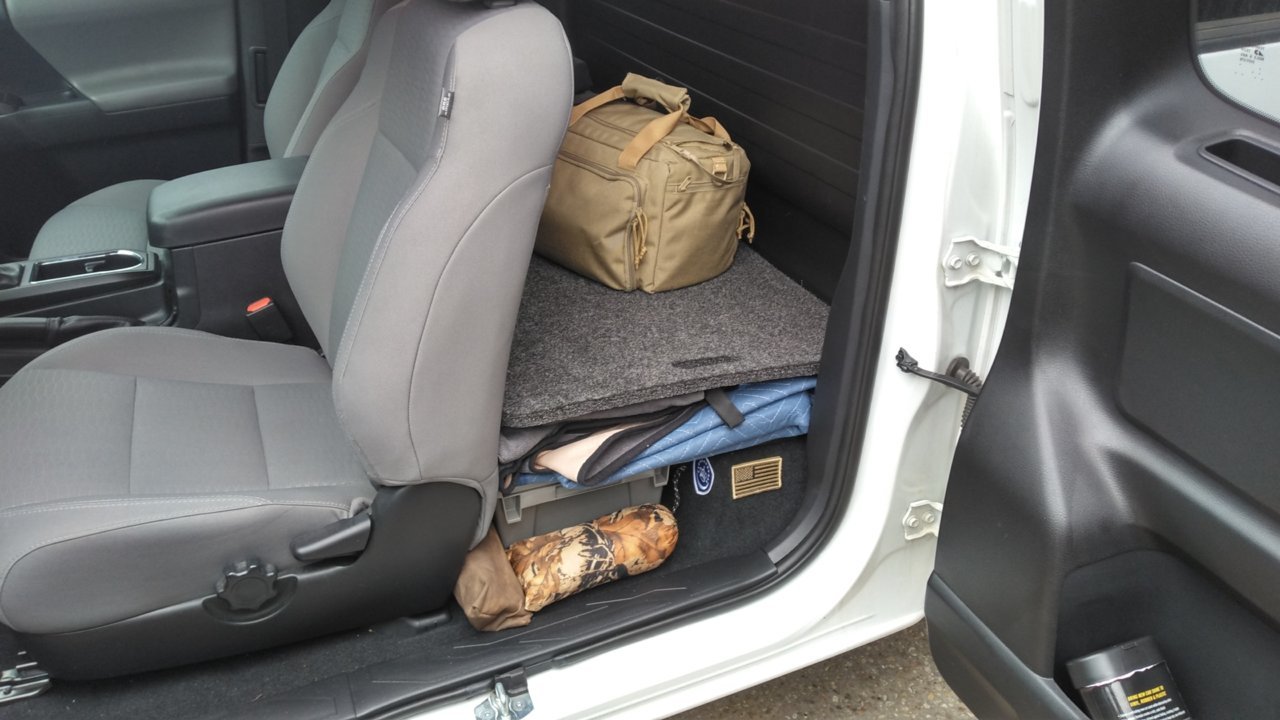

    3/4" Baltic birch ply wood. 26" front to back, 50" wide at doors 54" wide in the back. Front support legs 6.5". I used .75"x.75" aluminum L bracket to support access doors. Countersunk original searbelt mount bolts in original holes. Commercial grade 20" carpet tiles glued with carpet adhesive. 1" webbing for pulls on access doors. Total project cost about $60.
    1/2 sheet plywood = $30
    Carpet tiles (6) = $12
    Footman loops = $8
    Webbing (10") = scrap from old backpack
    Various other items about $10 +/-

    Excellent work! I had wanted to do something similar with access still available to the storage compartments, so this will be a huge help. If you used only a half sheet of plywood you must have pieced it together somewhere to get. a 50 & 54” length, but where?

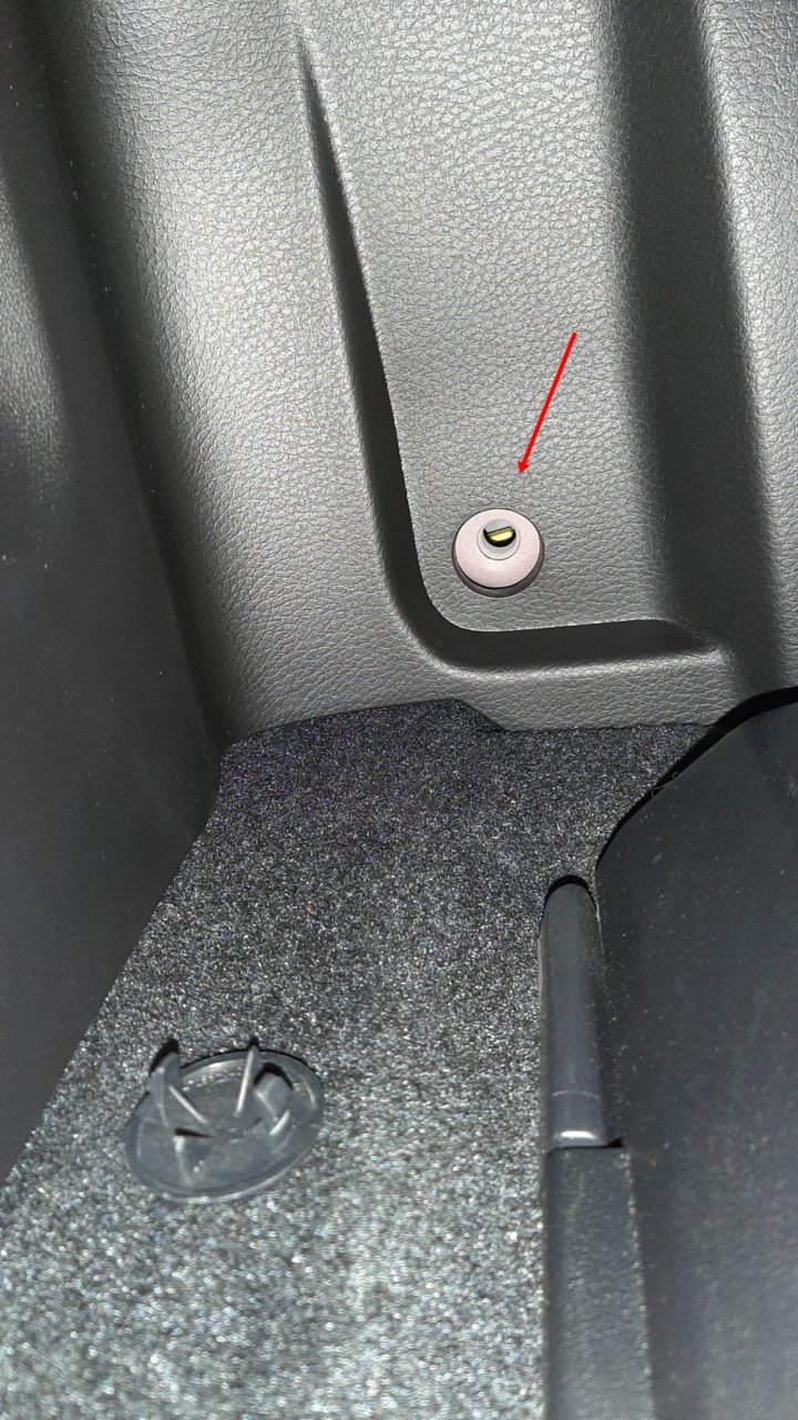

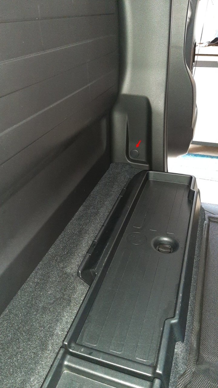

    I am in the planning stages of the platform and was thinking of incorporating the seat belt holes in the side panels. The holes will accept a threaded bolt--I know this because I bought some to try--and was thinking about using them to be able to lift the entire platform like a hinge or pivot instead of having the cut outs to access the existing storage. I would somehow attach the platform's 2 rear corners so that the entire thing lifts up towards the rear window. Trying to come up with a way to do that right now. Hope this makes sense to everyone and would welcome any other ideas.

    No, it is one piece. I started with a full sheet of plywood (48x96) and cut a piece from it @ 26"x54". I purchased the whole but used only half, so I now have a piece left over that is 22"x96".

    This is very clean looking. What I will do with my access cab. I'll use only one support leg under the middle section however, so I can still stuff items in the passenger footwells.
