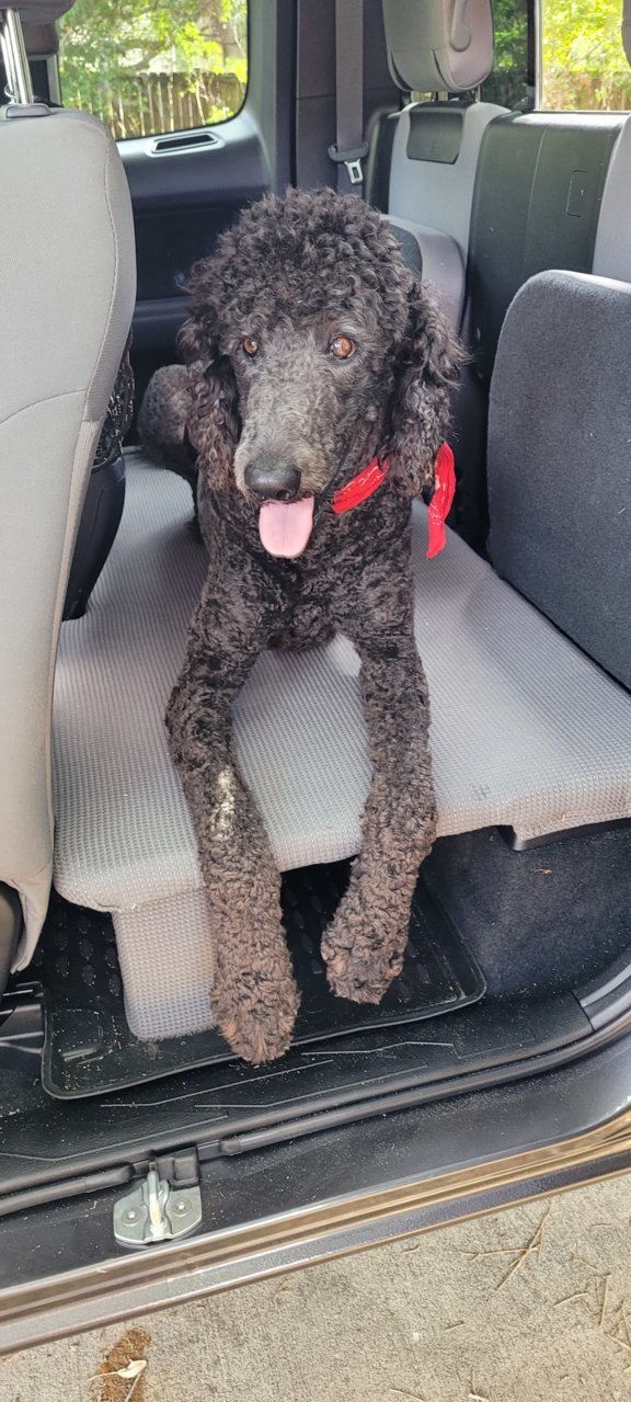

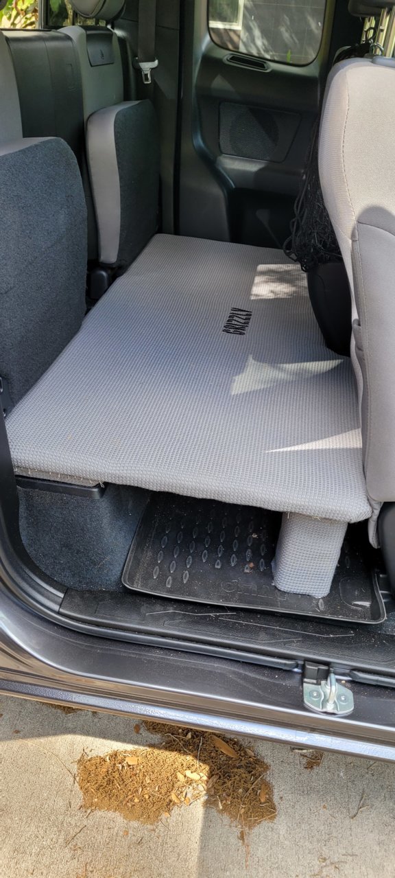

    grocery type baskets fit exactly level and support weight across the length of the plywood.
    they slide like drawers on carpet back floor.
    scrap of plywood on hinge hooks to keep shelf from shifting around.
    ended up buying an outdoor lounge chair pad from the thrift store to throw down for the dog
    cargo net hangs from bolts/fender washers in factory bolt locations
    not fancy but it works.

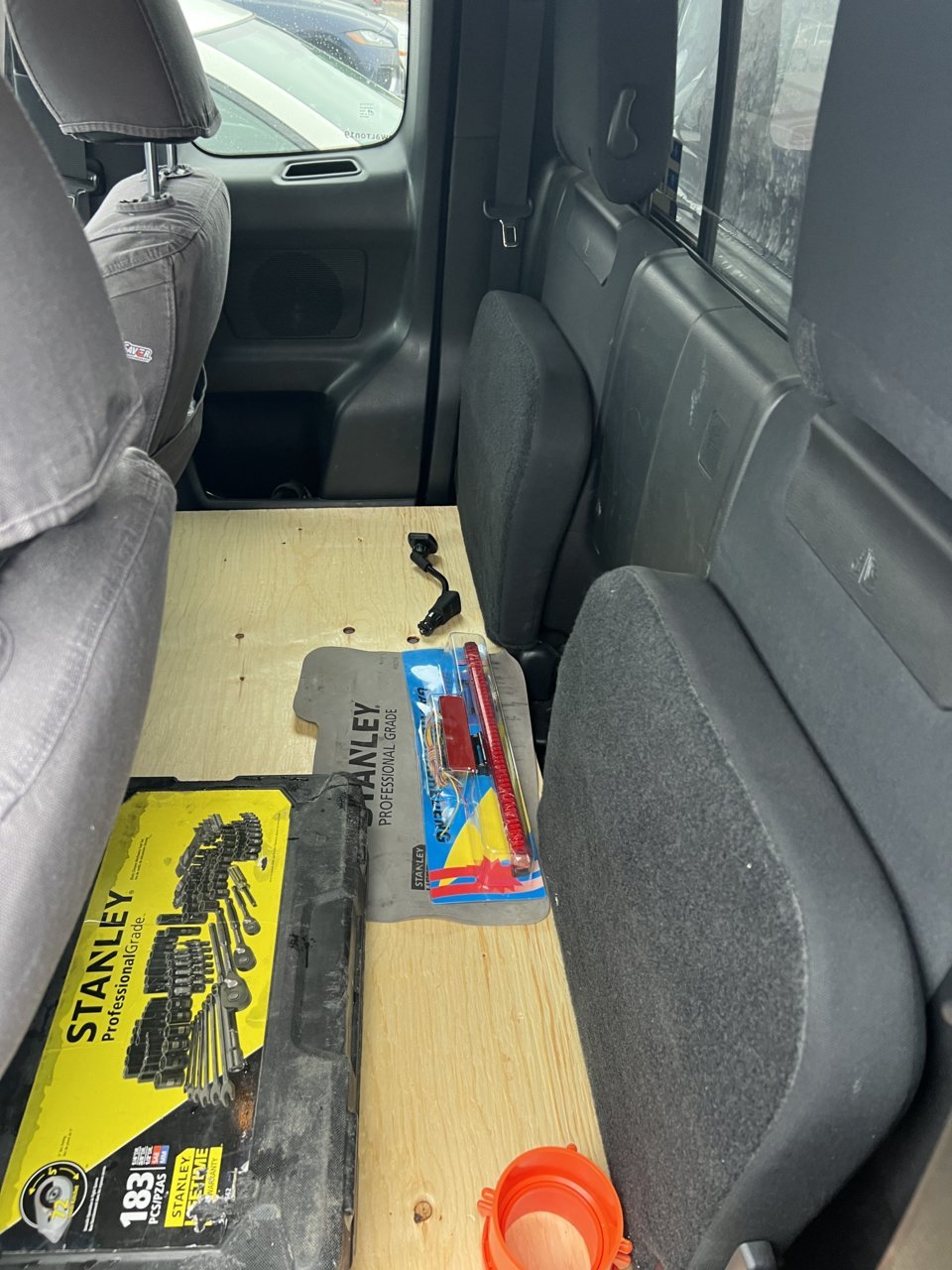

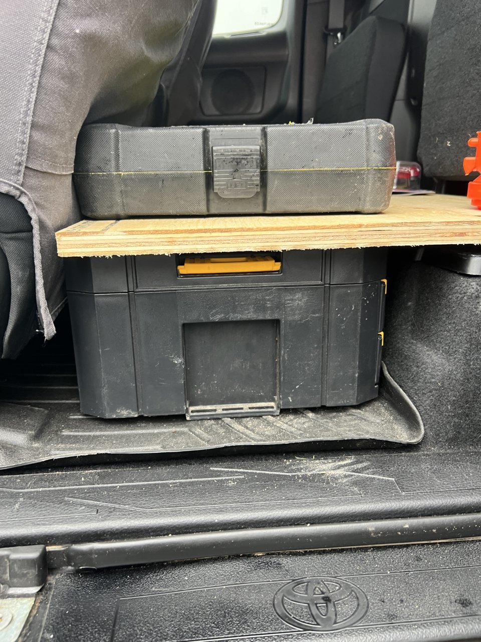

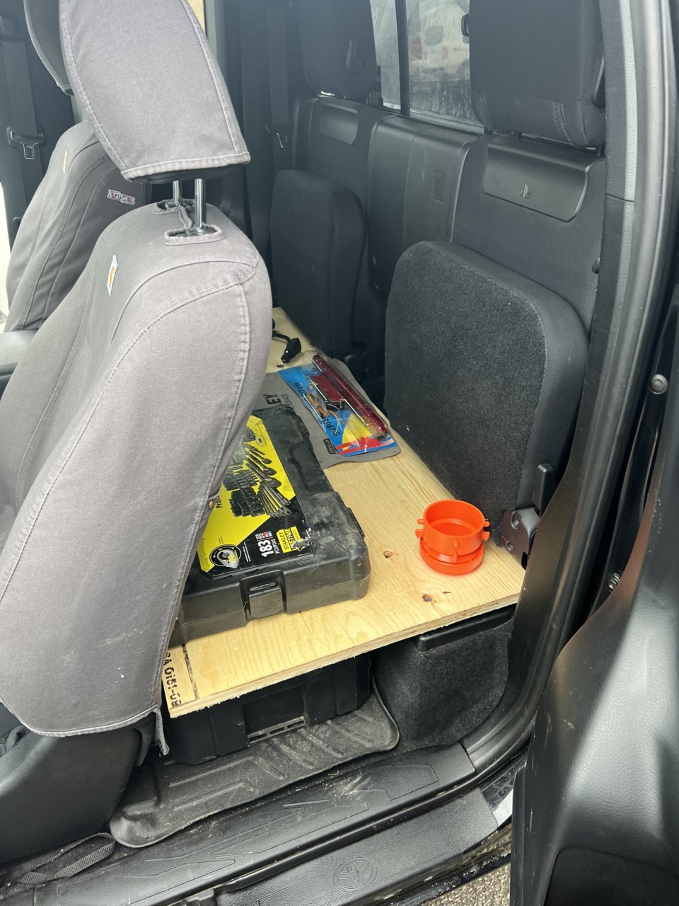

    Built my own, budget version. Goes between the seat brackets with an extremely tight tolerance, and rests on the Dewalt toolboxes mentioned in here. Gonna carpet it when I have the time. Total cost? 72 cad, including being cut to fit.

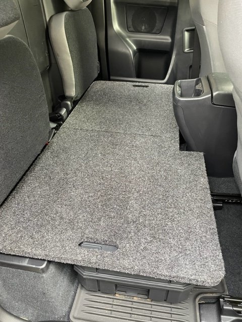

    Another successfull install. Kudos to the person that came up with the bed rug and dewalt tool box idea. Saved me a ton of money and looks greatIMG_2271.jpg .
