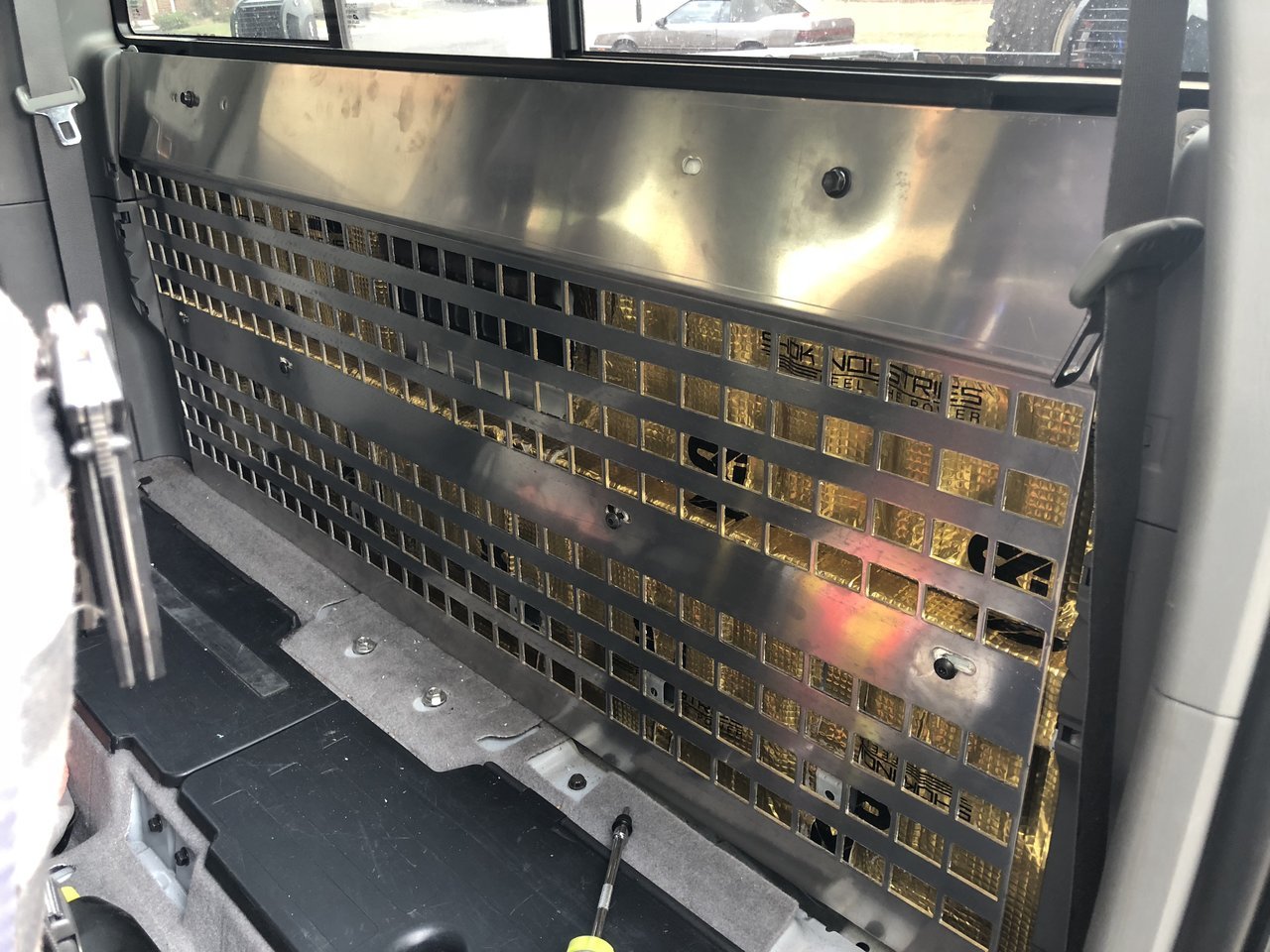

    I removed my rear seats, since no one sits back there anymore. I installed @docloco molle panel. I plan on adding a platform there, but currently stuff is just flying around.
    I have a 2010, but I traded the under seat covers with someone with a 2005, so they go all the way across (where the center console would have been)

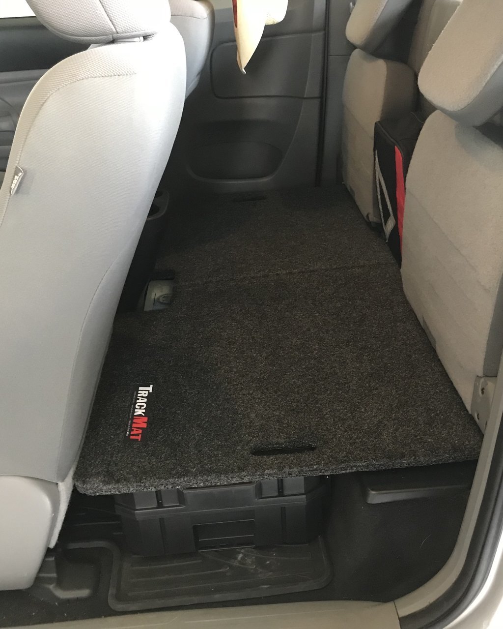

    Finally got around to finishing up with mine. Turns out a trackmat fit width wise perfectly. Just need a little bit of a trim to work around the center console.

    For those using the Dewalt boxes, can the front seats be slid all the way back?

    I’m not 100% on all the way back but I’m fairly certain you can. On my picture the seat is where I drive at and you can see there is still a decent bit of room before there’s any chance of running into the toolbox.
