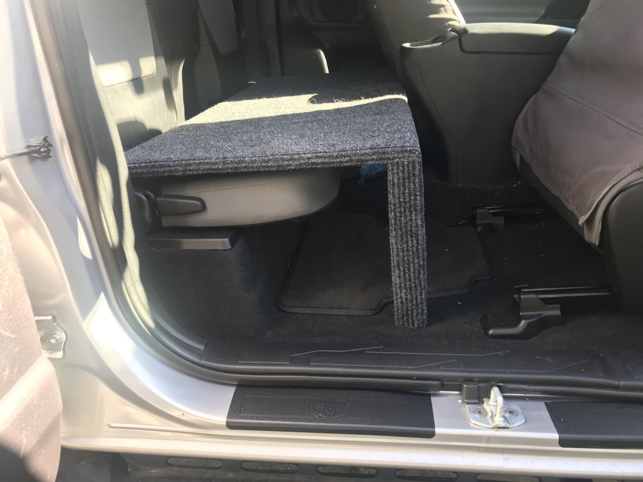

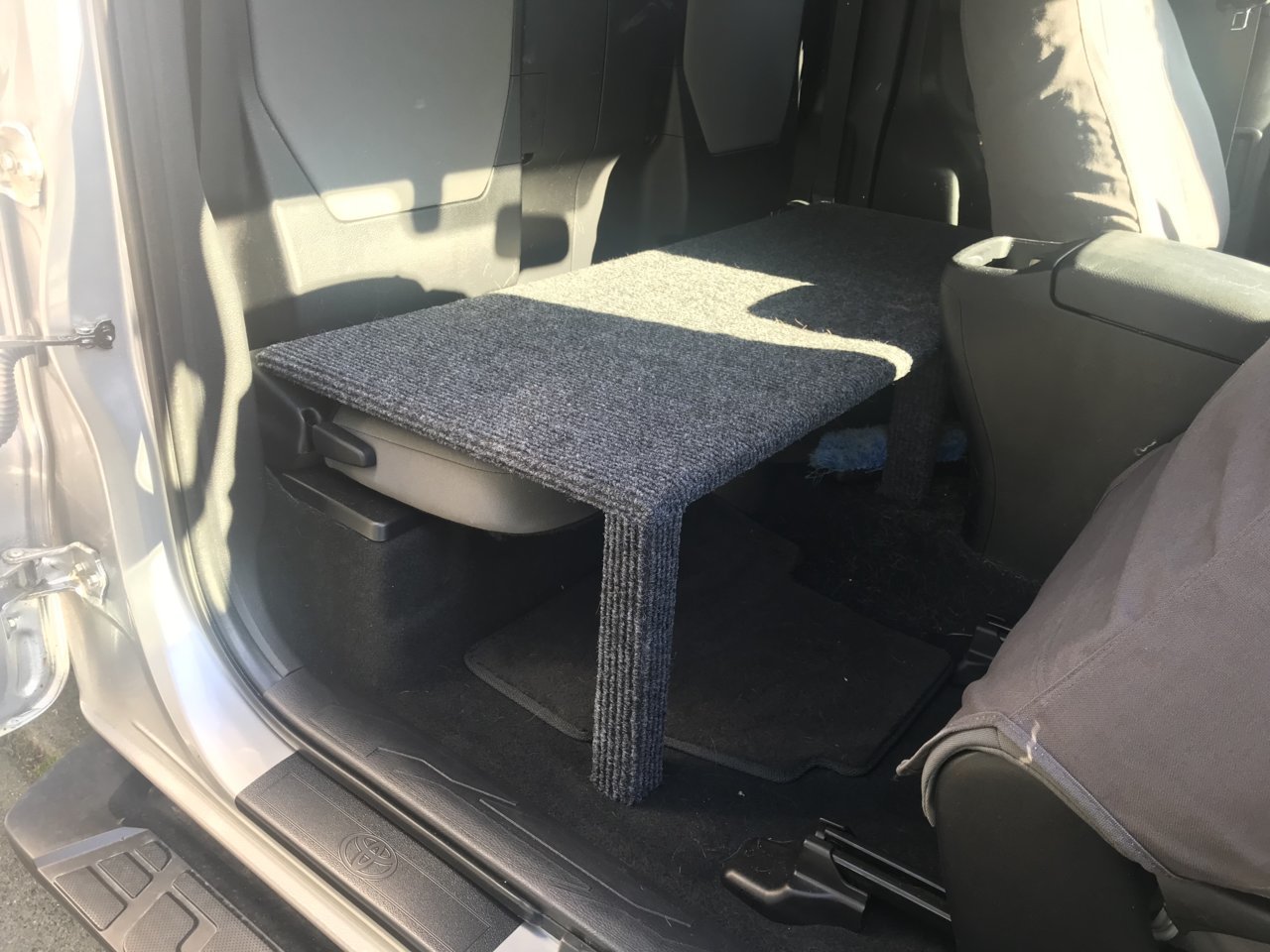

    So after reading the info and seeing just what it's going to take to remove the useless baggage I thought to myself,
    "you know, those 'ol seats and headrests aren't so bad after all.
    I decided the platform route was the way to go.
    The base sat directly on the seat hinges and seat cushion and was perfectly level.
    Used 3/4" ply and made 90 degree corner legs with a full length stringer to eliminate flex.

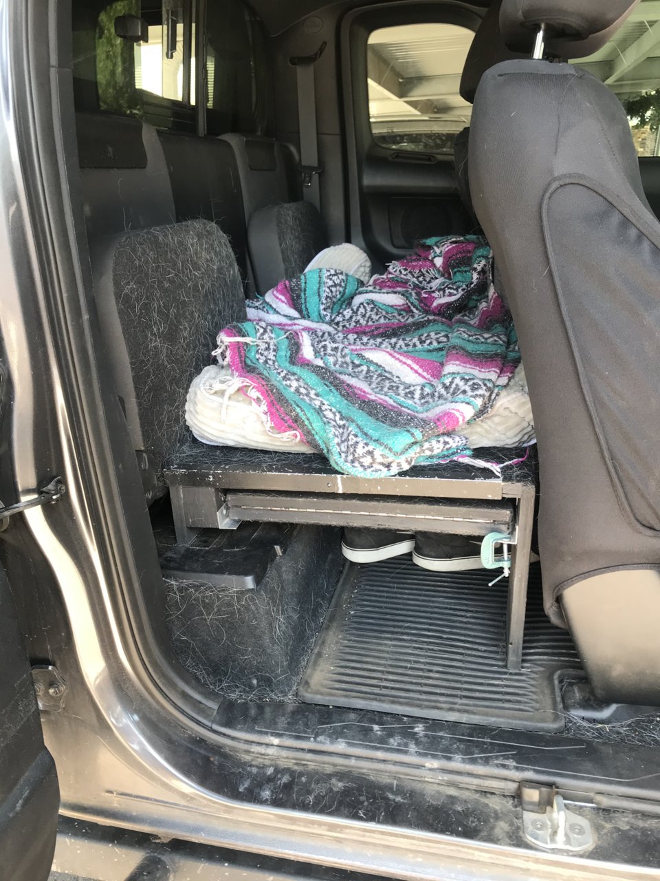

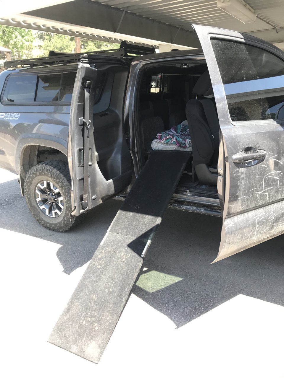

    I wanted a ramp for my pup after we found out that he had a large cyst on his kidney that could burst from too much activity (jumping in and out of the truck). I made a ramp that folds in half and stores under the platform. here is what I camp up with. (please ignore all the dog hair) the ramp can also be used on the tailgate.
    Let me know if you have any questions about how its built. Building a folding ramp that can support a 70 lb husky proved to be somewhat tricky.

    This is what I’m talking about, awesome!
    it looks like it’s hinged in the middle and slides underneath?
  12. Jun 16, 2020 at 2:01 PM
    #172
    TheTacomaInn
    TheTacomaInn Well-Known Member
    Oct 3, 2017
    #231882
    236
    Rob
    Littleton, CO
    17 OR Access Cab, OME 887,HD Dakars, 285s
    Yup exactly. I had some issues with the hinges being able to hold it in the open position. I added some angle iron that extend past the hinges so that when its open it doesn't let it over extend

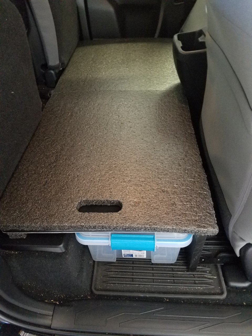

    My revision (after removing the seats and putting in a utility panel, along with soundproofing and open cell foam in the vents):
    I changed out one of the DeWalt toolboxes for a Sterilite drawer. I found I was always having to move the seat forward, take whatever was on the Bedrug off and put it on the passenger seat, pull the toolbox out, and then repeat in reverse order to put it away.
