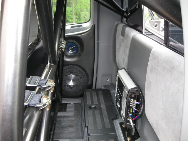

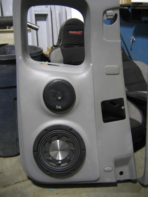

    Xtreme Kreations access cab sub boxes:

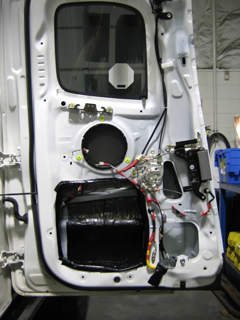

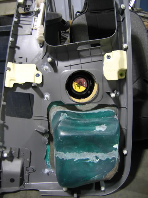

    Some work is needed to set them up:
    Open up the doors a bit:
    They end result didn't work with my cage so I free-hand jig-sawed the speaker mounts, flipped them over, and re-glassed everything so the speakers were recessed rather than raised:
    End result is dual 10" subwoofers with dual 6.5" full-range speakers in the rear. These things don't rattle at all.
