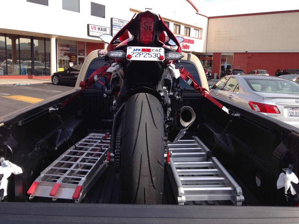

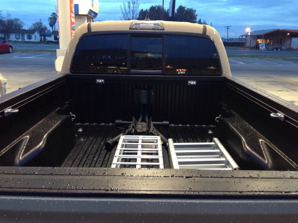

    I appreciate the help, but I'm already familiar with the track system as my Frontier had the Utilitrack system on it.
    Not sure what you're getting from my posts and I don't want to sound like a dick, but you're simply stating the obvious. I'm using the mounts that I bought for my Fronty as I didn't like using the cleats that came with it either. However, since the track dimensions are different, I can't mount it the same way. On my Fronty, I could install and remove the mounts like the cleats, except it was with an allen head bolt.
    If you search these boards, there's a lot of info on the t-slot nuts people have used. Only downfall with those is that they slide along the tracks and can only be removed/installed from the ends. Another option would be to grind down the spring nuts that came with my mounts to fit the Taco tracks. I read on here that one member did that. Might give that a shot down the road just to make things easier for install/removal.
    Here's some pics of the mounts I'm using, they're from CCR Sport. I'll get some pics of the t-slot nuts and spring nuts I'm talking about later.

    Miscommunication is all. Nice setup.
