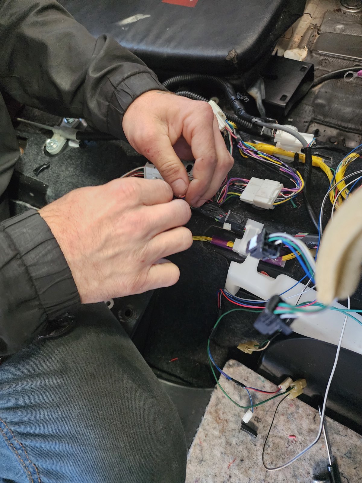

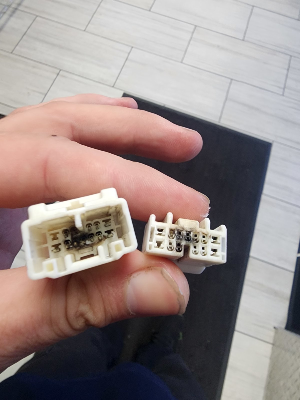

    May or may not be related, I work at a used car dealership and ran into this same problem with a 2010 venza. Took 2 days to find it but here is what I found under the center console. I found that if I put a phone charger into the 12v socket it would shut everything off for a couple minutes then go back to being broken. Noticed wiggling the wires it would allow it to pop back on when we found the burnt connector directly underneath the cup holders.

    Crazy. And there wasn't a popped fuse from the arcing?

    No fuses popped at all everything acted normal just same symptoms of being stuck in accessory mode, I verified it with a scan tool through the BCM it showed acc sw: on all the time. Ended up taking the power wire to the 12v socket and grounding it out with the key off of course or it will pop the fuse and it shut everything down. That's when it was found it was in the same harness.

    Thanks for the scoop. I'm going to start looking at connectors I have easy access to...

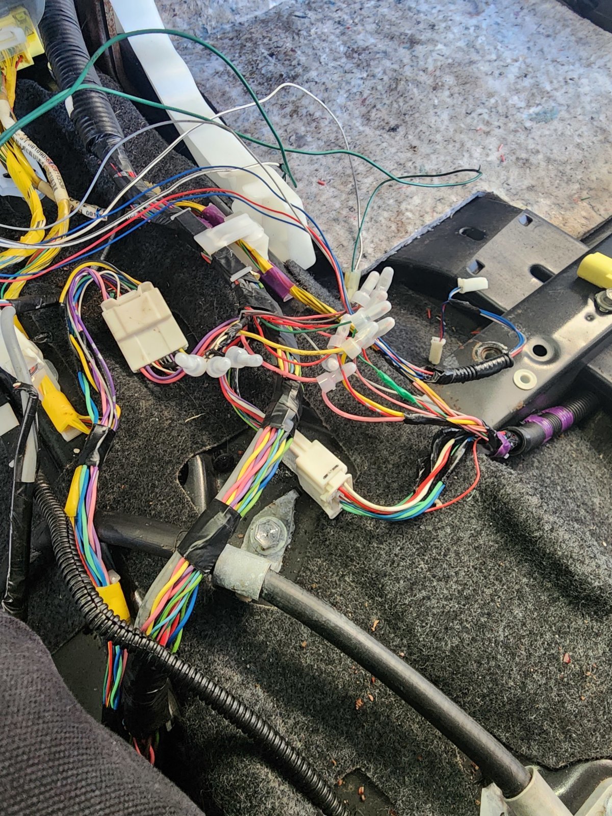

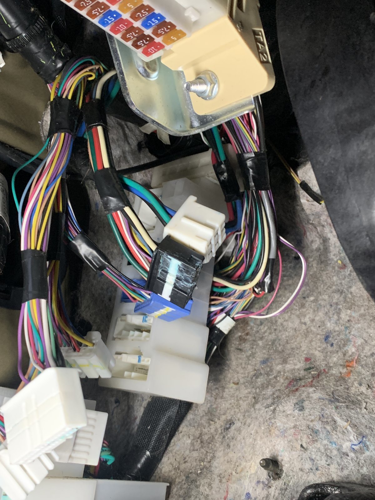

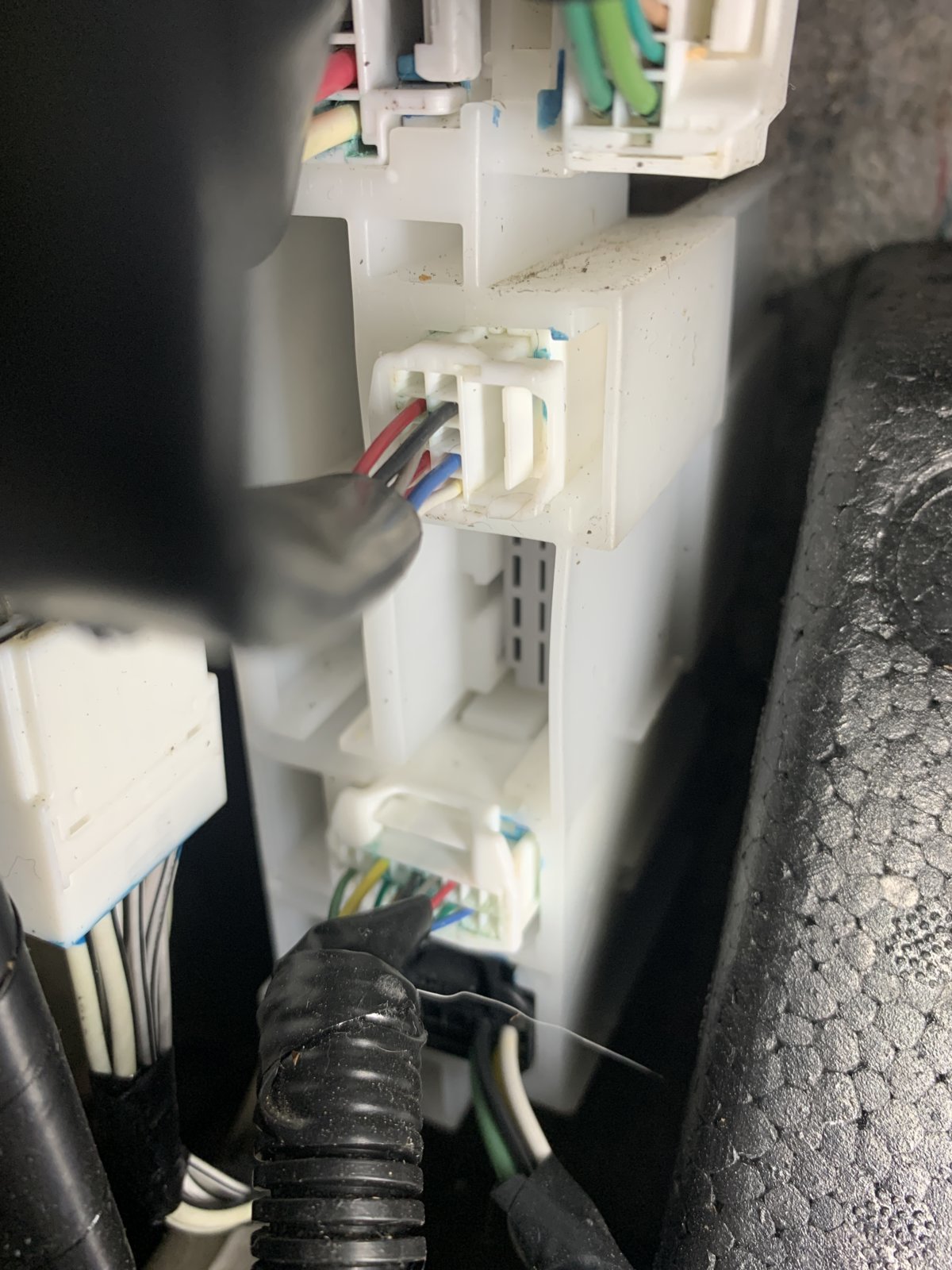

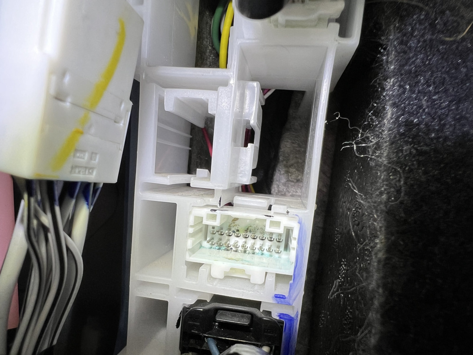

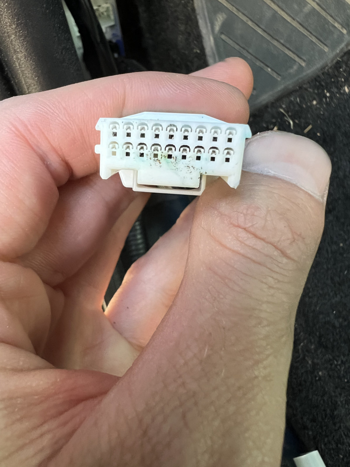

    Update. Haven't had issues in about 6 weeks. Finally got some time when it was nice out to take apart the covers and look at connectors.
    There's unfortunately some corrosion on this batch of connectors. (Anyone know their official designations? I can't figure it out from any of the service manuals.)
    The one at the bottom was the worst (which also powers the dashboard), so I cleaned the male and female ends with baking soda + IPA, let it dry, plugged it in, and electrical tape wrapped around connector.
    Also of concern was underneath my footwell was water, absorbed by the insulation. There's a leak somewhere, and not sure where. The dealership has noted windshield leaks in the past on non-OEM windshields, so I might look to get that replaced. Inspection of the rest of the interior near the firewall (and in the engine side) doesn't indicate where the leak would be coming from as there is dust most everywhere. Unfortunate, but kind of relieved I found a smoking gun.

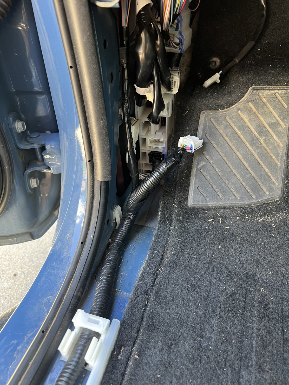

    I have not had the issue come back since I've cleaned my contacts. A few things to note though:
    It's now warmer out where I am since I've done the cleaning, and I was (at the time) really speculating temperature was a major contributor.
    It also hasn't rained much, or had bouts of persist precipitation or snowmelt (e.g. it's not snowing for a day, or snow melting on my truck for a few days afterwards. Best we get is an afternoon thunderstorm).
    I periodically check the wetness of my driver's floor mat, and it appears fine.
    I'm fairly confident I found my issue with this. The root cause I've heard could be the windshield. The Toyota dealer I contacted asked if I had the original windshield - I do not. They have seen problems where people have their windshield installed incorrectly and it provides some path for water intrusion. Maybe check this first, and then start looking at your connectors?

    Dude this was so helpful. Just checked the connectors in the drivers floor area. Connectors had a pretty good buildup of corrosion. Luckily no pins seemed to be damaged at all. I was able to clean it out really well. Sprayed some wd40 on the connectors after everything was clean and dry and put it all back together. All the radio and door lock problems are gone.
    Only bad thing is now my “Service stability control” warning is on. Which tbh I’m not too worried about. I’ll put my scan tool on it at work tomorrow and see what she says.
    But for real thank you. I buy Tacoma’s because I don’t want to have to fix my own shit after fixing other peoples shit all day haha. Hopefully this is the end of it
