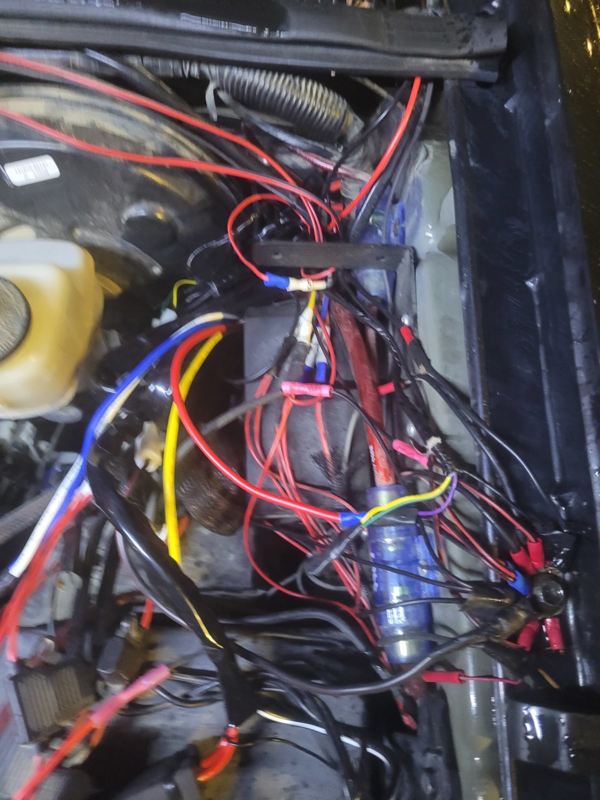

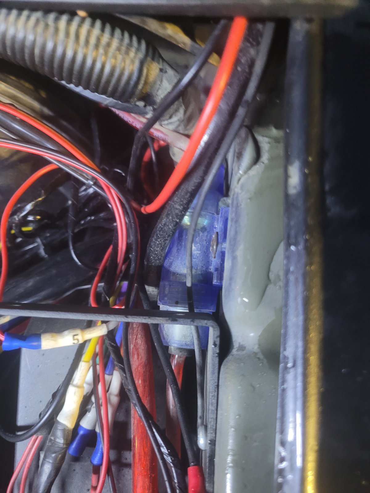

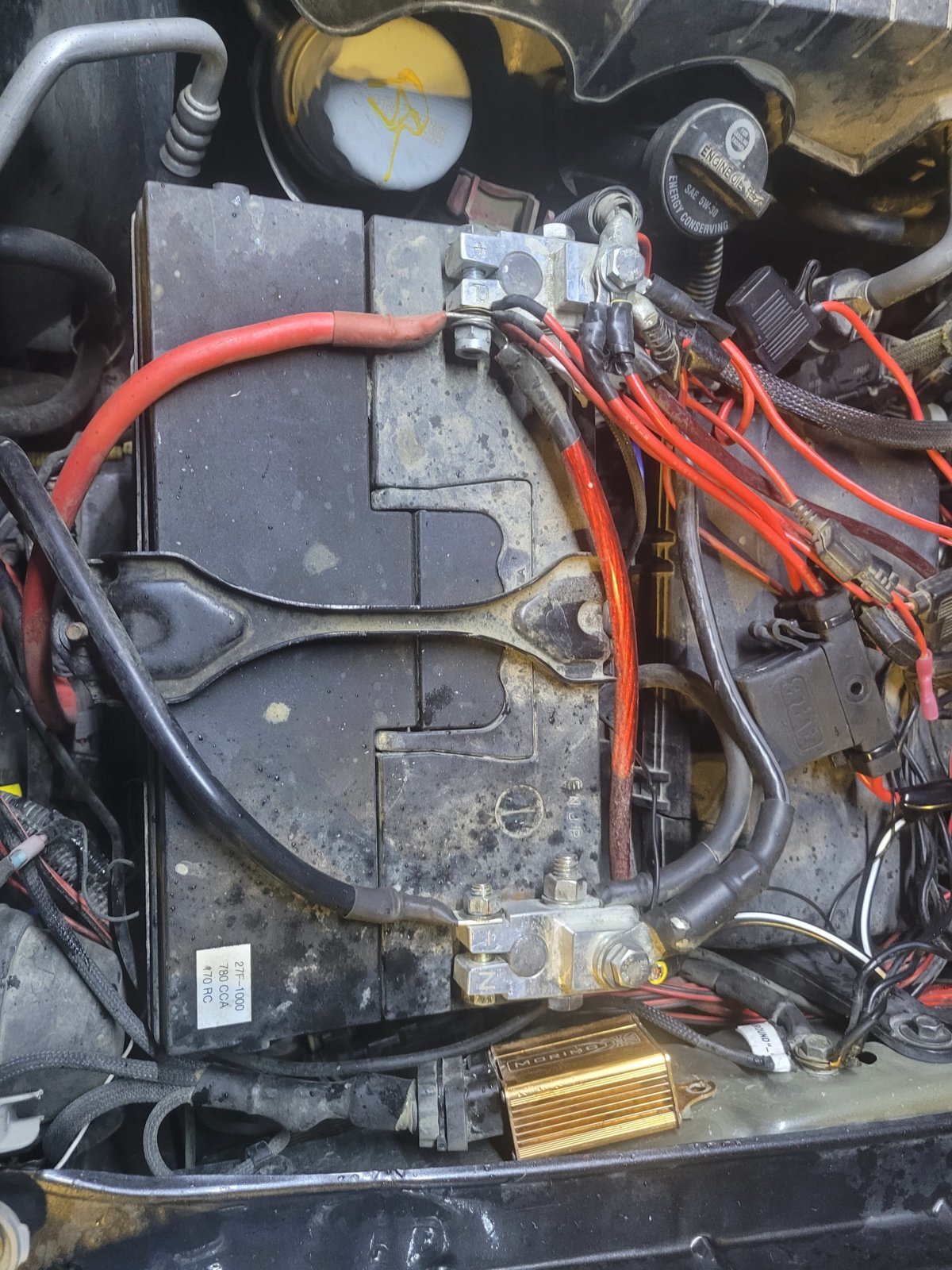

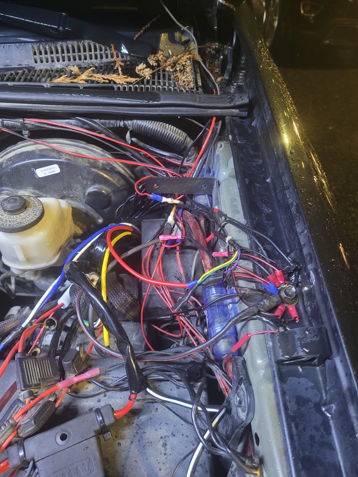

  4. Feb 28, 2024 at 6:00 AM
    tbraumb11
    tbraumb11 [OP] Well-Known Member
    Nov 13, 2019
    #310580
    342
    nanaimo
    2015 tacoma double cab magnetic grey
    what are those?
    Before I post these remember I know it's a mess and that's why I'm asking for advice to fix it.
    The only things wired directly to ground terminal is winch and compressor because that's how they say to do it in instructions.
    There is a ton of extra wires from compressor harness stuffed in top corner away from engine and the switch panel itself is screwed where I used to have a relay holder on factory bolts.
    I'm upgrading to a group 31 battery with battery booster soon and also need to clean up the area to do my sequoia master cylinder upgrade to match my big brake kit soon.20240228_054744.jpg 20240228_054718.jpg 20240228_054713.jpg 20240228_054704.jpg

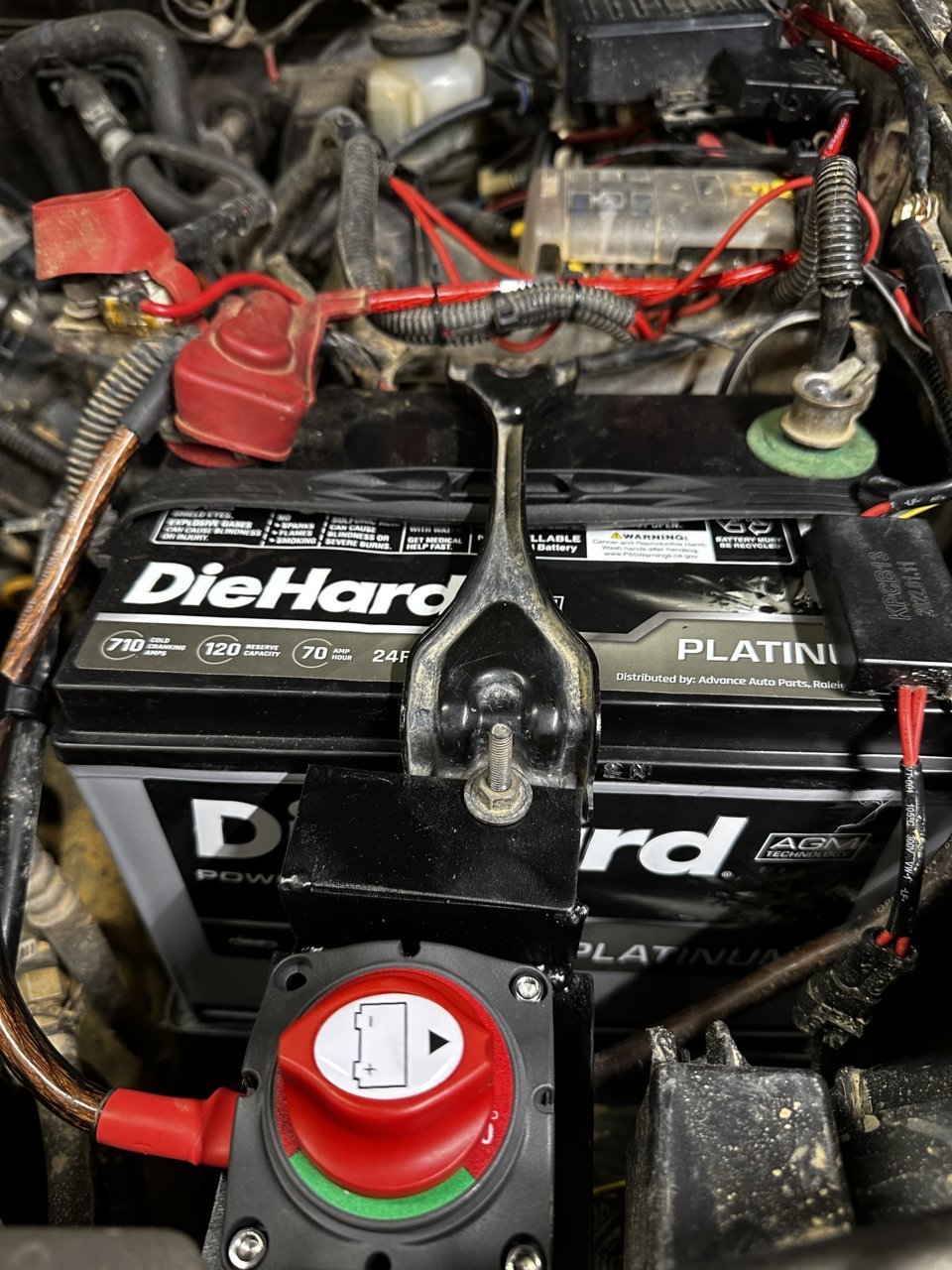

  8. Feb 28, 2024 at 7:01 AM
    Brian422
    Brian422 I fell into the pit that is TW
    Jun 8, 2011
    #57958
    15,517
    Brian
    Birmingham, AL
    2012 DBCSB F/R Locked, 35's ,Long travel, 23 Tundra 4x4 limited
    Not Stock
    Fuse block is your friend. Top pic the one in in my taco. Just dont have a good pic. I have more accessory's then you. I also have a Aux beam switch controller which you can see in pic as well. Cleans everything up nice. One of the first things i did to my Tundra was add the fuse block to clean up future wires.

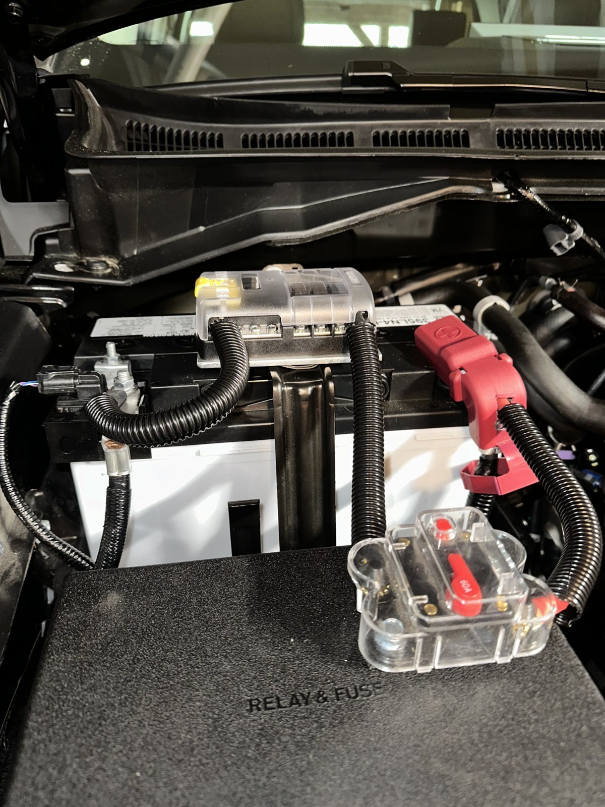

  9. Feb 28, 2024 at 7:06 AM
    EMR
    EMR Well-Known Member
    May 13, 2009
    #17171
    484
    So Cal.
    2012 Tx Pro
    BabyBilly, mtip and Brian422[QUOTED] like this.
