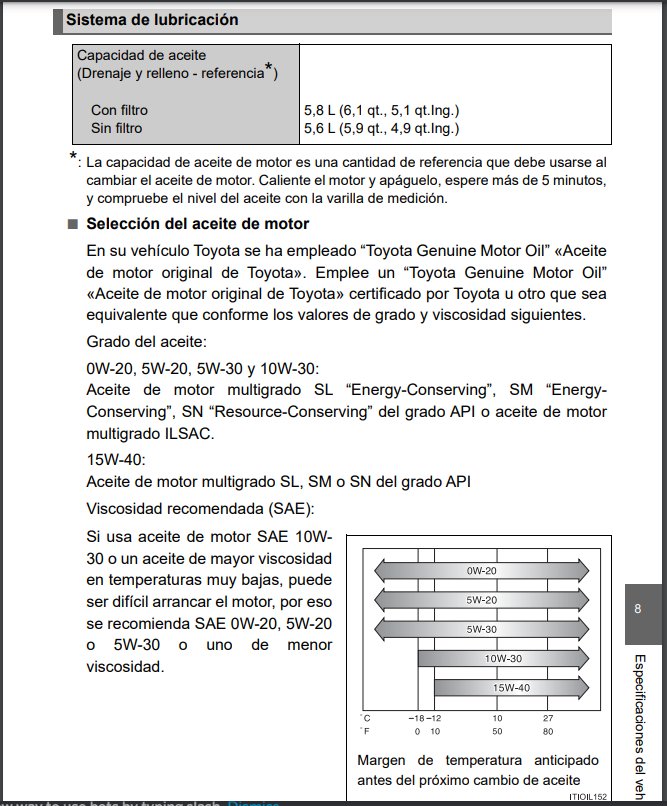

    You can use 5w-20 no problem. Take a look at this chart from a Mexico Tacoma, all the weights listed are expectable including 15w 40 provided you stay in the temperature range.

    Zero harm. But unlike 0w20 which are all synthetic, 5w20 can be conventional, synthetic or a blend. If it's a conventional or blend change it in 5k miles. If it's a synthetic you can go up to 10k if you choose to do so.
    And the difference between 0w and 5w in cold temperature starting is negligible. Air temps would have to be -30°F or less to begin to measure the flow difference

    The manual even practically says that

    Does the English manual actually say that?

    It says "an oil of a higher viscosity may be better suited if you operate vehicle in blah, blah conditions".
    Obviously that's not an exact quote. But that's Toyota's way around the EPAs mandate that the oil that the engine was certified on is the one that has to be recommended......not required
