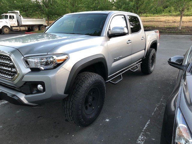

    Hello I'm new here and I read some of the threads on Fox 2.5 coil-overs. I have purchase the Fox 2.5 coil-over reservoir through 4Wheelparts in Oregon with the 05-up Tacoma Tubular UCA DJ kit from Icon where I can adjust the front to have a 3-inch clearance. Now 4Wheelparts here in California say I can’t adjust it at all. Will I lose caster by going up half of and inch? tacoma.jpg
