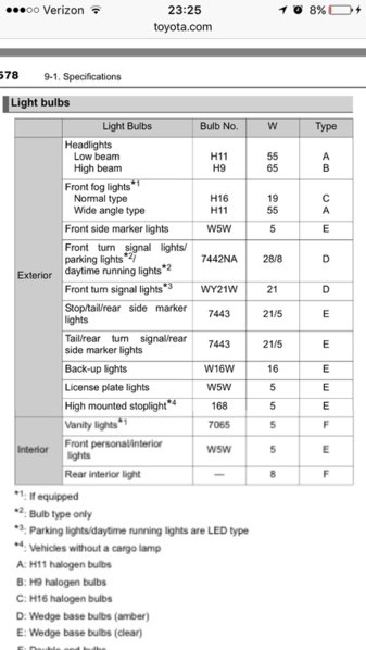

    Thanks Sam B. I pulled mine and it said H16 on the bulb. The H16 is not as long as the H11, so I didn't want to order the H11 LED replacement and it didn't fit.

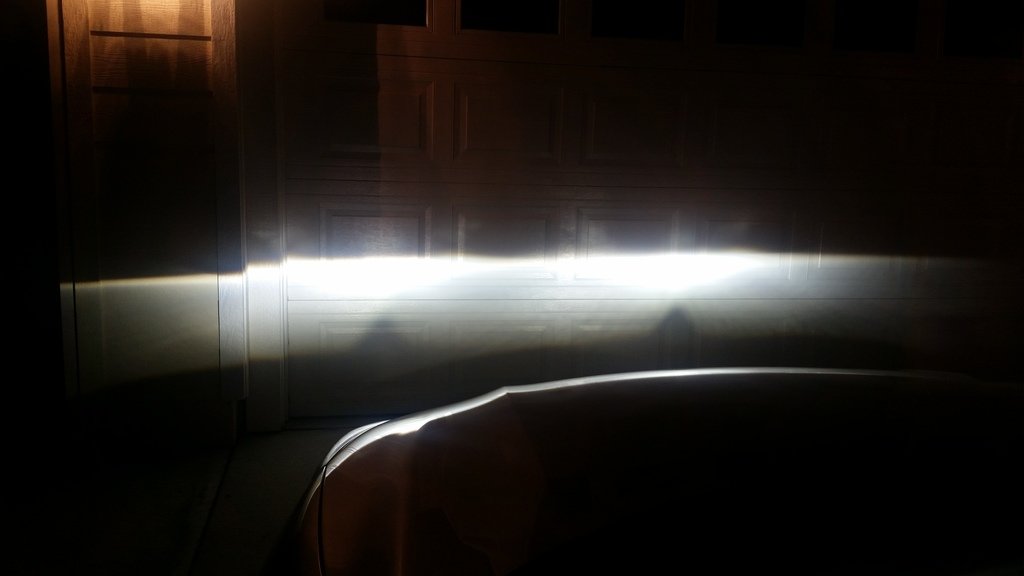

    Just installed these Philips H11's (they fit H8 and H16 housings as well, yes the plug is the same also) into my dad's 2014 projector equipped Accord yesterday. I see no problems here.

    You will once you get on the road. The light spreads instead of projects.

    Yea, VLED's are top of the line. Geothermal H-11. H-9, H-11, H-16 all interchangeable. When installing VLED, run the collar all the way to the base (fan) then adjust out slightly to fit. You want the LED's side to side when they are installed. The line on the end cap should be vertical.

    Just got a call from my dad. He finally drove his projector equipped Accord tonight. He told me, and I quote, "I just wanted to report to you that these new headlights are AWESOME they look great. They remind me of Xenon headlights, they have a nice sharp cutoff to them unlike the old ones."
    He mentioned he was weary of them at first because he thought eh, they are aftermarket, but they definitely let him see the road real nice now. I just gave them to him as more of a safety item than anything but I am glad to hear he is enjoying them. Just figured I'd reply back to the thread.
    If he's happy I'm happy. :)

    Sam, Are all H9 H11 H16 interchangeable or just the VLEDS?
