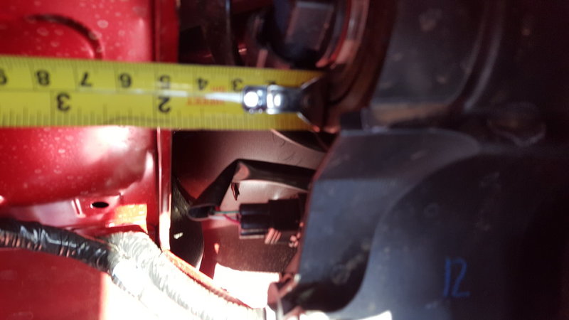

    About 2" from light housing to the frame.

    Yea I just looked at a 16 today and saw that. Terrible place for the bulbs. I would be willing to take the housing out if I had to but worried the fans won't clear

    We will soon find out. Also would depend on the LED mfg. Not a fan of plug and play HID's. (speaking from experience). If the VLED's don't fit then going with high end halogen's and use the LED's in the high beam.

    It looks like it's going to be tight Sam B, I hope it works because that is exactly want I want to do, thanks for keeping us updated!

    question for you Sam - do you think this is doable (low beams) by removing the housing? also wondering if there is a different LED brand that might fir better even if its a minor tradeoff in brightness?

    There's multiple led brands that have different cooling systems. Personally I think the higher end ones with the fans is the only way to go. The VLEDS system has two LMZ chips on each side. The LMZ chip is 4 diodes so that's 16 total as opposed to the other LMZ ones I saw that had 2 chips total. Half the diodes so I'm sure they won't be nearly as bright. Quality doesn't look nearly as high either but I think they do have a warranty. I was thinking the same thing. Remove the housing for install if necessary. I emailed VLEDS to ask the distance between the back of the collar to the back of the cooling fan housing to see if it will fit from a dimensions perspective
