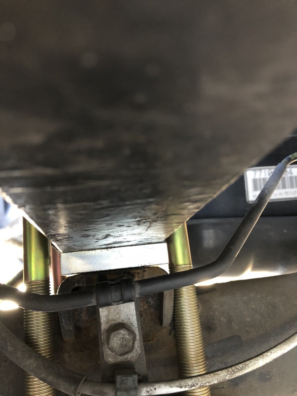

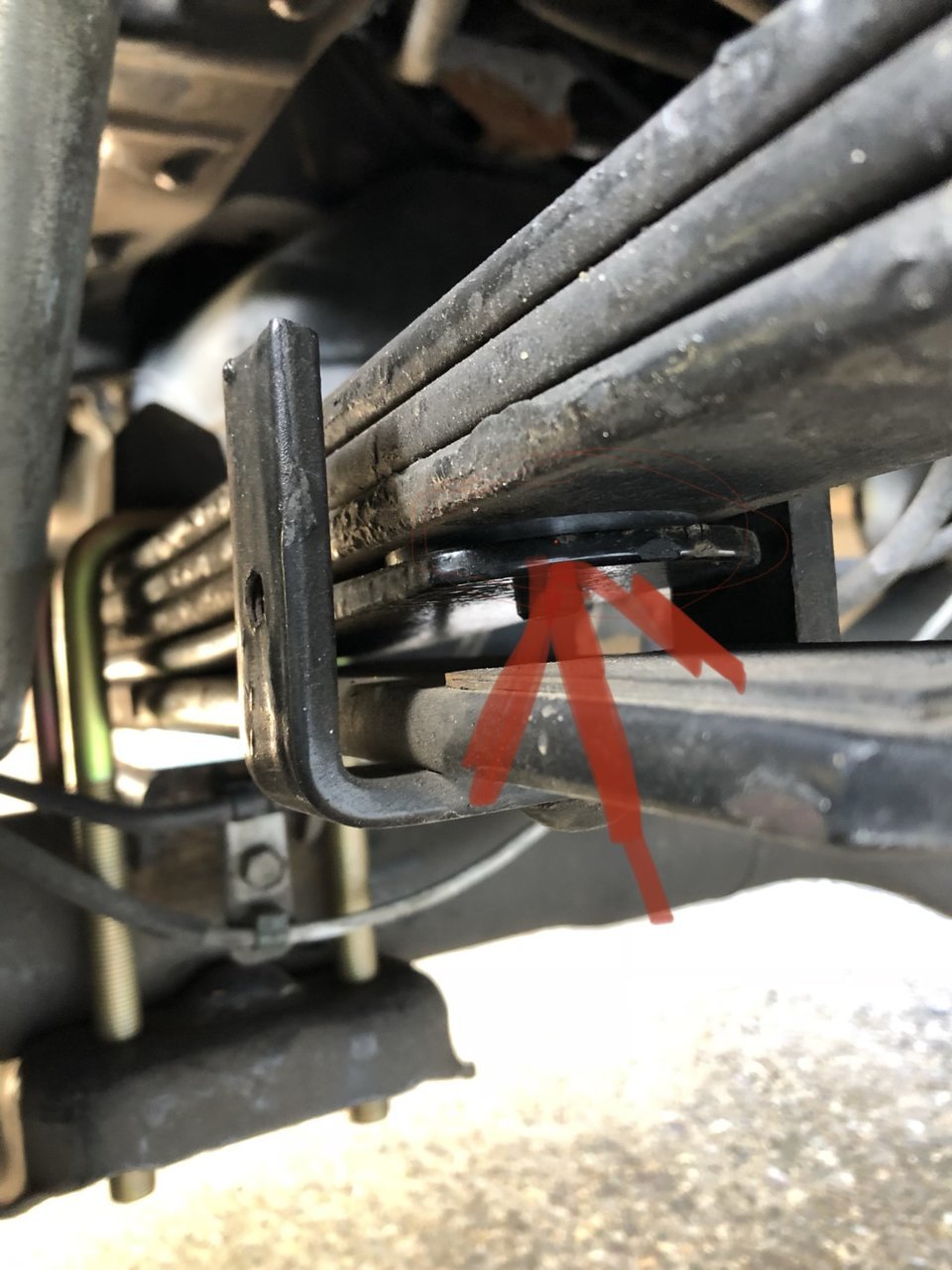

    1.5 AAL, 9 inch U-bolts and 3 degree shims with longer center pins and you’ll be good to go...I would replace the factory u-bolts with new as the threads on factory are cold rolled.
    A8724CFC-A04A-4424-8DC9-9E439231AE7E.jpg 6905A86D-324E-4736-AD0F-FF1BF2E5A693.jpg

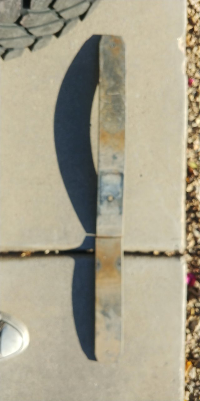

    0314200805.jpg Do it right the first time. I did a single leaf, 3 leaf progressive, and am now on real springs.

    No shims for me. 99% of the time I have about 160lbs in or on the bed so my rake isn't quite as pronounced. I highly recommend you just go straight to the springs of your choice. The 3 leaf progressive will sag and the singles AAL may snap in my experience.
