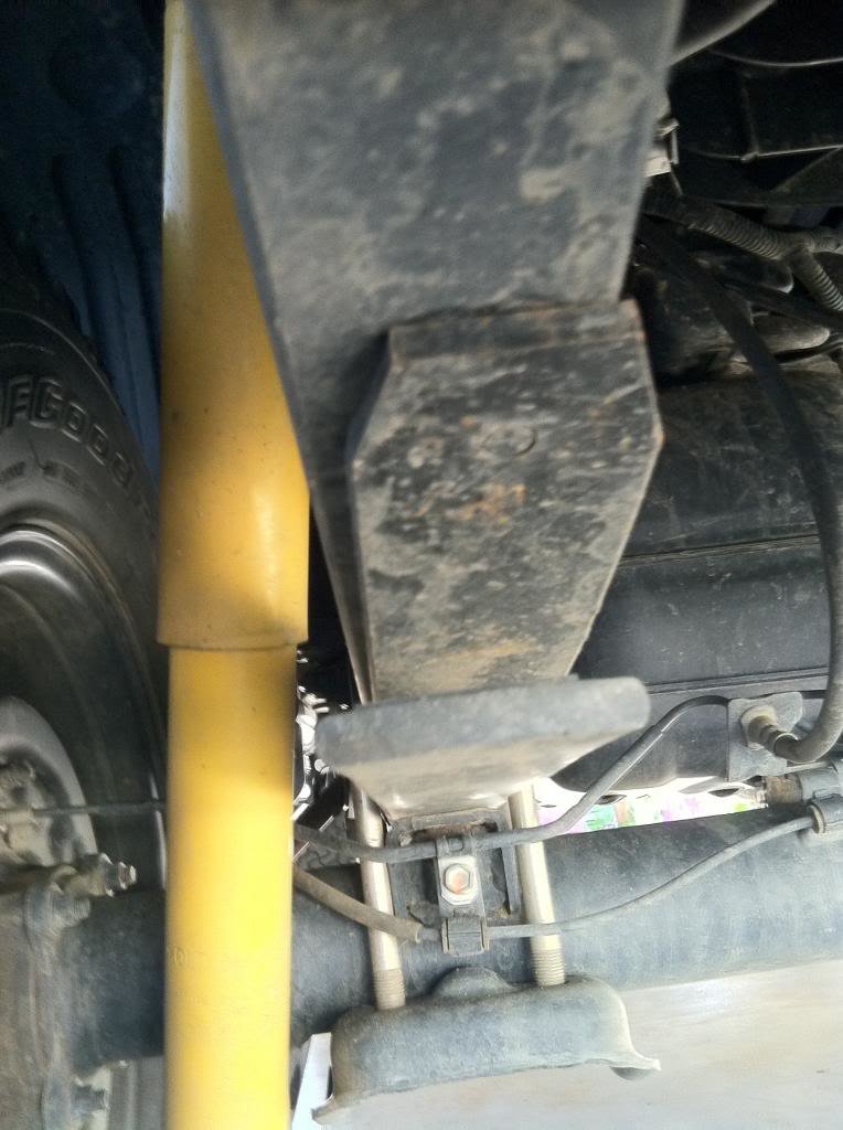

    anyone got an easy fix for this? thanks :thumbsup:

    loosen u bolts, whack AAL with rubber mallet, tighten/torque u bolts.

    would this ruin my alignment at all?

    Nope

    How did that happen?
    Is something bent?
    Whack it--Not familiar w/2009--the 2003 AAL is TIGHT.

    not sure really. maybe in the process of installation..

    these
    you can either loosen the u bolts, or you can find a place to flex that side out
    then pound that mofo back in with a rubber mallet.
    Ask me how I know
    happened to me a bunch of times when I still ran an AAL

    haha wow. yeah ill try flexing. sounds more fun. :cool:

    Old Man Doug make spring retainer clips out of a couple bolts and some flat stock. If this is a concern, you can always make one of those. I went with the 3-leaf AAL, comes with it's own spring retainer :D

    mine would slide out every time I went wheeling, even if I tightened the u-bolts. probably could have used a retainer
    but it broke in half anyways haha
