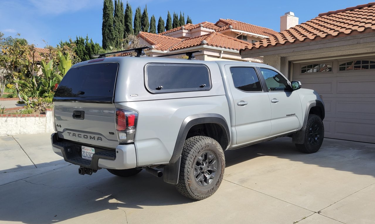

    Yes, it will sit higher than stock with the topper on. I did a Headstrong 3 leaf AAL right before the topper, anticipating the sag. The AAL is advertised as 1.5” (with the overload leaves out) and mine measured about 1.6” over stock before any settling (pre shell). Since the shell, I’ve been sitting at 1” lift over stock for about 4 months now. I did a 1” front lift too so I’m at 1” all around (post-shell).
    Stock (with a hard tonneau cover on and 265/75/16s):
    AAL:
    Stormac likes this.

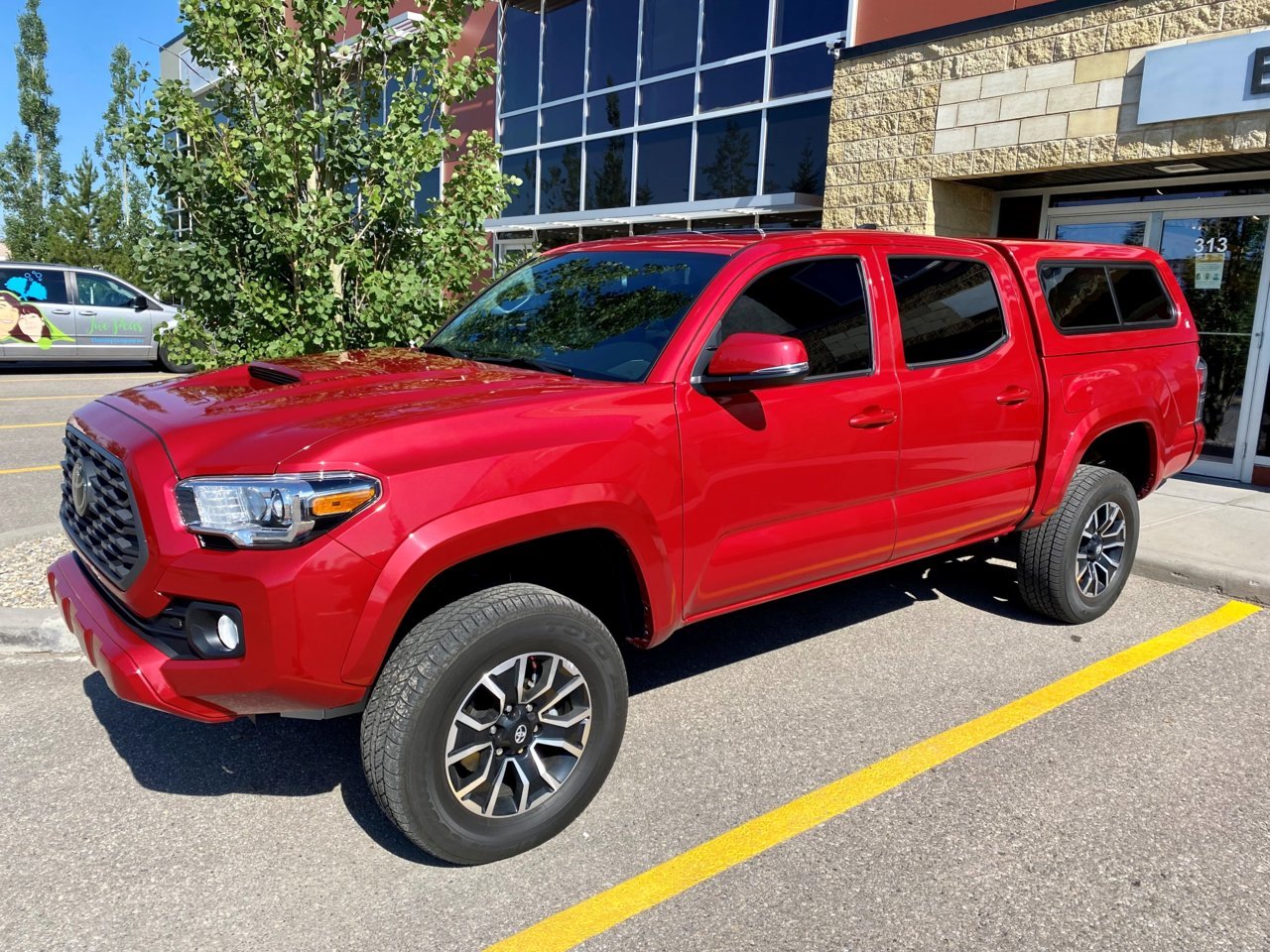

    OP…Whenever you decide on what route you’re going to take, can you update here with how it went?
    I will be picking up my ARE cap in a couple months and am wondering if I’ll need a single AAL as well. I already have the Ready Lift 1 inch rear block kit so I’m hoping I don’t need an AAL. It seems to prevent the rear from sagging with the bed loaded. However, if I do need an AAL I agree that I would only need a single AAL like you said.
    Truck looks great, by the way!
