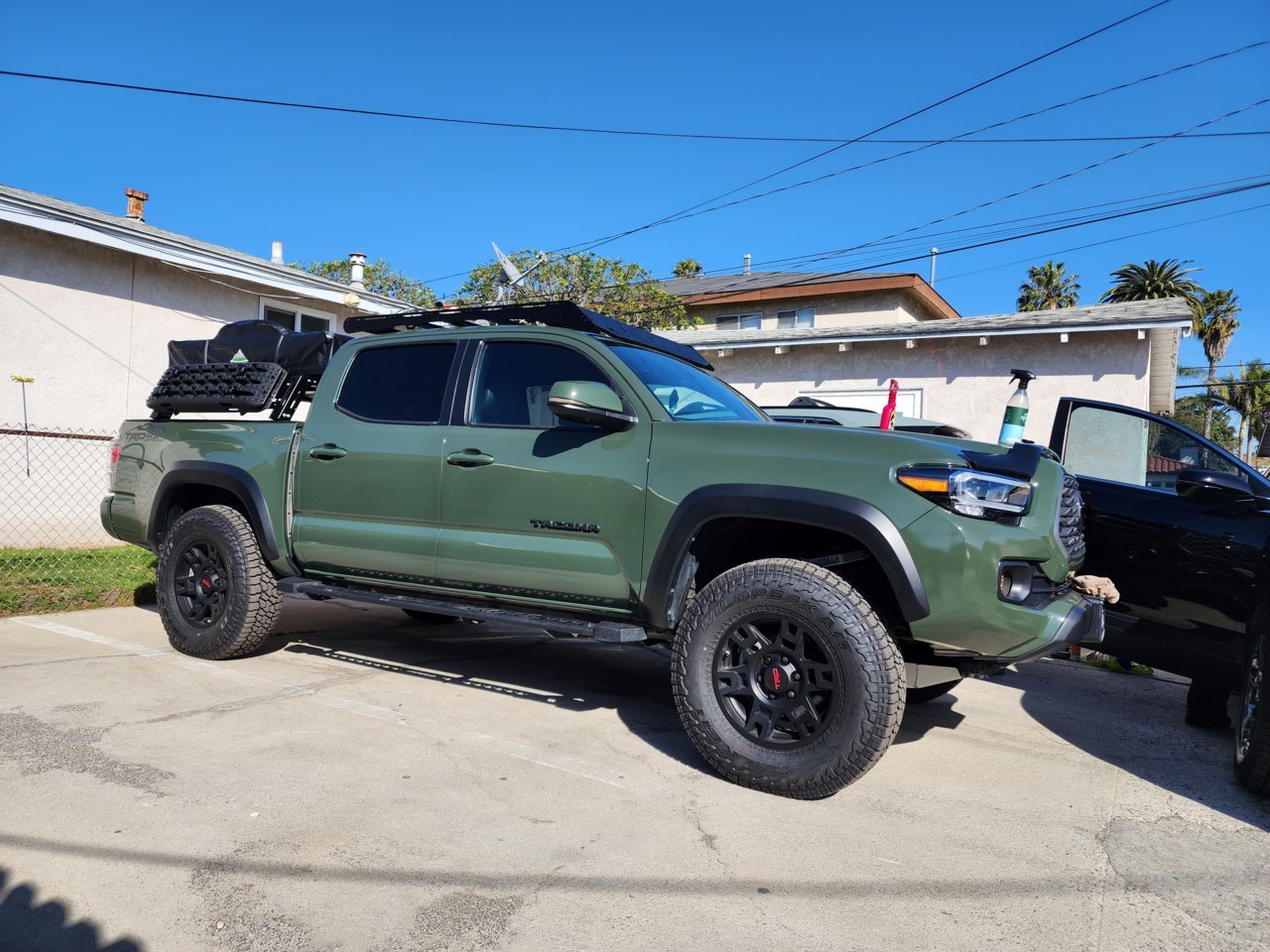

    21greentaco21
    21greentaco21 Member
    Oct 23, 2022
    #408748
    12
    Phillip
    2021 tacoma trd 4x4
    Trd pro fox suspension,mazzulla upper control arms, BD fogs.
    Any updates on this I have slight bro lean with my RTT and racks installed. I was thinking a AAL to suffice for a year or 2 just to get use out of the trd pro fox suspension
