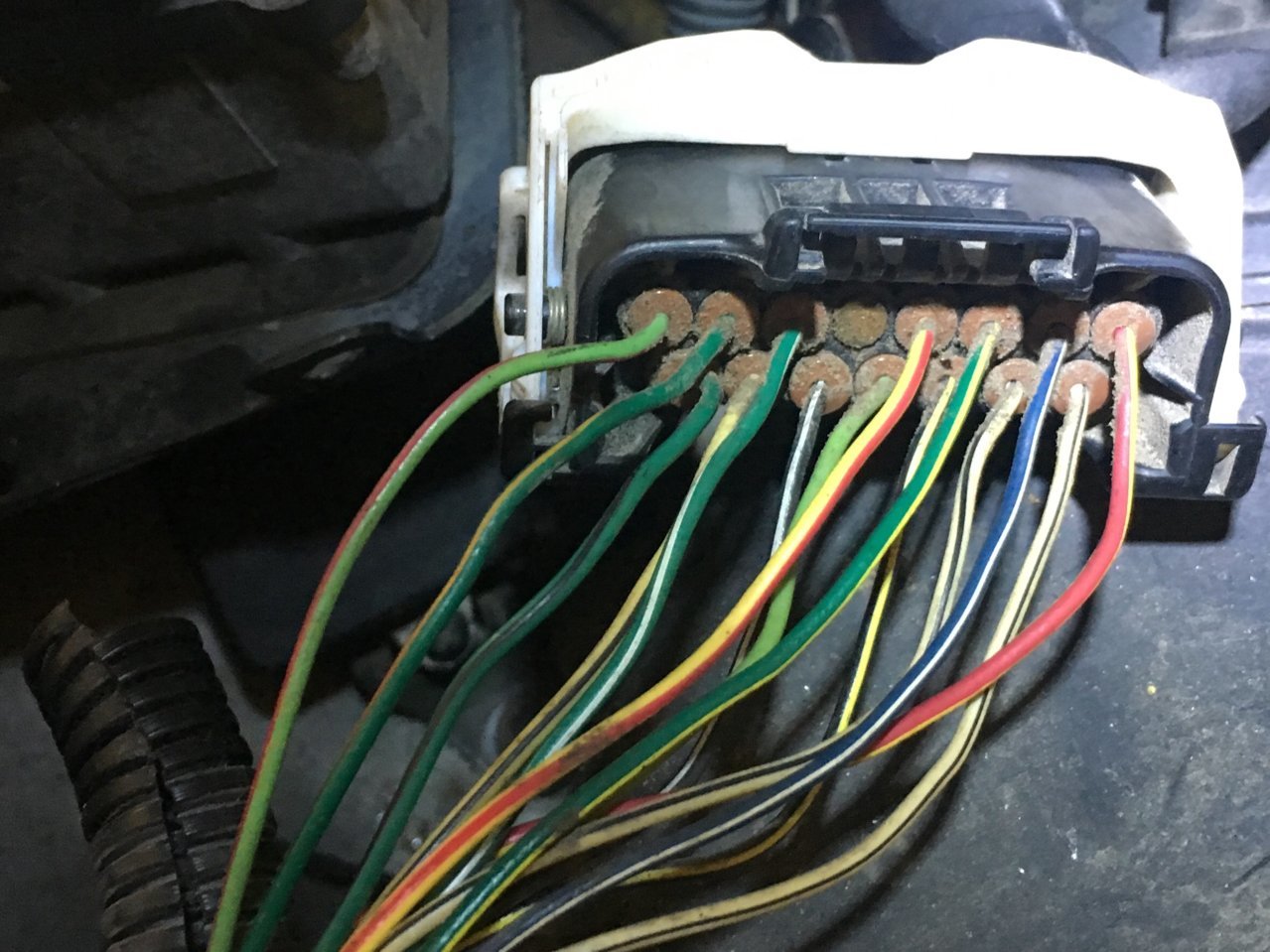

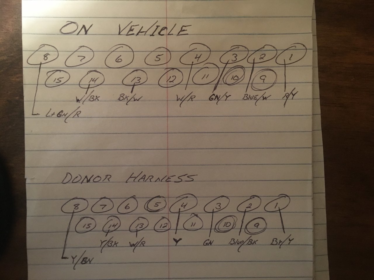

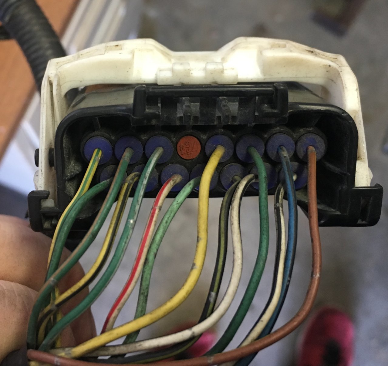

    Hey guys, i’m relatively new to TW. This thread is awesome, Brando113 went to a bit of trouble to do this explaination and i greatly apriciate it. This thread and a couple other cruise control threads have helped a lot.
    Went to the boneyard yesterday in search of the few things i need to piece together an OEM CC sytem for this pre-wirred Tacoma i have. Found some of what i need. I know this is an older thread but if anyone is still following it i still have questions.
    Control Module:
    I have a 2000 Prerunner ext. cab 3.4 w/ auto trans. The best info i’ve been able to find says Part #88240-04030 is the correct one. Best price i’ve seen for one so far is 95.00. I see other modules with part #s off by only one digit(...06030, etc...) on ebay for like 10-15$. The connection looks exactly the same, the rivetted bracketry is different. Can it be that one of these other modules(meant for an auto-trans vehicle) will work and i can just fab my own bracket? If so, someone with experience tell me about interchangebility with these modules.
    Thanks in advance,
    Hammer
    #18
  19. Jul 17, 2018 at 11:46 AM
    #19
    tony2018
    tony2018 Well-Known Member
    Feb 24, 2014
    #123866
    5,285
    dont do it, get the one for your truck
  20. Jul 30, 2018 at 4:59 PM
    #20
    Hammer’sTaco
    Hammer’sTaco Member
    Feb 19, 2018
    #244898
    5
    2000 Prerunner 3.4, automatic
    upon further reading...
    it looks like my rig doesn't require a module at all as the modules are built into the actuators for the 5vzfe trucks. Anyone want to confirm that just for my own warm and fuzzy?
    so now...
    I have an actuator and it's harness I got cheap from the boneyard. It is part #88001-0w030.
    Has anyone been able to substitute:
    actuator# 88001-0w030
    for
    actuator# 88001-0w010??
    I'm including the pics i took of the harnesses and a drawing i made to show the seven wires(out of 14) that are different in color.
    So...
    I made coffee and set out to search the webs to find free wire diagrams so i can understand the purpose of each of the 14 pins on each of these actuators and get ready to do some pinouts if necessary. I figured if this can work at all that's what it'll take. Many hrs of searching and I found me a full FSM with wire diagrams for the 2000Tacoma so that's generally awesome. With it, I see the purpose of the *010 pins. Now if anyone wants to share w/ me a pinout drawing of the *030 or maybe a cruise control wiring diagram for the 98 4runner, that would be nice.
    and now I see...
    toyotapartsdeal.com has each of the two listed as being peculiar to certain automatic transmission/vehicle/Trim package(my Tacoma has a VZN195L and, acording to TPD, calls for the the ...010 actuator) combinations W/ *030 applications being restricted to 4runners. Also interesting to note is that when I look at the used ones on ebay that still have a chopped harness on 'em, I'm seeing either of these 2 harness color layouts on either of the 2 actuators which emboldens me to consider giving it a try as is. I have the actuator bolted up and cabled to the throttle already.
    What y'all think? Anyone who's done something similar already, jump in here and tell me what ya learned! I ain't goin any further without some more info.
