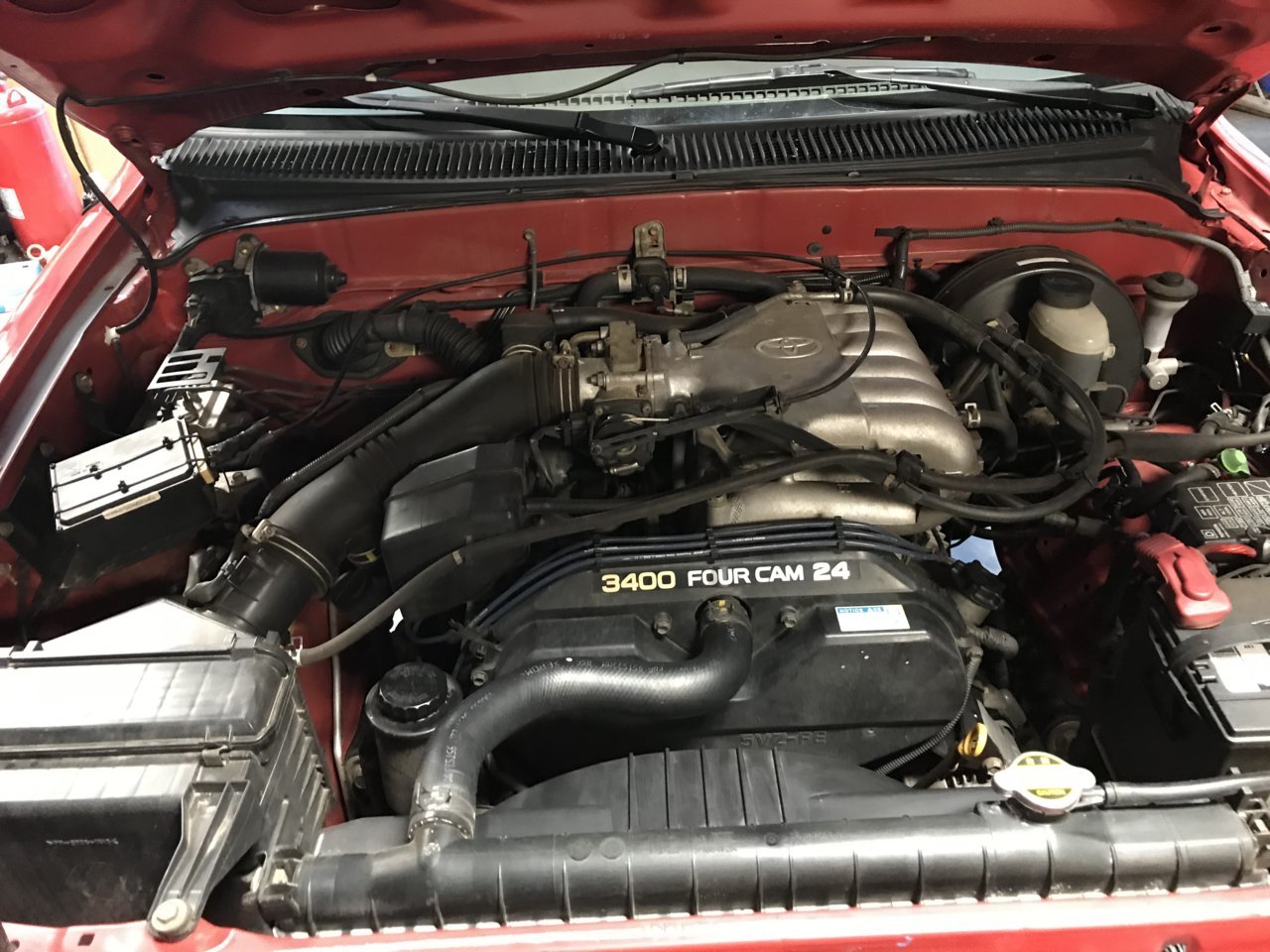

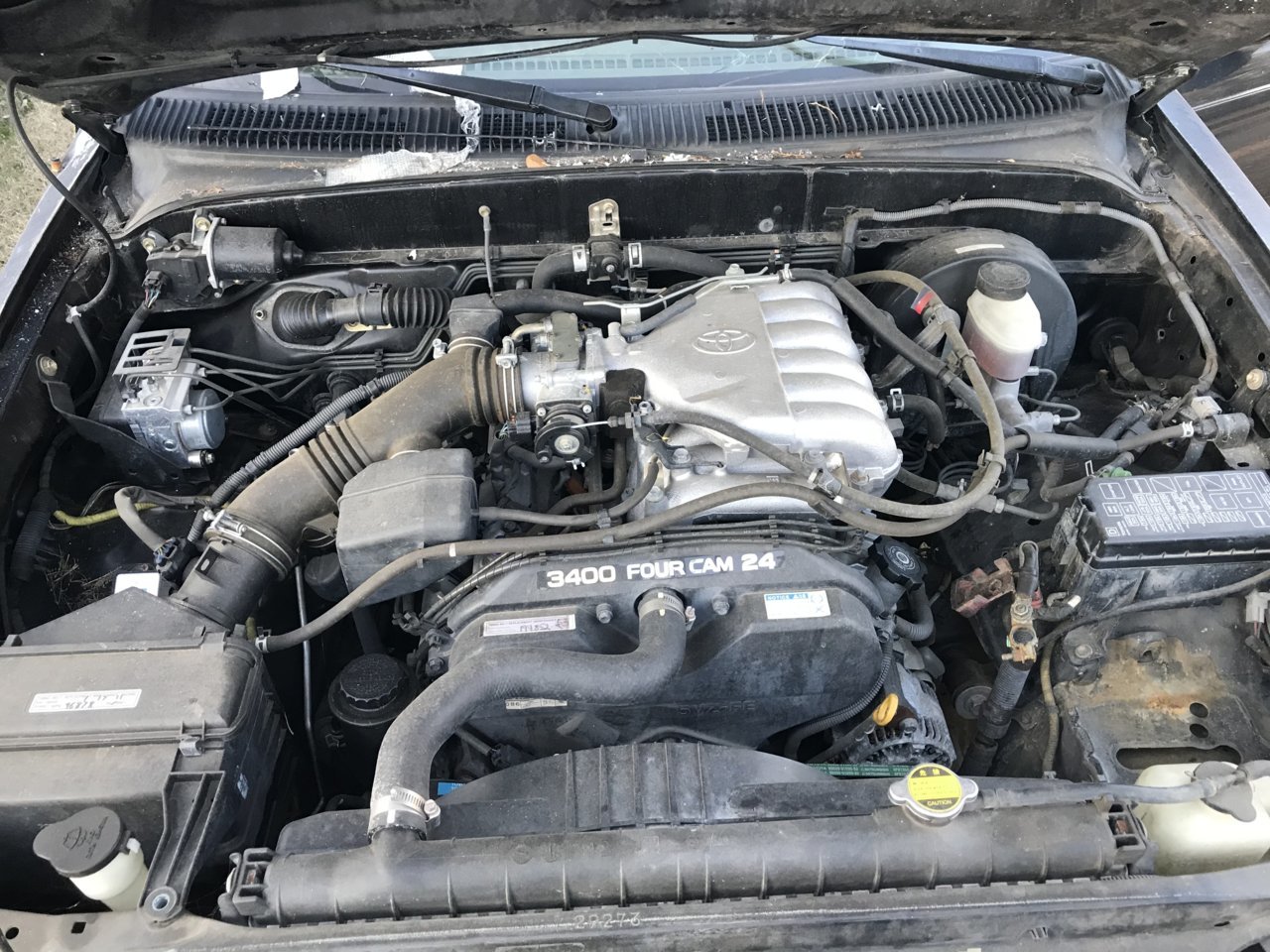

    OK Im confused. I have an 02 rollover pre runner 3.4 parts truck and my 2004 5 speed 3.4 4x4
    Both have cruise The 2002 prerunner has the control stub on the steering wheel.(which looks factory) and under the hood engine has NO sign of cruise control. No box or extra cable to pull throttle blade. BUT, my 2004 has control stub on left side of steering column. (Looks added not factory)
    and under the hood a cruise control box and a cable to throttle body? My 04 every time i turn on cruise. ABS light instantly comes on and wont work.
    Id rather have the 02 setup. throttle bodies look the same? why wouldnt the Cruise assembly not be???

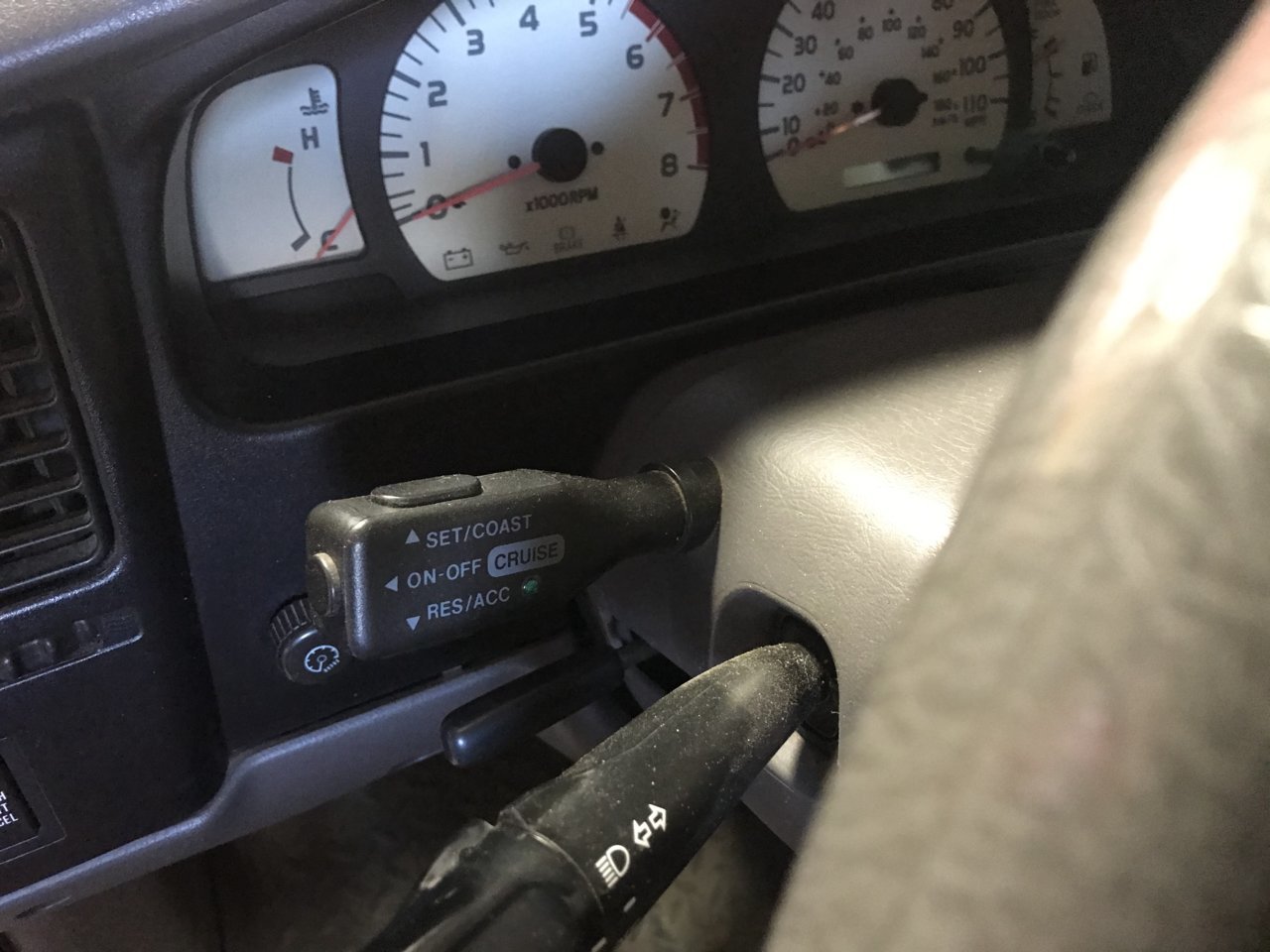

    That’s odd I have an 03 and I have the same cruise control on the left side. When I turn it on there’s not light on the dash is just a green light on the cruise control switch. So it must be factory and probably a little change for the 03’s and 04’s.

    Because your 04 has that awful Rostra aftermarket cruise control kit installed, the one Gulf States Toyota crammed into every Tacoma they could, even when - as is the case with an AT 3.4L 04 - the only extra part needed for factory cruise is the stub switch. The electronic throttle body does the work of the separate actuator, and all the programming of the separate control module (behind the passenger kick plate) was put into the main ECU.*
    No surprise it's not working. Excise that thing from your truck. Follow the wires from the stalk switch; the harness runs under the dash and at some point taps into the factory harness via Rostra's plug taps. Same with the other harness from the Rostra actuator/control unit that runs through the firewall. You probably even have the plastic plug on your 02 to cover the firewall port.
    The throttle bodies might very well be the same. IIRC, Toyota switched to the electronic throttle bodies during the 02 production year, so those made after 9/02 have the same ones as the 03-04s. Can't say for sure without the VIN, but I bet all you gotta do after the Rostra surgery is install the cruise control switch (and the steering wheel backing, or cut the hole yourself) from your 02 to get factory cruise working.
    *95% sure about not needing the control module. VIN will tell you for sure, and if you do need one you might already have the right one in your 02.

    No, your 2002 has factory cruise. Your 2004 has the Rostra aftermarket cruise. And yes, after removing that aftermarket actuator and cable to your throttle body, and all the wiring from it to the stalk switch, all you should need to enable the factory cruise is to install that cruise switch from your 2002. Your 2004 engine bay will look like your 2002 does now.

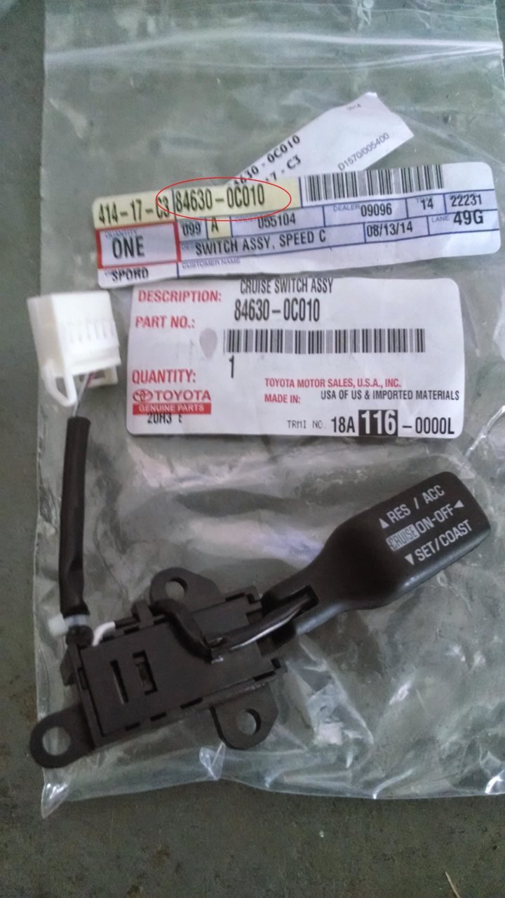

    Why would a toyota dealership add this pile of wires and control box under hood of a new vehicle ? When all they needed was just this!!

    Yes it did. I had to replace both switches clutch/brake. And add the bulb to cruise light. N it worked.

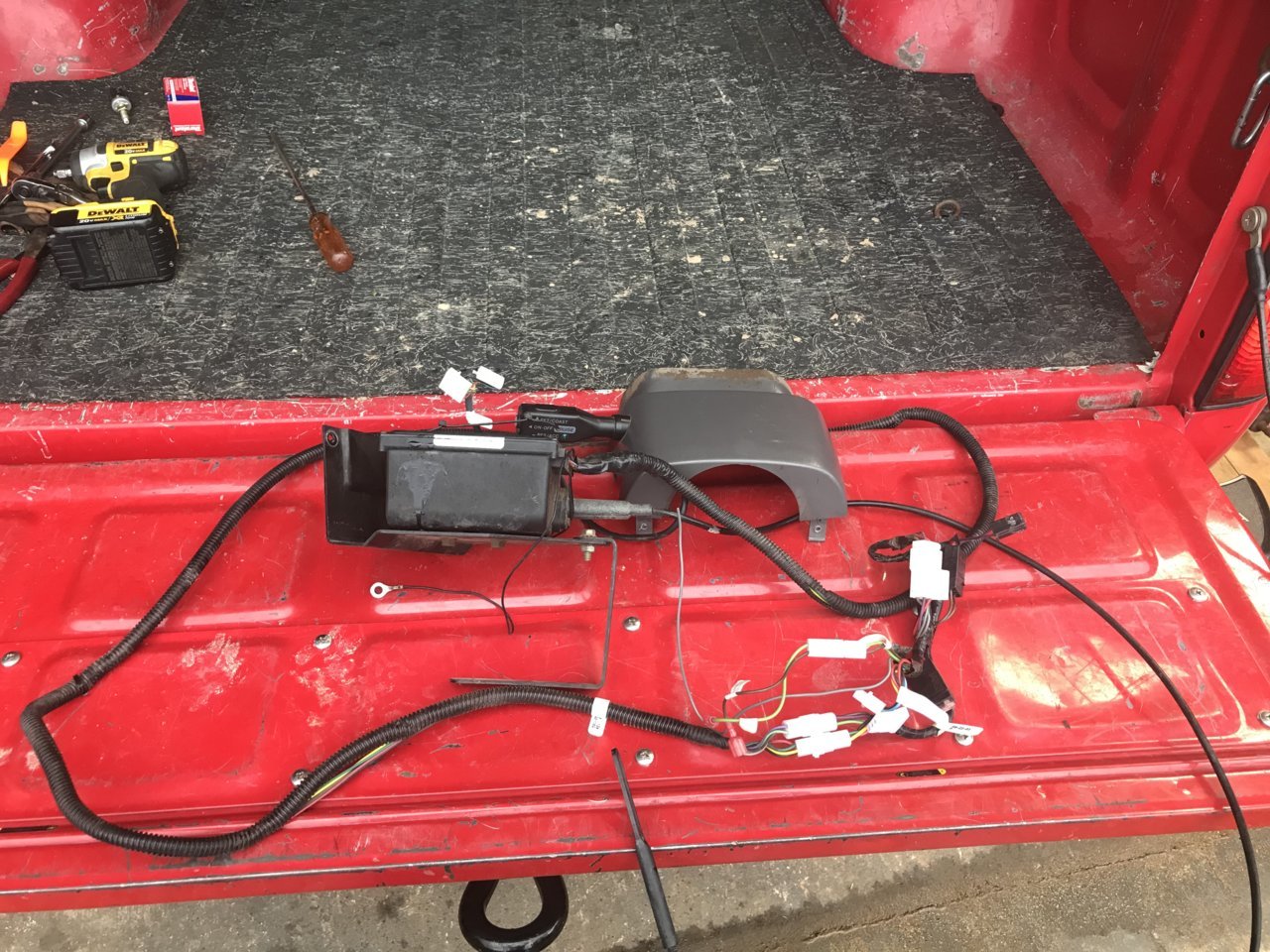

    I’m tagging on to this thread for anyone else that has been researching this. My truck, 2003 Auto 4wd 4 door, had the notorious Rostra controls Cruise control. It was a point of contention 19 years ago when I bought the truck, and that’s when I found out that GST, Gulf States Toyota, considers it to be factory! It worked fine up until it did not and that’s when I found out about the plug-n-play option of just adding the CC stalk. I thank Faye Hadley for one of her YouTube’s about adding it to a 2nd gen that got me to research it here.
    The hardest part was pulling the correct switch from the salvage yard (it will have 3 wires, including a ground) and then pulling all of the Rostra parts off.
    Notes:
    On some of the scotch locks from Rostra, it was easier to cut the wire, roll it up and tape it off than to try and unlock it and then leave a potentially exposed wire.
    My truck had the cruise light bulb, no need to take apart the cluster
    The brake light switch: If you are taking out a Rostra control CC, it has a wire harness that goes from the brake light switch to to the plug that would normally attach to the brake light switch. Once you remove that, you will connect the factory harness to your new brake light switch (the one with 4 prongs) and then adjust it for sensitivity (I used a mirror).
    It really is straight forward once you read through all of the posts and why GST would do this to our trucks is ridiculous, but now, after 19 years I finally have the factory cruise I always wanted. LOL.
