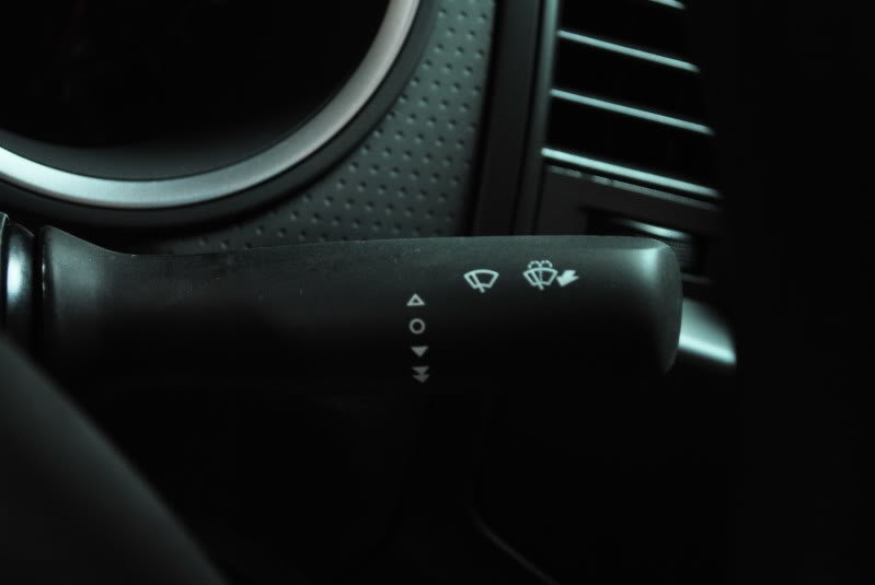

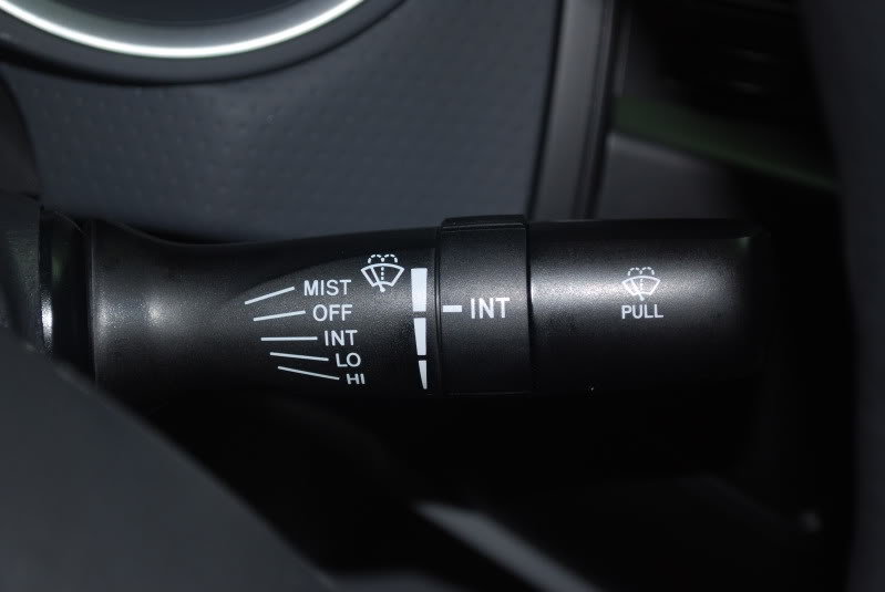

    I did the work last night and it was pretty easy. Hardest part was removing the shroud around the steering column. This is my first Toyota in a long long time and I need to get used to how the trim is assembled. It is a lot different than a GM H Body.
    Before
    After
    Works like a champ. Tested on the way home tonight in the rain.
