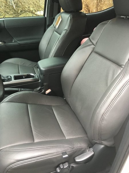

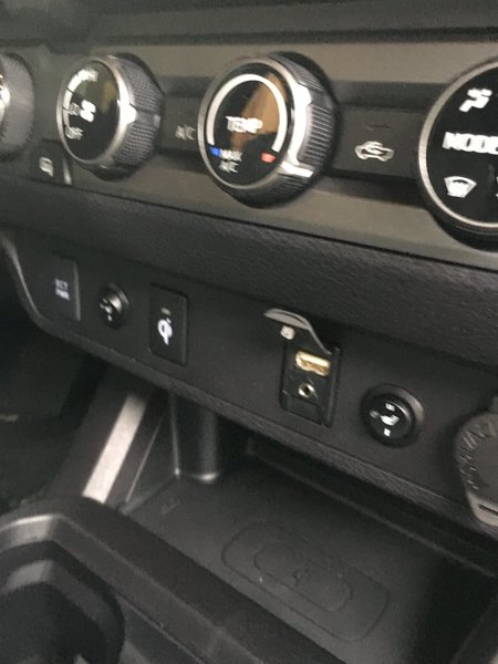

    Here's some photos. You can see the
    Small switches for the heated seats installed. They are the small round switches. About the size of a nickel.

    Looks good, does it goes above original cloth seat covers? Talking about non Katzkin one
    Katzkin looks awesome, that's what I'll get for my truck

    No only the seats were done. Both front and back and headrests. I had them add heat to the front 2 seats.

    Looks good! You may have just changed my mind...

    The seats are pretty comfortable with the leather and the heat has a high and low setting. Living in the northeast I leave them set to low for when I use my remote start. Always nice and warm. Well worth it. Plus I have two dogs. Much easier for cleaning.

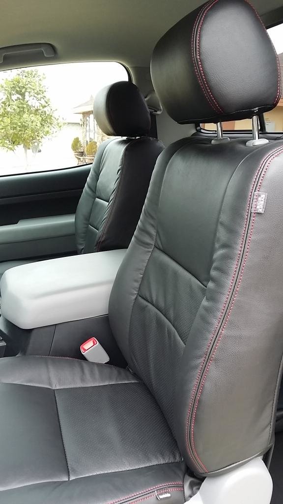

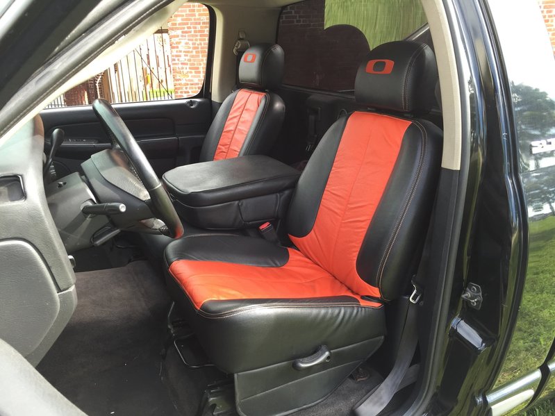

    Here is one I did, katzkin. Took 3hr with help of two friend. The trick to make install much easier is using steamer, steam leather for about 1min, so it's easier to work with, also thin plastic bags for headrest or silicon spray. I enjoyed the whole prosses of install, will defiantly do my taco in black leather, for about 650$ on eBay can't beat it, plus I have all tools for it.image.jpg
