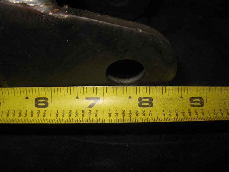

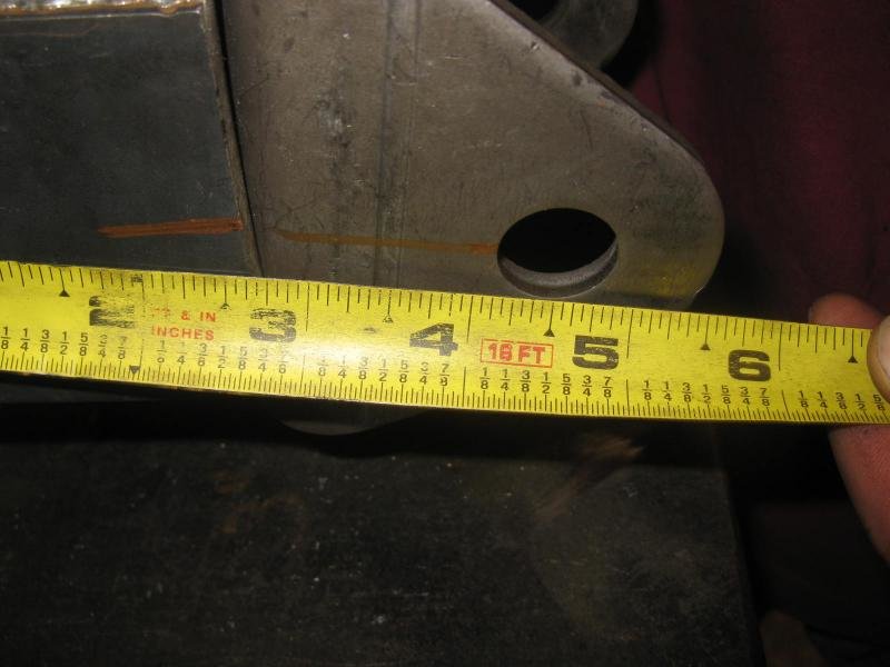

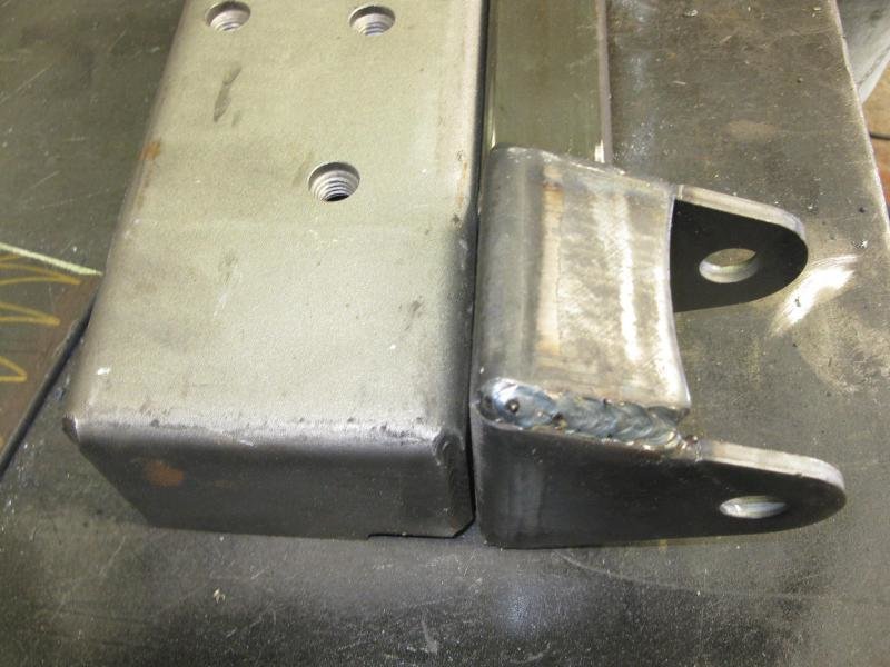

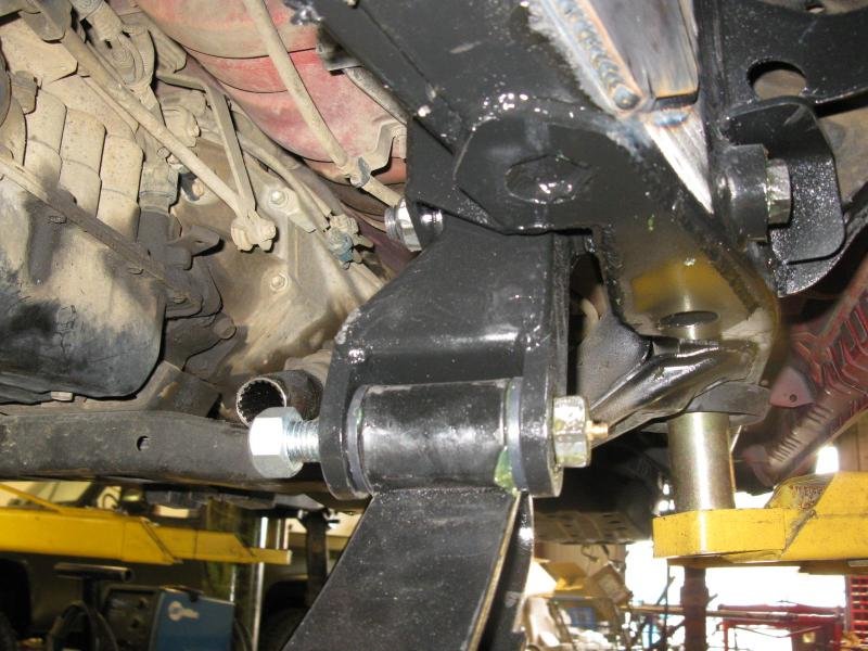

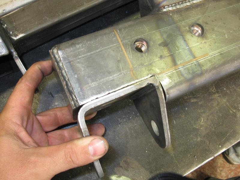

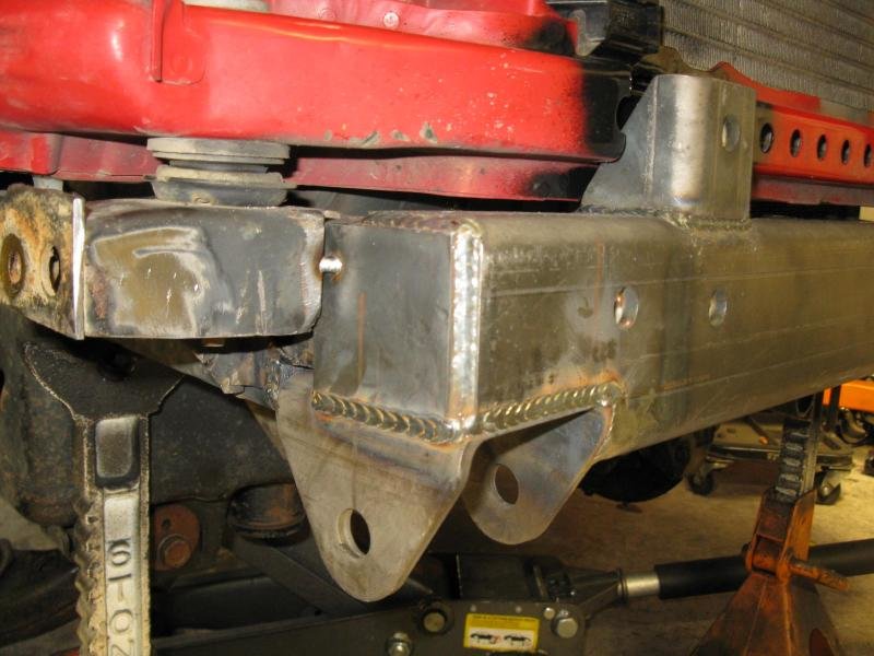

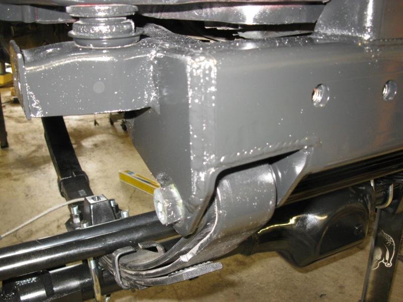

    Okay, so we mocked up the front hanger. Pics and measurements should speak for themselves.
    First of all, we don't use TG's front crossmembers anyway in these kits. Theirs are .188 wall and an inch taller than ours to begin with. We use our Tacoma weld on crossmembers for our bumper instead. Ours is .250 wall and an inch shorter.
    In this case we wanted to french the front spring hanger. So, we notched our crossmember to allow us to mount the new spring hanger into the frame. This saved a solid 2.875" of height here. That will equate to roughly 1.5" of lowered lift height.
    TG's crossmember with their spring hanger is 7-3/8"
    Our crossmember with french hangers is 4.5"
    TG's
    1032073d1379010049-addicted-offroads-dou_206a632e2c83390abaa137a18dff2d5bf152cf6d.jpg
    Our's
    1032081d1379010049-addicted-offroads-dou_21d623e0b6719814a88af9a2b0f1c6d9b005c7b4.jpg
    TG's
    1032089d1379010049-addicted-offroads-dou_351d3a2d28f9677de4c8aaa63f0d0b920d4c108a.jpg
    Ours
    1032097d1379010049-addicted-offroads-dou_42776864da8f66122a4568958a4d833ab2a2db34.jpg

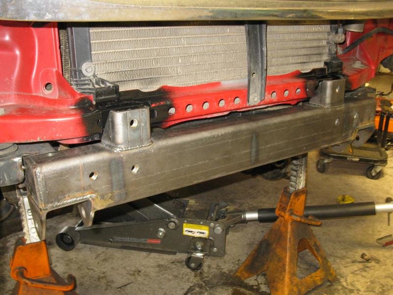

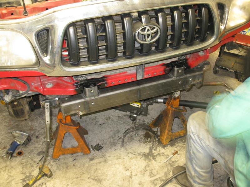

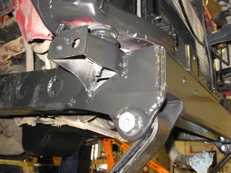

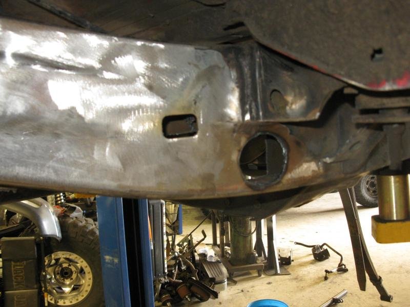

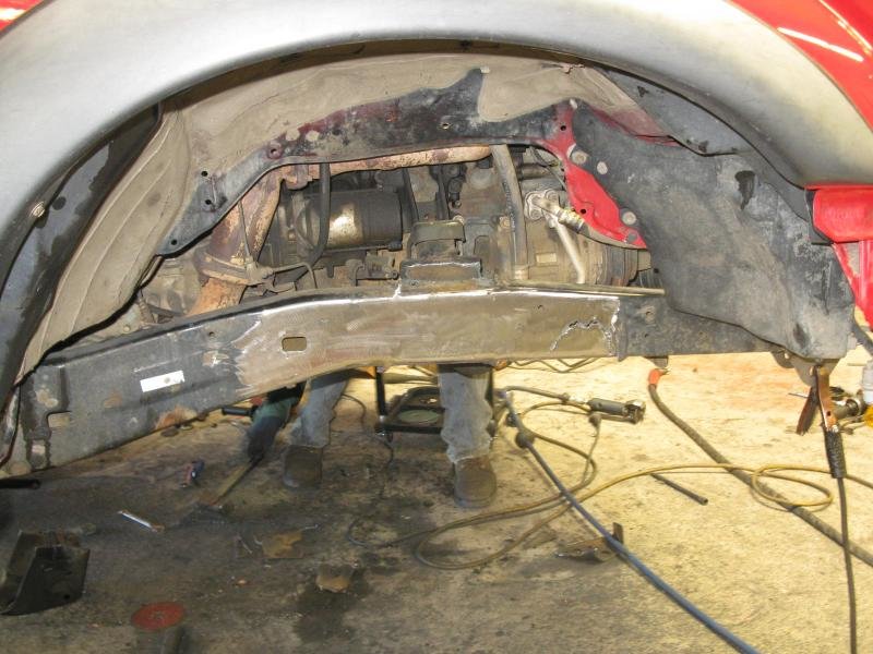

    crossmember in place. Recessed back and frame is notched to allow more clearance. Steering is going to need a flat pitman arm, and we will llikely be notching the frame for clearance of it as well.
    1032401d1379022228-addicted-offroads-dou_44701a1c897b1b03e500666936d0dbfbd55ce543.jpg
    1032409d1379022228-addicted-offroads-dou_34b389488acaedafa3a284e06e37d0aafbf59c97.jpg
    1032417d1379022228-addicted-offroads-dou_4dbb6cebbcd1d0d01b0cc49840594a42f8f24fcd.jpg

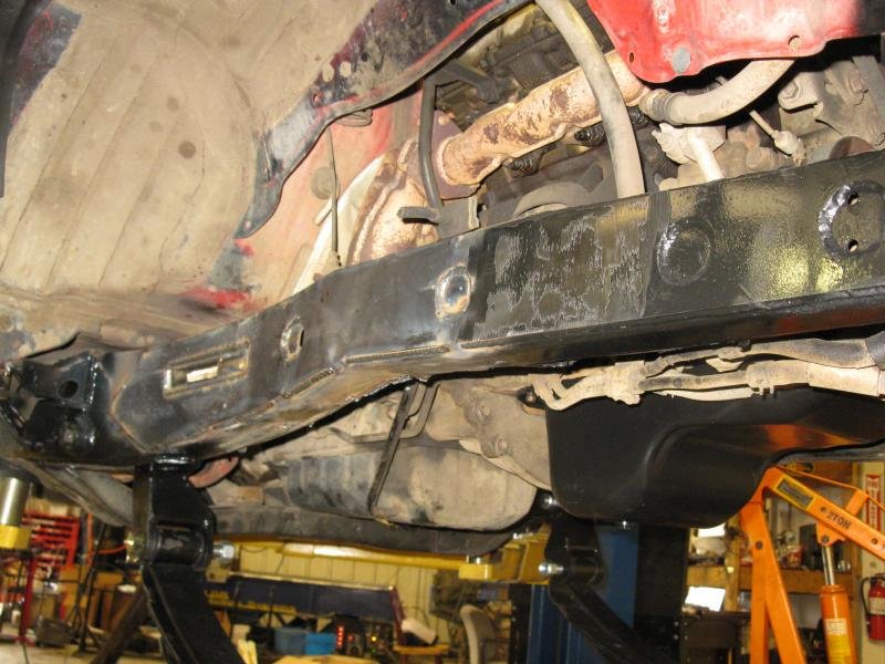

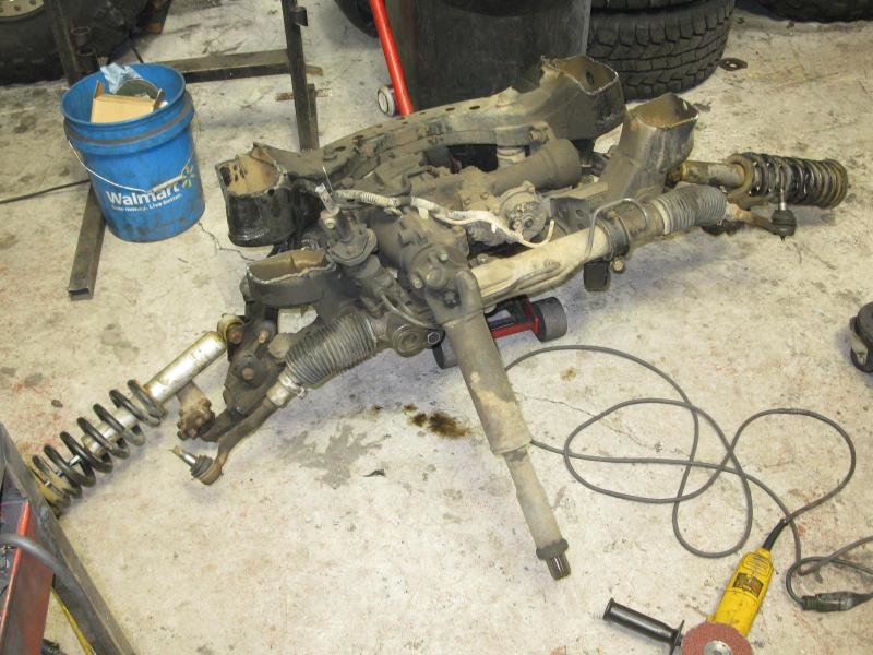

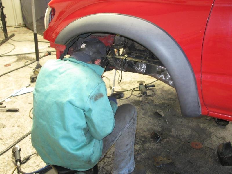

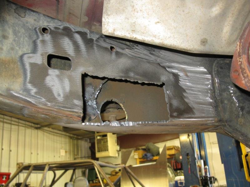

    Some progress. Grinding day sucks!
    1038337d1379439729-addicted-offroads-dou_89c64f221b2d48fdace36ed4279e3dc20ddea16a.jpg
    1038345d1379439729-addicted-offroads-dou_4f665126480a9a0758758b2b4d9c184a27667046.jpg
    1038353d1379439729-addicted-offroads-dou_9567c963762c78998ac26527bbe135e2d92e4768.jpg

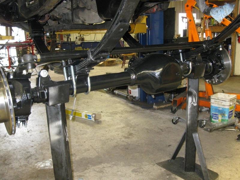

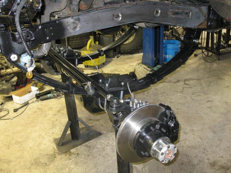

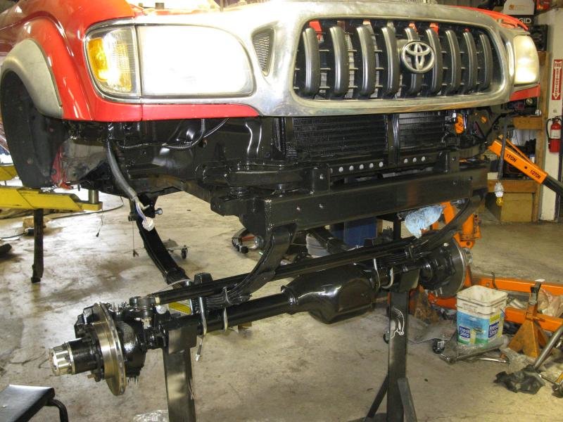

    Axle is hung
    1040089d1379544699-addicted-offroads-dou_64d6a8f229f22ac81b2333623101a12c675eb6c9.jpg
    1040097d1379544699-addicted-offroads-dou_a9c8955614896dafcb415e5f6737317799d96e38.jpg
    1040105d1379544699-addicted-offroads-dou_af5f25eca8c41b2516ff4772b6795a98f6b06118.jpg
    1040113d1379544699-addicted-offroads-dou_d5f1bfeb7cebc09fda27428ccec6b487f87a9faf.jpg
    1040121d1379544699-addicted-offroads-dou_05b9f6f0780efc25cb28124274c69c443e3034ce.jpg
    1040129d1379544777-addicted-offroads-dou_65f90c7a9b6508893180dae08f152c7edacde64c.jpg
    1040137d1379544777-addicted-offroads-dou_c5546332ecd56e472fff846d9a5f9ed81e98de23.jpg
    1040145d1379544777-addicted-offroads-dou_a9da5affd79b708458dfdaea1ba542e77fcf1301.jpg
    1040153d1379544777-addicted-offroads-dou_d953ea1366db78dad556ce3e81d40d641f0f7fb2.jpg
    1040161d1379544777-addicted-offroads-dou_5cc38d3b5e958a0e71d55a14bdcba5fb240fcc47.jpg
    Pirhett likes this.

    Thats the best you guys at Addicted can do!! I bet you cant do that to my 06 access cab. In fact Im sure of it. Ill drive my truck down from Canada! But if you want to make an example of me by SACing my truck, then I will eat crow and look the fool. But just in case.
    That is looking great
    It is crazy how you guys lowered the ride height by notching that front piece of frame for the frenchy.
    Just awesome!
