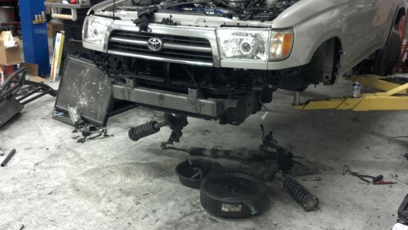

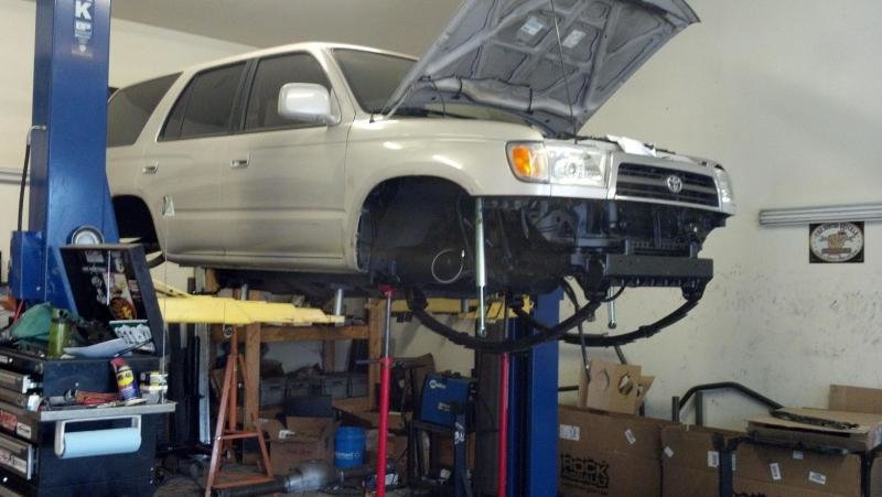

    This is Glade's new project. He found this 4runner for $3000. 96' 3.4L Auto. 203K on it. The guy thought it had a bad tranny. CEL was on, so we pulled codes and it was a cylinder 4 misfire. The rig would stutter when under load, so the seller thought it was the tranny. We swapped plugs and wires and no more issue.
    Anyway, here is the build list.
    TG 3" Tacoma Kit "C" with 5.29s and ARBs front and rear.
    Rear 3" Tacoma kit
    Dual cases (keeping the stock rear case)
    37x12.5x17 Radial Trepadors

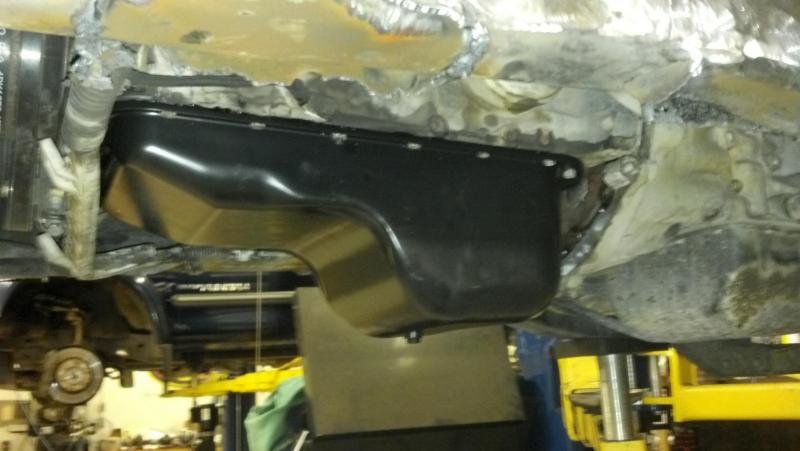

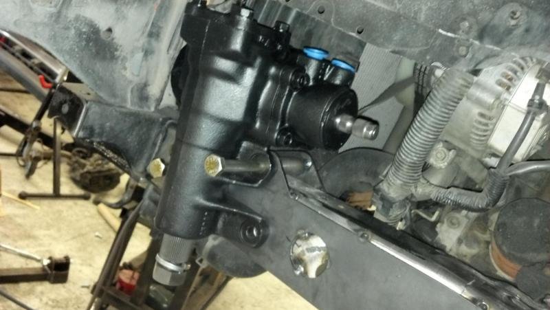

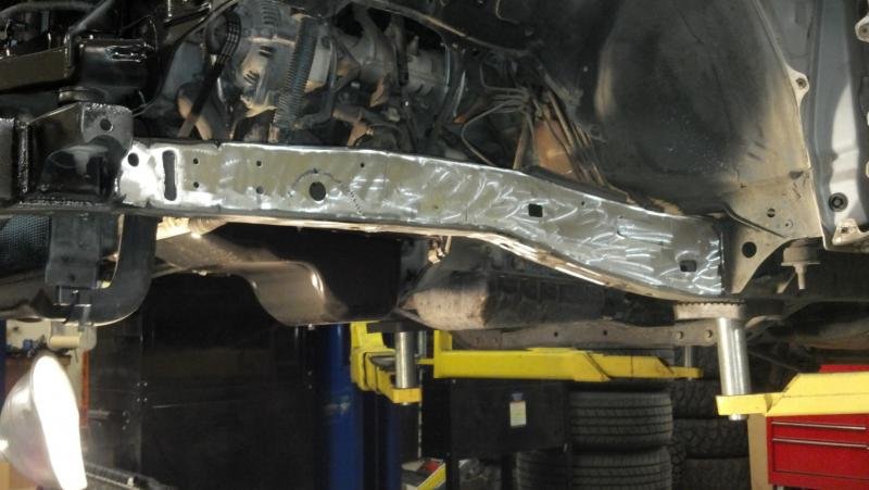

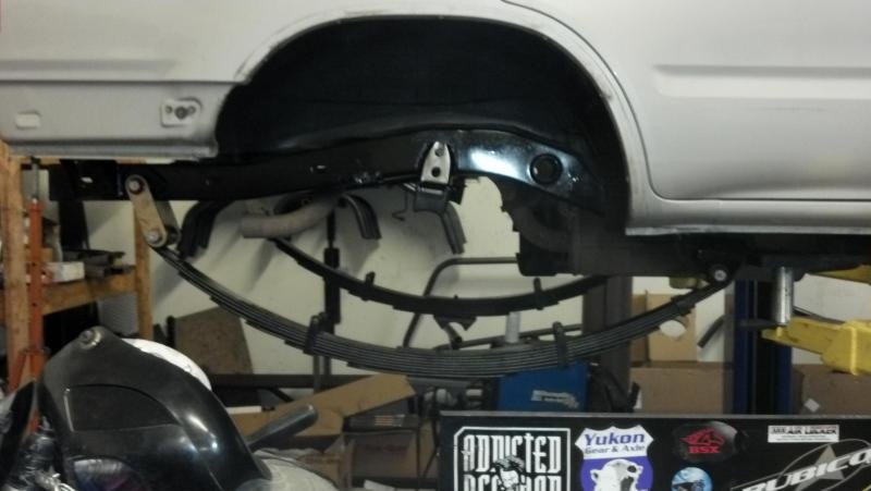

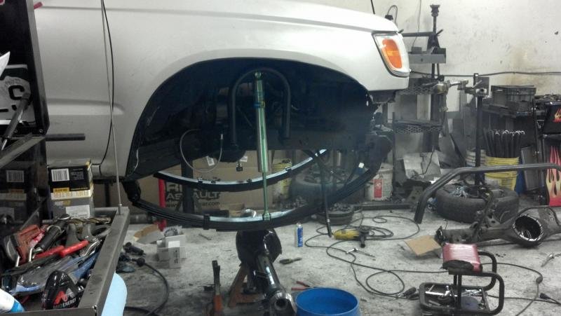

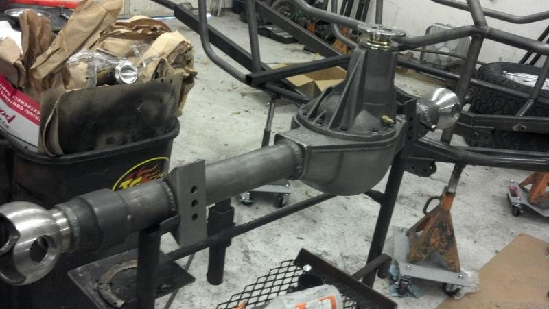

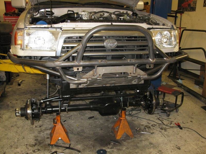

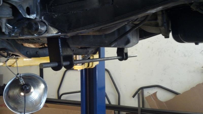

    Axle is hung

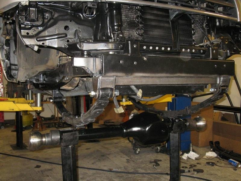

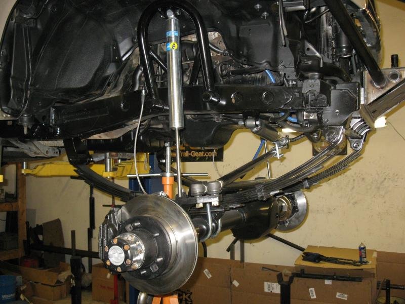

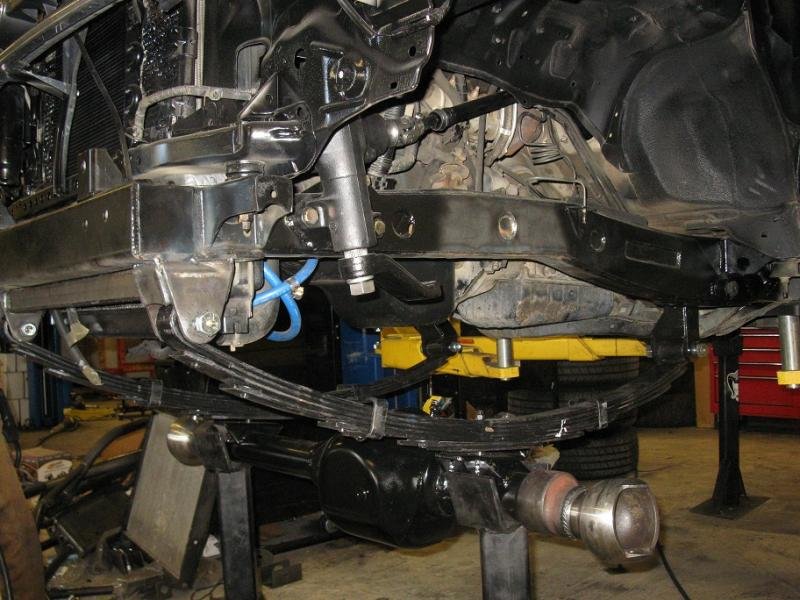

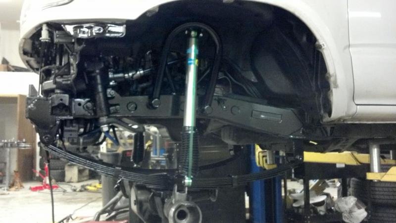

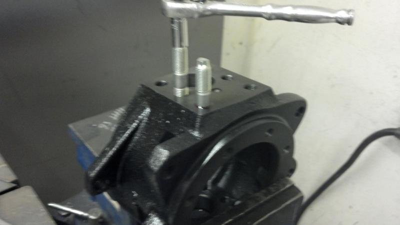

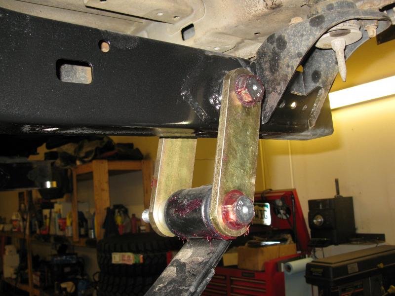

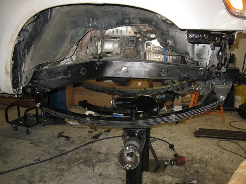

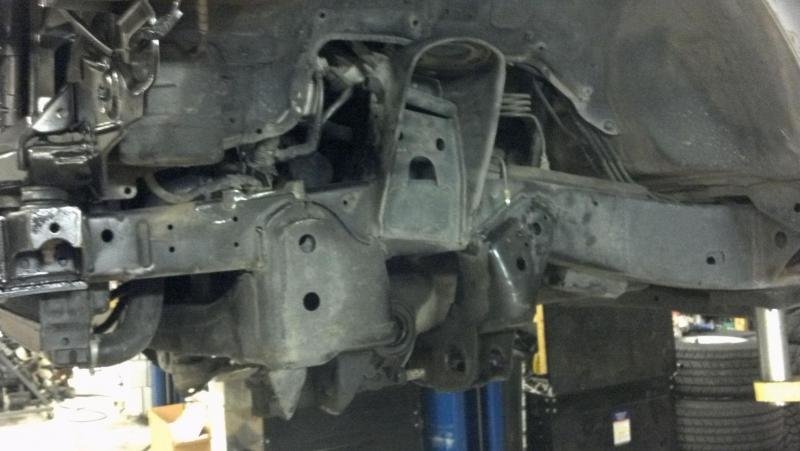

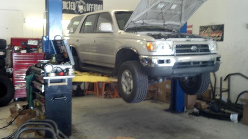

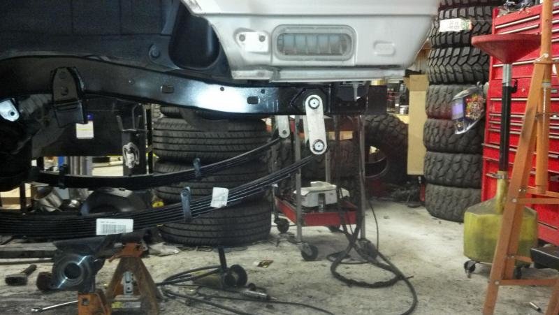

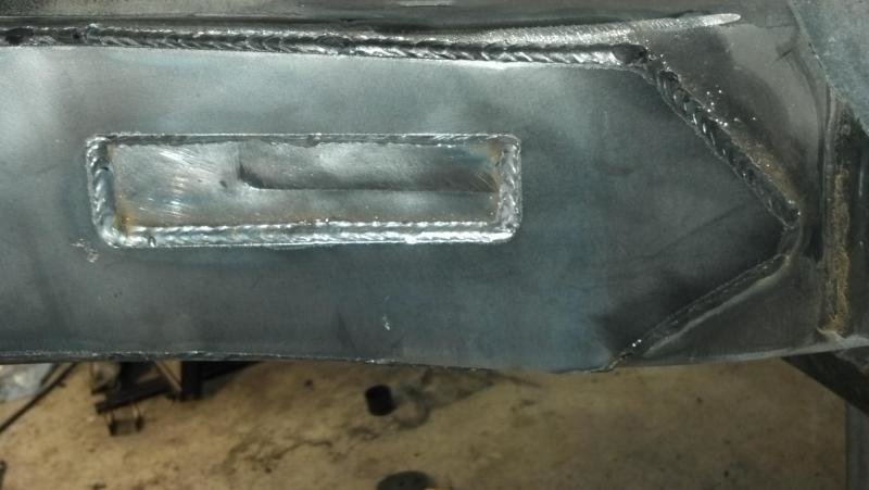

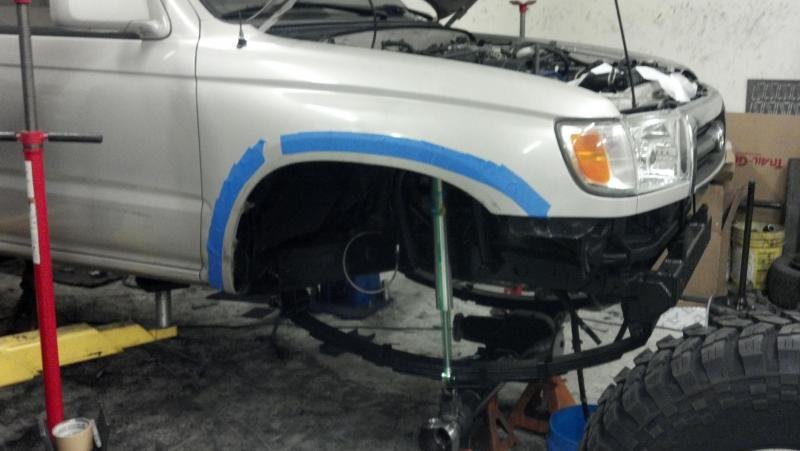

    Updated pics. Sorry for the pic quality. Glade was texting me these from his cell.

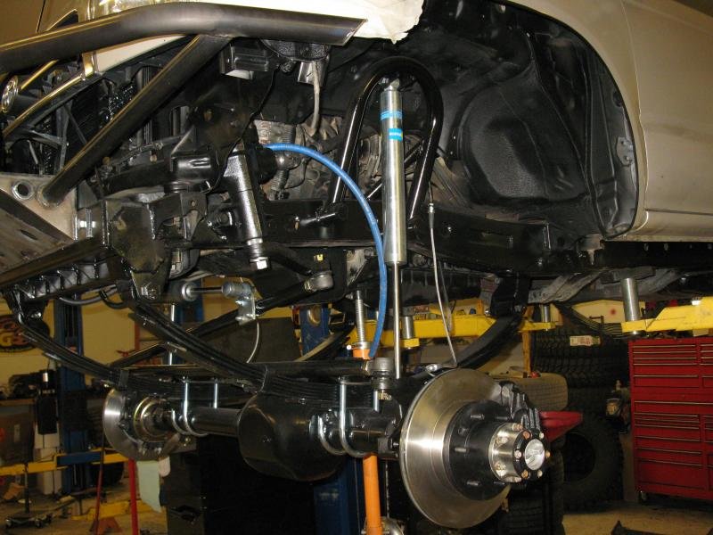

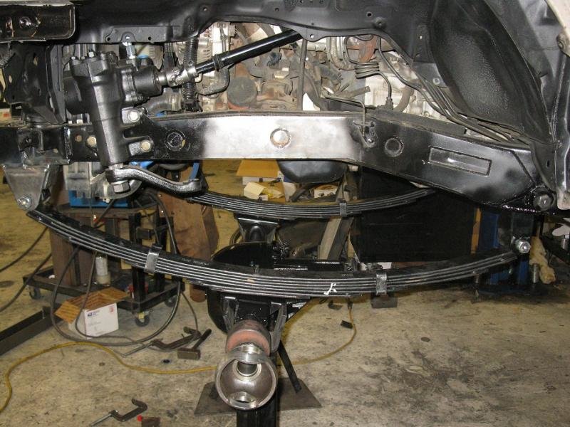

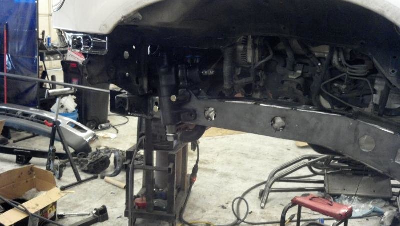

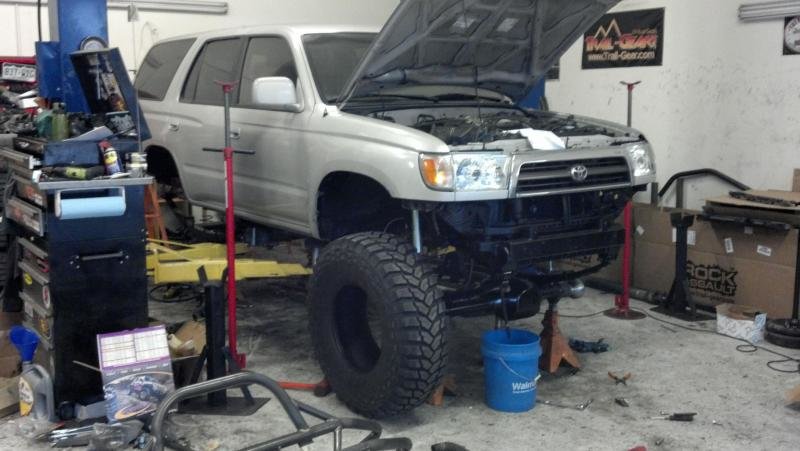

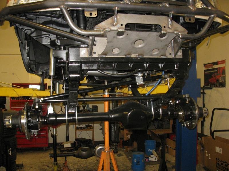

    Pics as of yesterday.

    Looks great as always!
