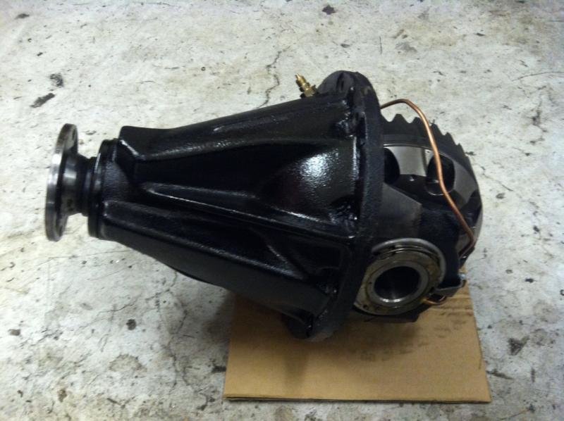

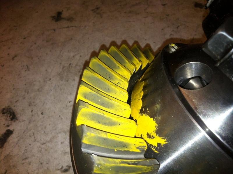

    setup the ARB rear 3rd today. Building the TCases tomorrow too.
    703982d1351290585-addicteds-96-4runner-u_7ae4c060ca6058e27d60b4a8426c9b80771ba12c.jpg
    703983d1351290585-addicteds-96-4runner-u_e4bc7745ac71614b8f53acd3206f9356a5b43363.jpg

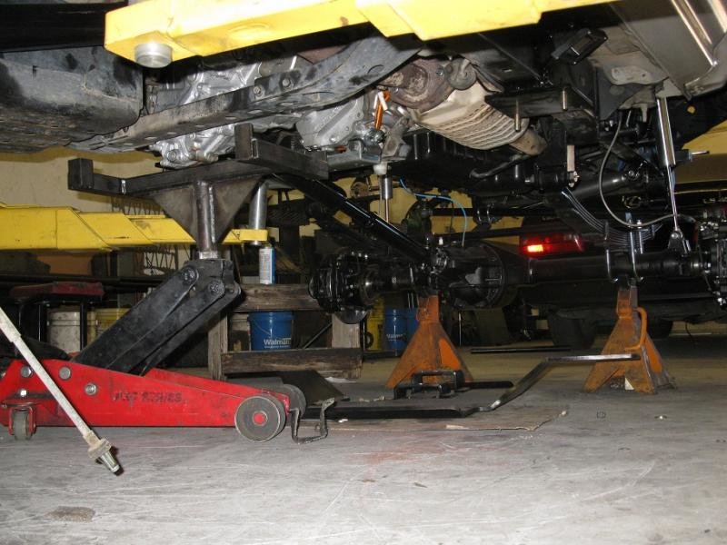

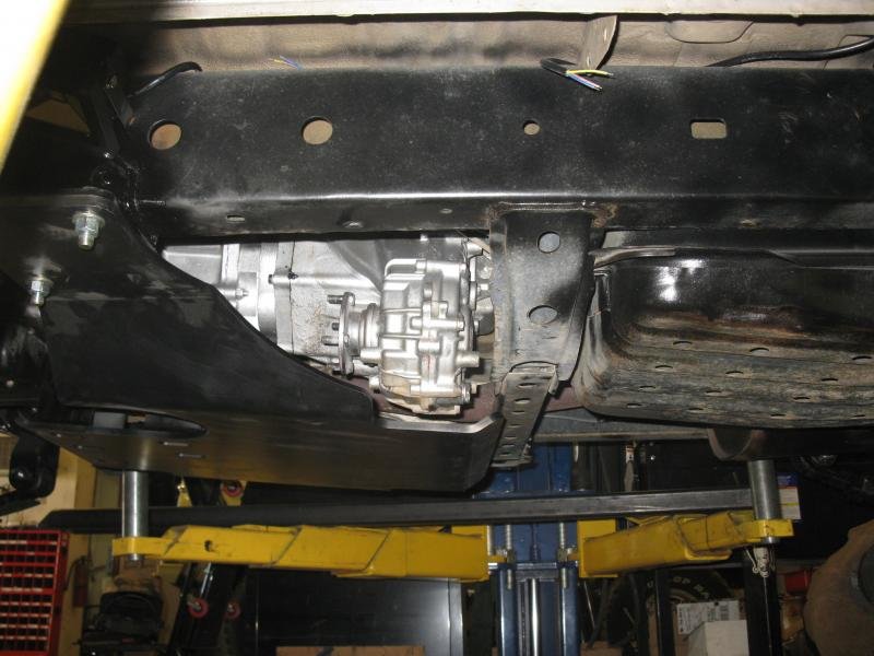

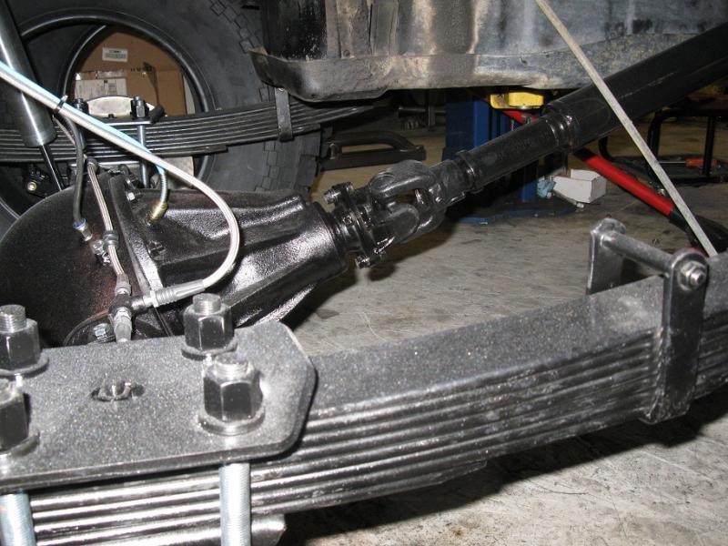

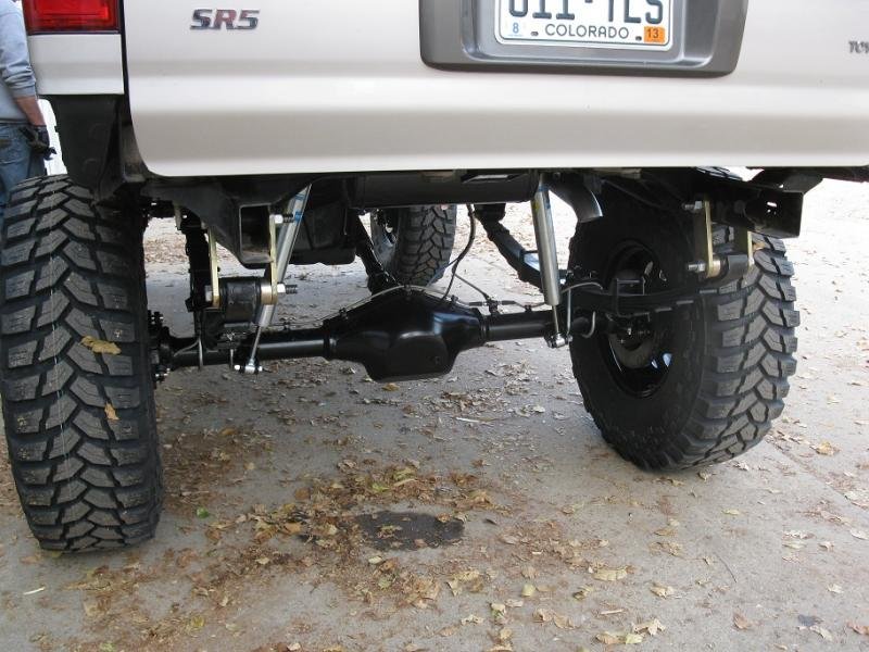

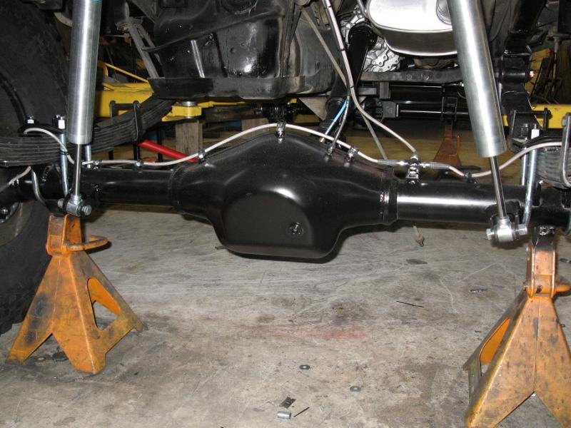

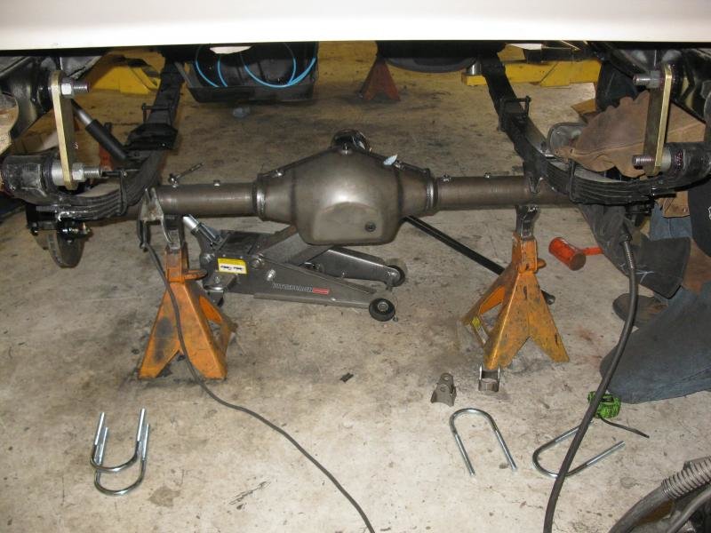

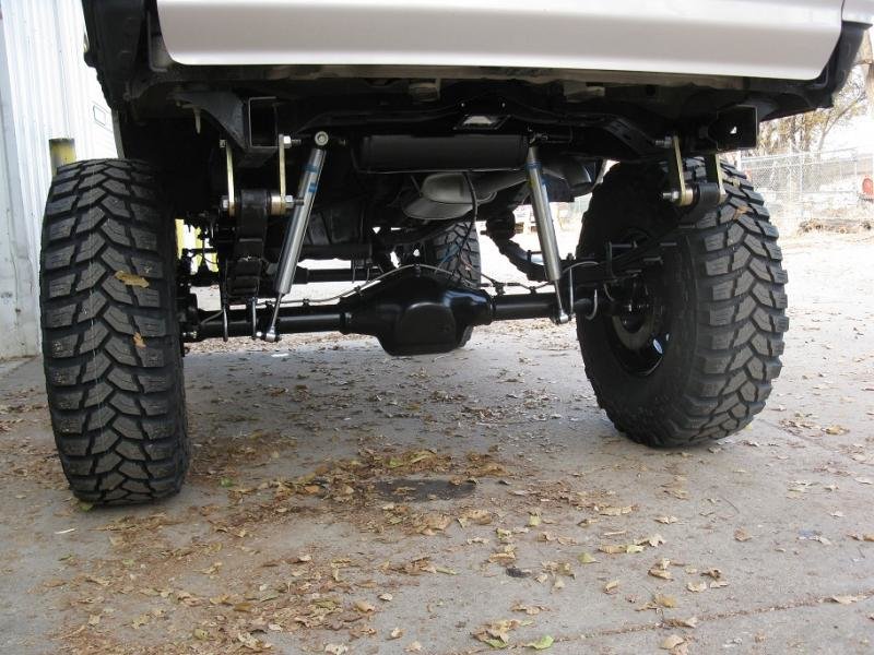

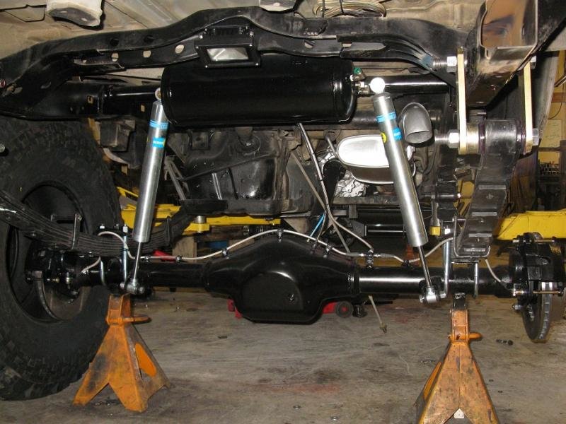

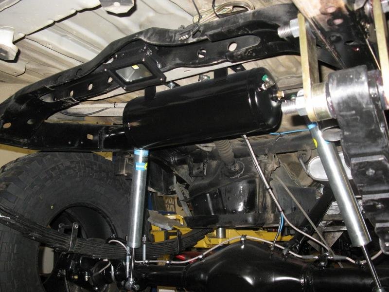

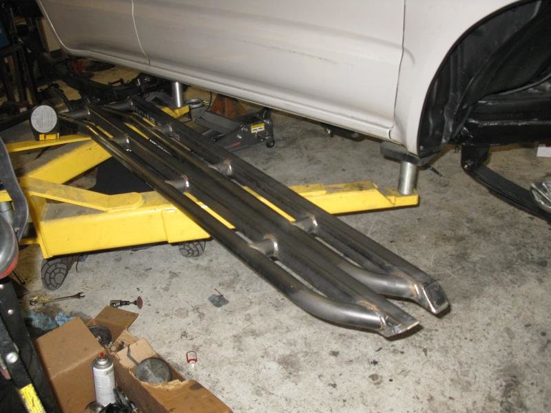

    Getting really close. Duals are in. Just need to cut holes for shifters.
    Rear axle is in place and disc brake kit is on. We set the pinion angle today and will be dropping off drive shafts later today. Wheels are supposed to ship this week too. Hopefully it will be moving soon.
    704619d1351628346-addicteds-96-4runner-u_3ee2fd8972f4fd80369473f0a2246e93c076badb.jpg
    704620d1351628346-addicteds-96-4runner-u_4d1df173c9e4c8b8d59b3c89b79b10351d734cd6.jpg
    704621d1351628346-addicteds-96-4runner-u_7fbb7481e9c4174a88fb7d9431ed87a7a64cb2c6.jpg
    704622d1351628346-addicteds-96-4runner-u_2bc9644c0981f17b1c06f08dd24203098695caed.jpg
    Sliders are built now too.
    704623d1351628346-addicteds-96-4runner-u_2b4b3071e1445740048161d2a71cd63d1c830c9b.jpg

    Damn clean work! Any hesitation on using the Rock Assault housings on a daily driver? I thought trail-gear admitted questionable pinion lubrication at highway speeds?
  8. Oct 30, 2012 at 2:05 PM
    #28
    AddictedOffroad
    AddictedOffroad [OP] Well-Known Member
    Jan 29, 2011
    #50143
    316
    Windsor, CO
    2000 4runner. Linked and locked
    The 3rd member alone dictates pinion lubrication. The housing itself will have zero to do with that, so I am not sure where you heard it or whether the person who said it was talking out of their ass, but that is not true.
    It used to be that TG never had a baffle to cover up their breather port. Because of this, the ring gear would sling oil out of the breather. That was the case on the original versions of these axles. These newer ones are MUCH better quality than the older version and are now baffled. They have stepped up a lot compared to early versions.

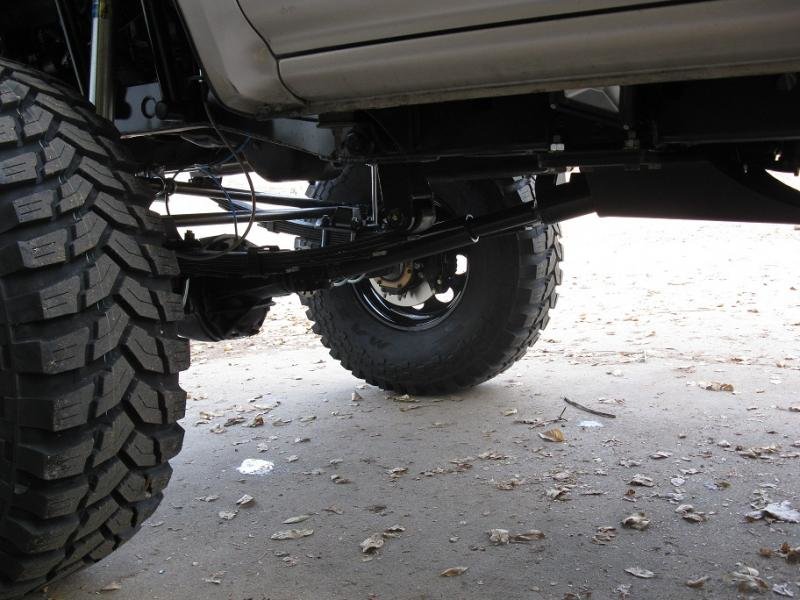

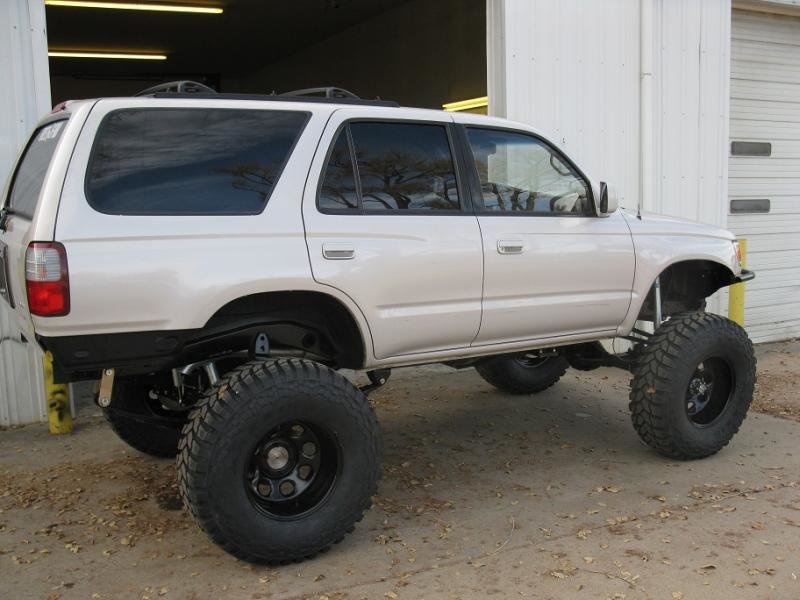

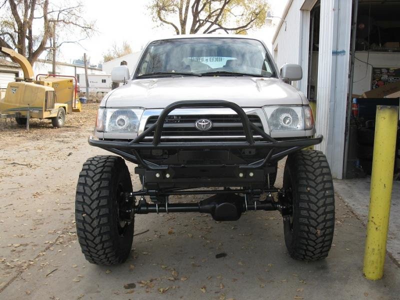

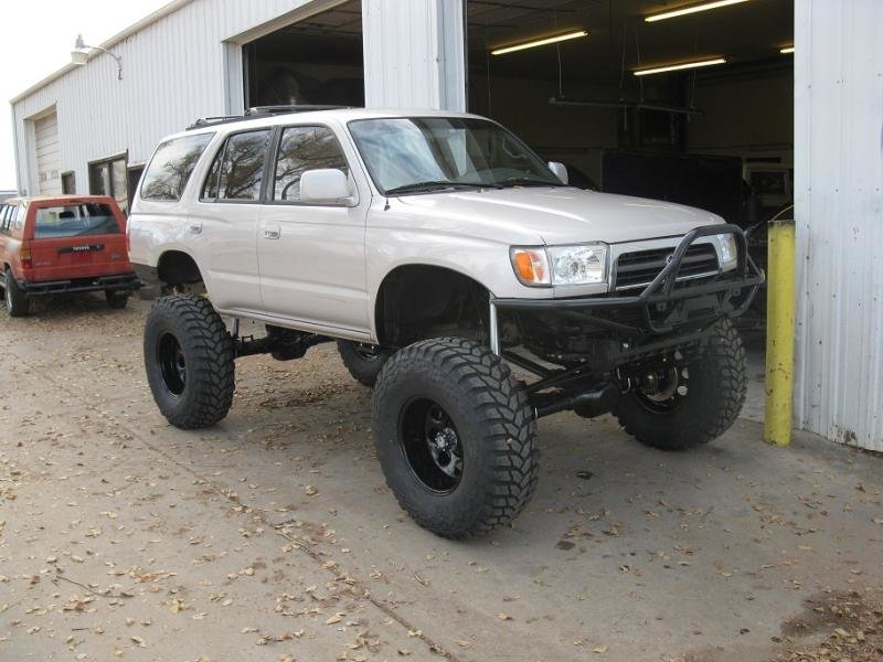

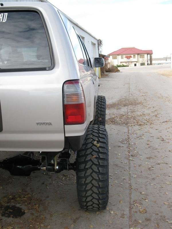

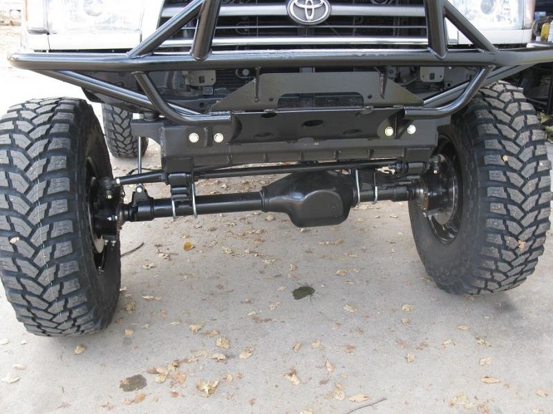

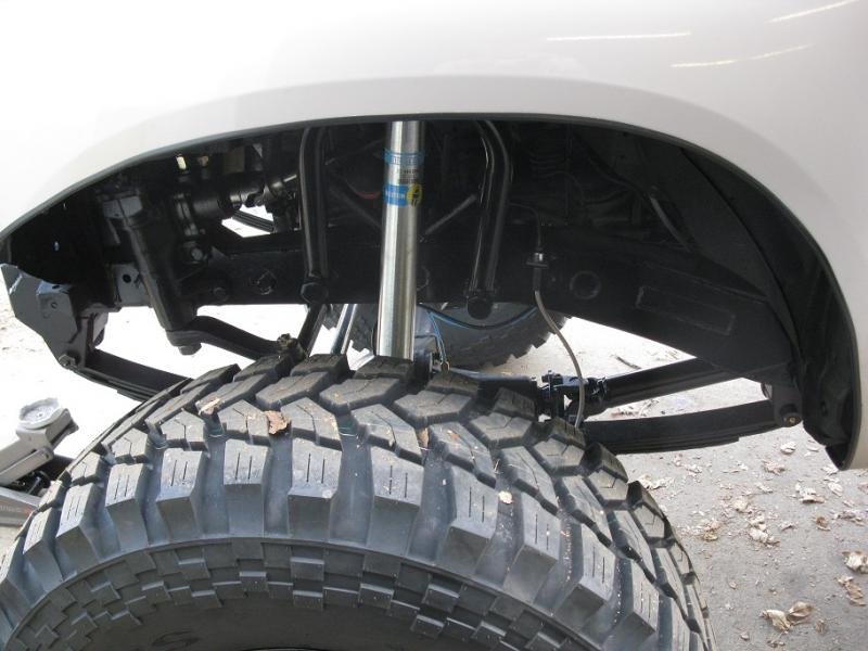

    Well, she is driving. Wheels showed up yesterday and its out of the shop. We just need to finish up a few little things. FWIW, this thing is tall. Frame height at 28.25" when it left. Hoping that will settle at least 2" over the next couple weeks.
    Next is sliders and a rear bumper.
