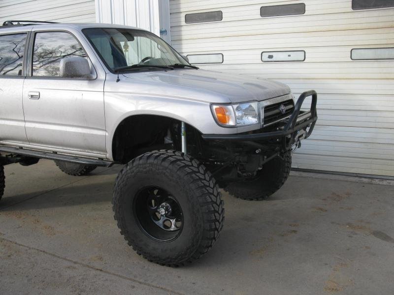

    Rear shocks look like they are going to bottom out over a speed bump.... Wicked rig though
  2. Nov 7, 2012 at 1:58 PM
    #42
    AddictedOffroad
    AddictedOffroad [OP] Well-Known Member
    Jan 29, 2011
    #50143
    316
    Windsor, CO
    2000 4runner. Linked and locked
    They have 3.5" of uptravel now, but I made the same comment that when it settle we need to swap in some shorter shocks.

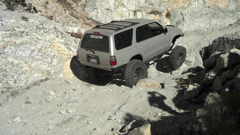

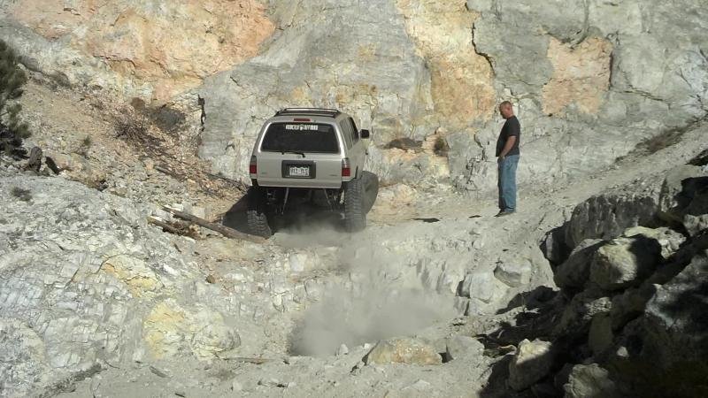

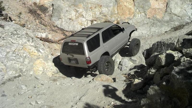

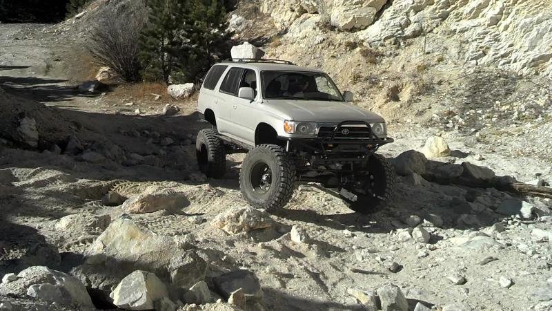

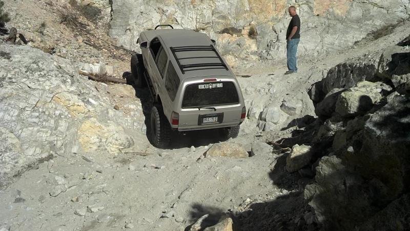

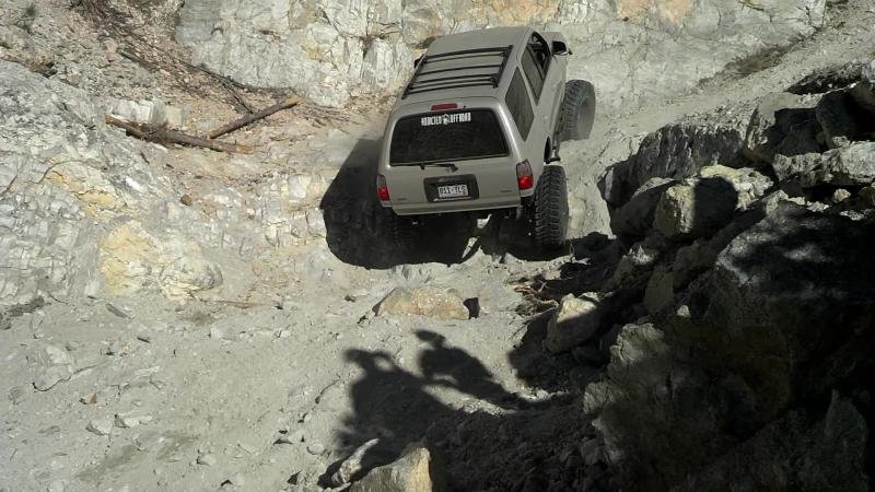

    Glade, myself, and Brian took the 4runner up to Moody Hill and the quarry to play around.

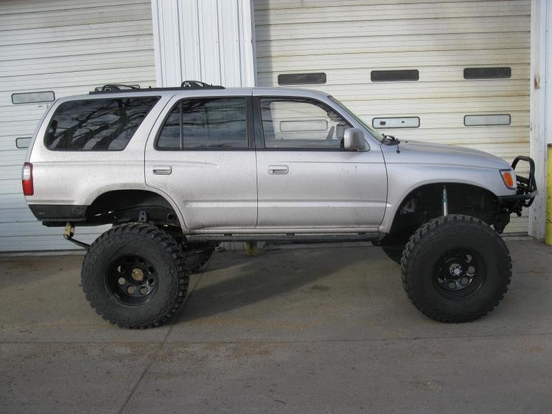

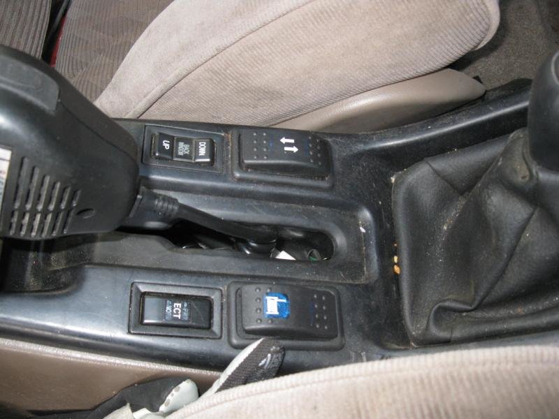

    Got some pics of how its currently sitting. We pulled the 3rd leaf down in the "HD" pack. As you can see, its front low right now, but we should have the new tire carrier/rear bumper done soon on it where it should level it out a lot better.
    It definitely looks way ass high in the rear because there is no bumper.

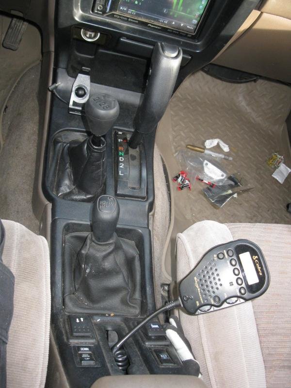

    Also took some center console pics. Along with his winch controls.

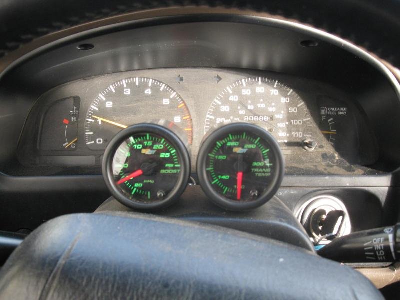

    Here are his gauges. Notice the one on the left

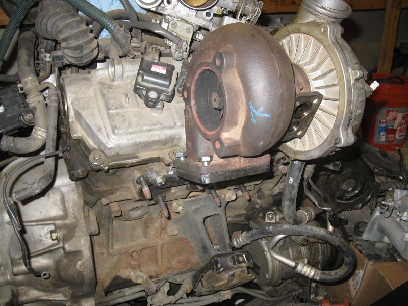

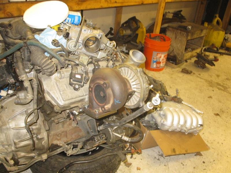

    Here are some sneak peaks. Glade just sent out the Exhaust manifolds and intake to laser to have the flanges built.
    Turbo manifold will be a T4 manifold. That is a Garret TP-38 from a 96' Powerstroke. Not sure if that turbo will work well or not, but we're using it for mockup for now. It would be better suited to the 1UZ in the buggy, but we'll try it on the 3.4L to see.

  15. Jan 30, 2013 at 9:33 AM
    #55
    45acp
    45acp Paint me back in Wyoming again...
    Aug 9, 2009
    #20861
    6,705
    Jonathan
    Boring, Wisconsin
    1981 Long bed 4x4
    Awesome setup for the CB and winch controls

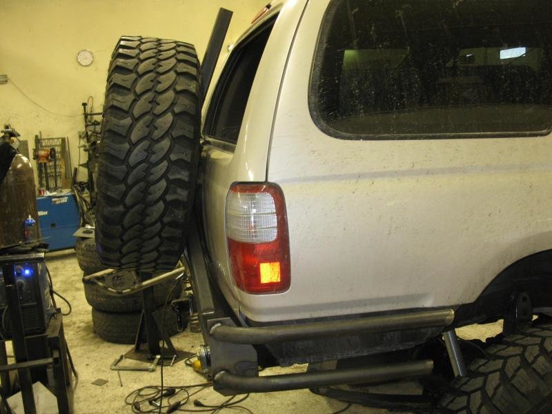

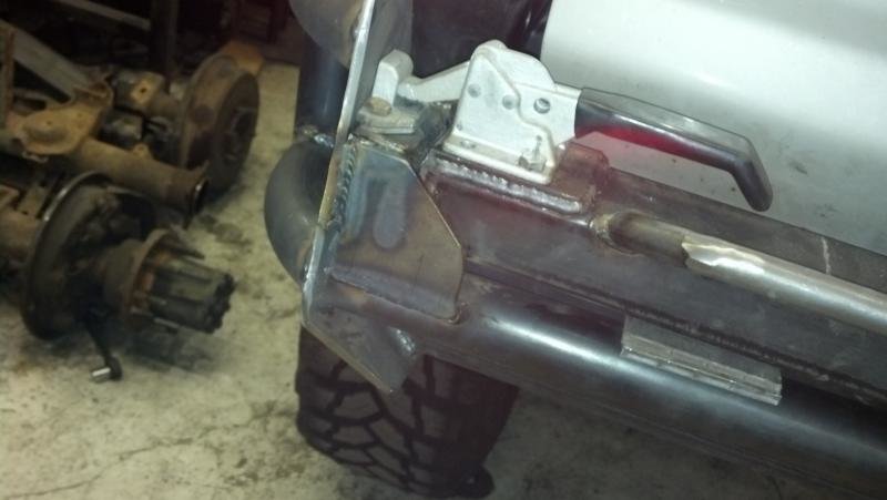

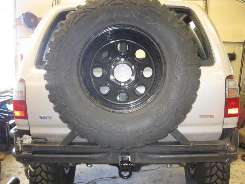

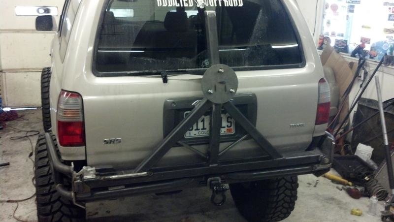

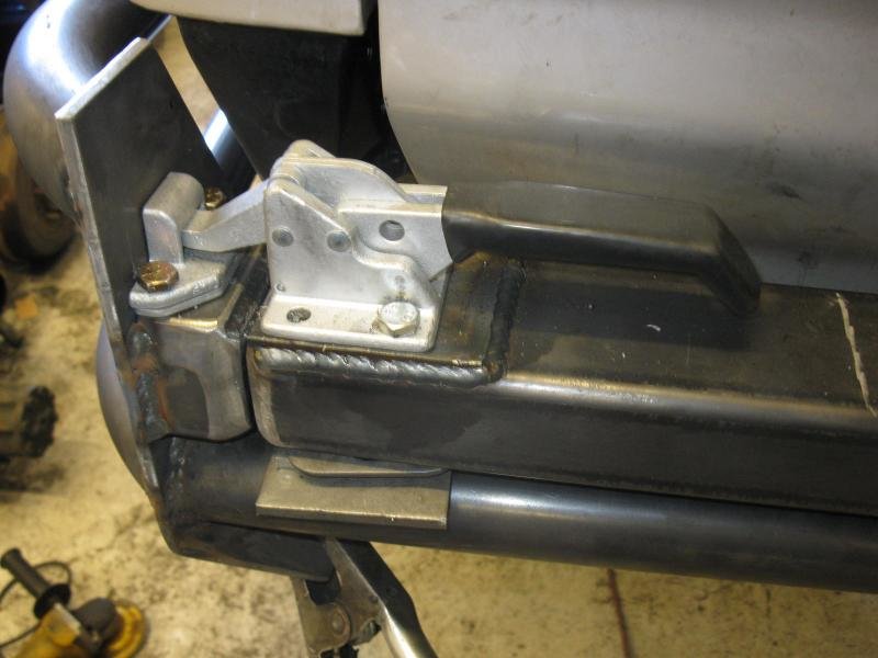

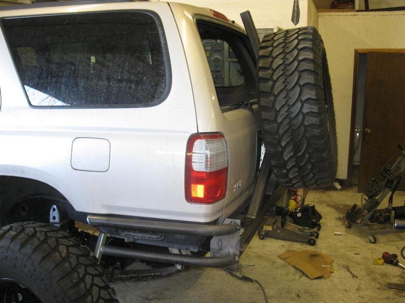

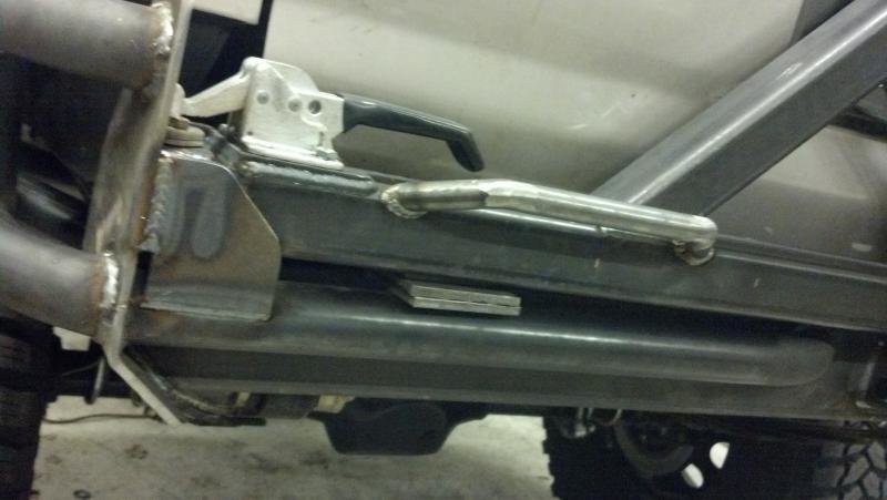

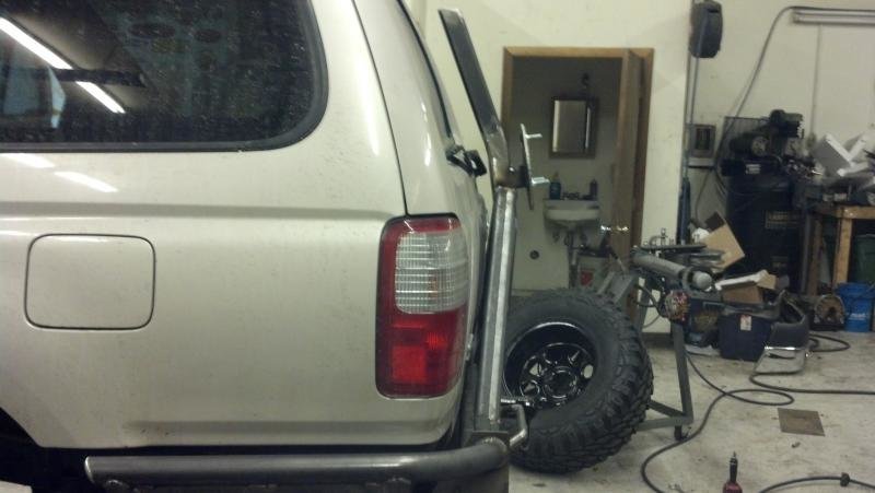

    Went in today to work on the buggy, but forgot the stuff I needed. Glade was in there working on his rear bumper/Tire carrier, so I said screw it and helped him knock out most of it. I had to leave at 3pm today, but he is still going after it. Its close.
    Best part is that with the tire on it the frame height in the rear dropped 1.5". Its at 26-1/4". Front after pulling the "HD" leaf is at 25.5". I bet it sits level when were done with it at 25" overall.
    IMHO, the ride height is about perfect now considering its on leaf springs. Especially considering this thing start just under 29" frame height.
    For the record. This is NOT a production carrier. They can only be built in-house on the vehicle itself. And, yes, its another "lambo" style tire carrier.

  17. Feb 3, 2013 at 7:50 AM
    #57
    alove0750
    alove0750 Well-Known Member
    Mar 30, 2010
    #34294
    1,398
    Adam
    Concord, NC
    2015 DCSB 4x4
    Icon coilovers, shocks and springs SPC Upper Control Arms SCS Ray 10’s w/ 265/70R17 BFG KO2’s Leer 100XR shell
    I love this build!
    The tire carrier setup is coming along nicely.

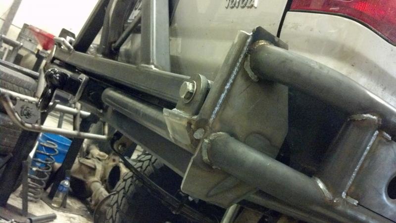

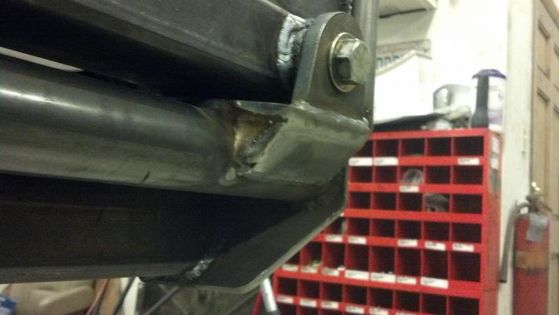

    Cell pics he just sent me.

  19. Feb 3, 2013 at 5:05 PM
    #59
    sk8rjess
    sk8rjess IG: @whoishack
    Jul 5, 2009
    #19286
    2,303
    Cody
    Nashville, TN
    02 4x4 sr5
    some duct tape and zip ties
    it looks like an extremely tight fit between the hatch and the carrier. do you think on flex or if you smack the bumper down on a rock that the two will hit?
  20. Feb 4, 2013 at 1:19 PM
    #60
    AddictedOffroad
    Jan 29, 2011
    #50143
    316
    Windsor, CO
    It shouldn't deflect that much. Especially, with the way its welded on.
    Scotty
