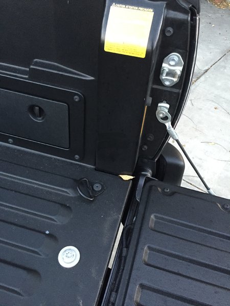

    I noticed in my bed a yellow sticker that warns the owner they need to disconnect the wire feed into the tailgate for the rear backup camera before removing the tailgate. First time I actually read the sticker (figured it was just some gibberish about the bed or whatever). Then I noticed the wire going into the tailgate... My truck doesn't have the actual camera. Would it be difficult to add a Toyota camera and get it working with the head unit? Plug n' play or more to it?
    You can see the sticker and the wire feed into the bottom of the tailgate.

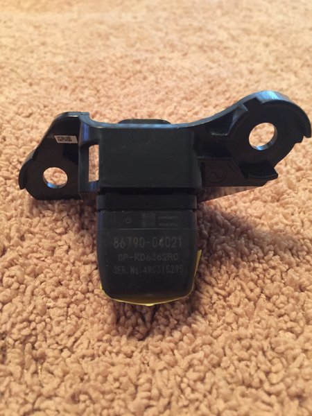

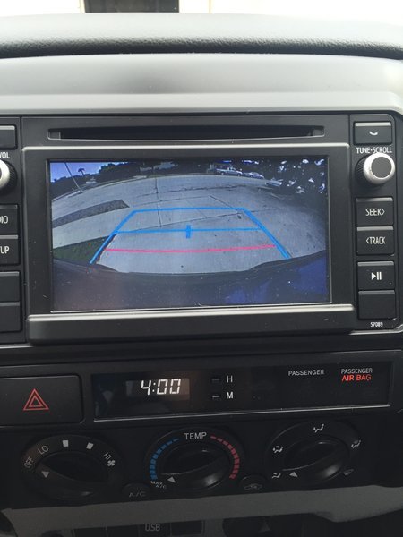

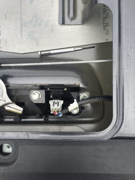

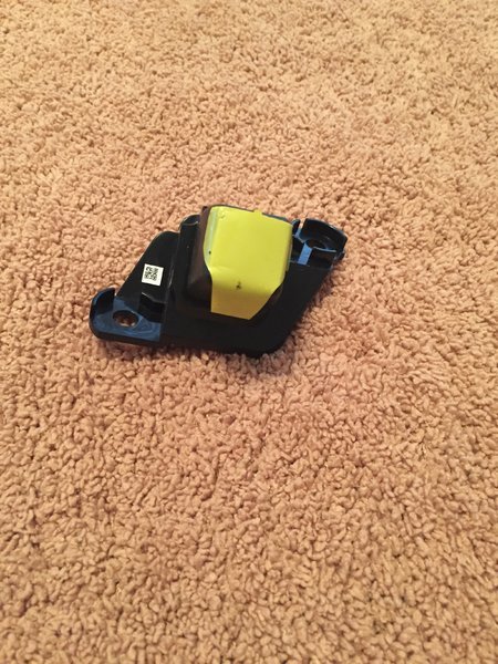

    Got my backup camera today! Highly recommend http://myworld.ebay.com/longriauto for these. It was cheap, $115 shipped and it seems to be a genuine Toyota part (I think the part number matches). Install was incredibly easy. No wiring, just unbolt the tailgate cover, take out the camera decoy, install new camera (just plug in existing wiring plug), put tailgate cover back on and bam, camera is ready!
    Camera out of the box:
    Camera in:
    All buttoned up:
    YES!
