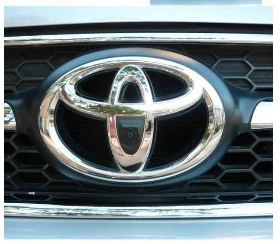

    A few posts ago some one showed a picture of the following camera in a toyota emblem.
    I purchased this and now would like to know how to mount it.
    There were no directions or brackets, clips, etc.
    Any one have any ideas.

    Glue? VHB tape?

    Super glue or some sort of epoxy?! How do you plan on wiring it up? I want mine to be activated on the navigation screen with the push of a button. Been wanting to do this for a while...

    I bought something similar, but mine came with a plastic mounting plate & nut, so that the camera juts out from the front of the emblem. Looks kinda lame & the image isn't great from there, so I'm looking to mount it somewhere else.
